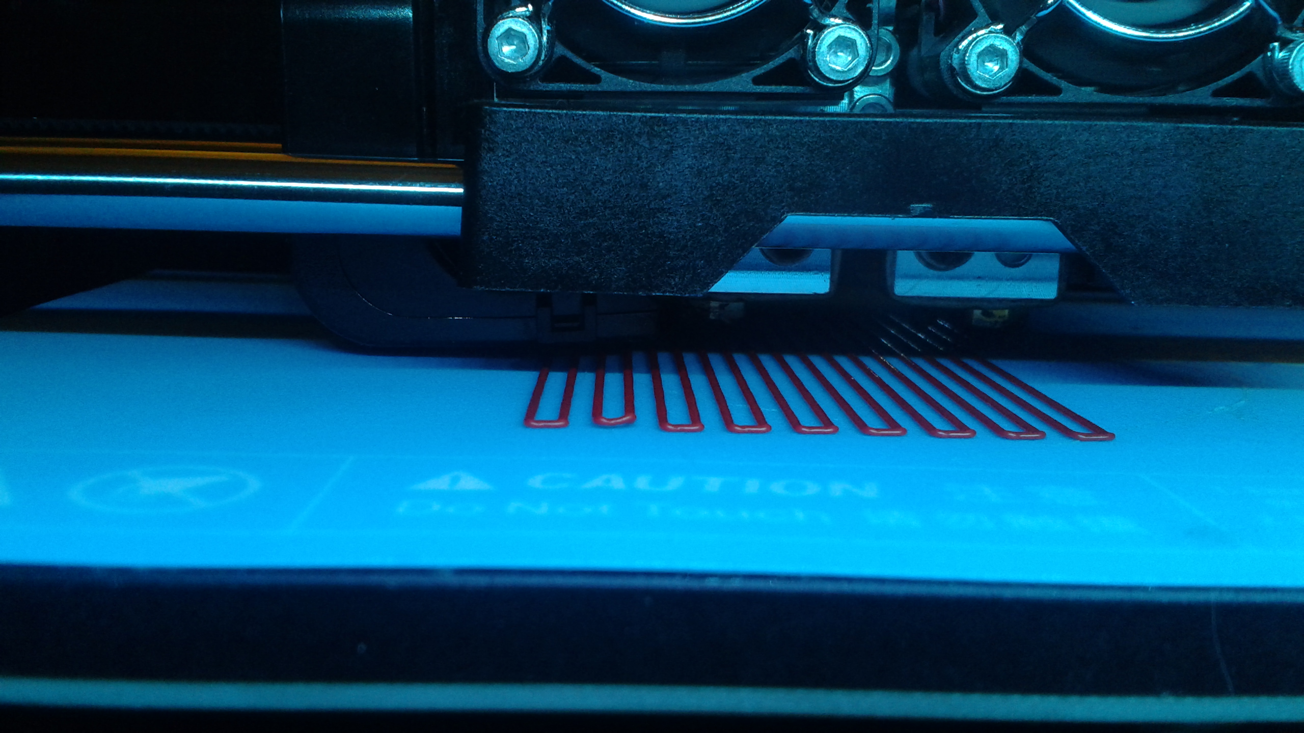

Hello everyone. I’m relatively new to both this forum and 3D printing in general so forgive me if I say a few things that should be common knowledge. I got my printer about two weeks ago and I have to say I’m impressed overall. There have been a few kinks I’ve been able to iron out but there are also a few problems that I’m having that no matter what I’ve tried I can’t get passed and hopefully reaching out here can get me some answers.
First things first, I can not print anything that isn’t generated through ReplicatorG. I’ve tried everything from FlashPrint to even getting Simplify3D. Flashprint x3gs don’t ever stick to the plate and I can’t even get a proper configuration going in Simplify. Why is this? I have Silverfish 7.8 on the printer and everything looks like it should work in the settings which I haven’t touched other than laer height.
Secondly, whenever I’m leveling the build plate I always have the outside edges perfect (or at least I think they are) but when I move the head to the middle of the plate it is very snug on the plate. I can never get a configuration where the edges and middle of the plate tug the paper I use to level at an even rate. Is this a printer issue and if so how do I fix it? Perhaps I’m just unaware on how to properly level the bed in general?
Finally, there is an issue I experience a lot where the left corner of the print starts to lift. I have some images here to hopefully show what I mean. This is ABS.
As you can see from those images the corner just… Lifts. I can’t figure out why. It’s not extremely evident in the picture do to the lighting but there is a sort of different look to the area where it lifted. That’s probably because it wasn’t touching for as long as the other pieces were though.
Anyway, sorry if these questions are bad ones. I’ve looked around for a while and can’t find an answer. Perhaps the issues are related? Hopefully someone with knowledge on this can chime in.
Thanks a bunch for reading.
Is there any possibility of you starting fault finding using a simpler plastic such as pla?
To me it it sounds like the bed is uneven but printing a bit closer and using a raft usually helps with this.
Warping that you’re getting looks like a combination of first layer bonding issues and incorrect print settings. If you can only use abs, I’d try with 115degrees bed temp and 225 hot end temp, but during it printing the raft I’d make small adjustments to the bed height to make the filament squash into the bed.
The other issue with those beds is if you’ve tried to clean it, they easily get ruined in my experience. I once used a silicone spray a few metres away from the printer and nothing would stick again until I changed the bed.
if you can try pla, adjust to a smaller bed to extruder gap, hot end at 195 for the standard flash forge pla, bed at 45 using a raft and see how that comes out. If you post back the results it might be easier to help you with abs then too.

It’s impossible to get the bed perfect on makerbot style printer. If you level to edges typically the extruder will touch in center. I believe there must be a slightl bow in guide rails on all flash forge creators and other similar printers. So best practice level the plate using your build area. Don’t level to outer extremes of plate. What I do. I print a skirt about 25mm away from part with 2 to 5 layers wide. When this is printing you adjust bed in 1/4 turn inc. Adjusting height. To get the print to stick. Adjust bed until filament struggles to come out cause it’s to close. Then adjust until filament just barely comes out. This will really presses the filament into bed. Also you can design a rectangle roughly 5 x 8 and print to see if extrusion is consistent around entire bed Been using simply 3d for a while never had any issues. I print a lot at .25mm height and run at 40 or 50 for nice resut. I use a .004 feeler gauge as paper thickness varies. Also let your tip preheat for a while and drain or remove filament before checking gap with paper as tip must be clean to check gap. Tip. Get a glass bed once you get your prints to stick it’s nice to remove them on a table outside the printer.
My FF C Pro is getting long in tooth now but I would strongly suggest a glass plate for bed. I have 3 of them. If you can get the thicker glass plates not window glass. Use glue stick to help with ABS. I print with bed at 100 deg. Make sure you have printer fully inclosed (Top cover) this will keep the interior more constant.
If you still have edges and middle differences after installing glass, your rails may be bent. The best you can do then is print on raft and allow the raft to level out the print surface.
To release print, remove the print on glass and place in freezer, in 10 - 15 minutes the print will pop off :slight_smile:

Welcome to 3dhubs Chris_Prestol. Do you have the 2016 or older 2014 creator pro? Garth said it well. In my case case to help with bed adhesion, here’s what I did to my printers:
  1. glass bed upgrade: download and print these parts from thingiverse in ABS if you can. FlashForge Creator Pro 8x10 glass brackets by 1BigE - Thingiverse
  2. get a 1/8" or thicker piece of tempered glass (to withstand higher bed temps) cut to 8x10" from lowes or homedepot.
  3. level your build plate again while the glass is mounted on it and with the extruder and heat bed preheated to operating temps.
  4. Apply a thin layer of either one of these glues onto your glass (wash, dry glass plate and reapply before each print).
  5. make sure the top and front covers are closed
  6. move the printer away from windows or cold areas
  7. print the first 2 layers slower.
Hopefully this helps with your adhesion issues.
good luck.
