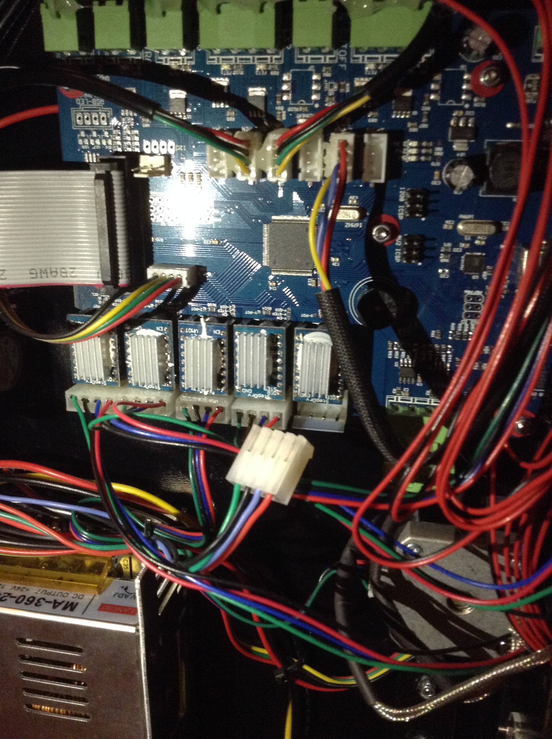

Hi first of all I love these machines , absolutely brilliant , my problem is juddering of the motor on my y axis I thought the cable was dodgy , so I had idea to use the cable on my left extruder , this cable doesn’t work either , I checked the motors on other parts of the machine and the cable and everything works until I plug it into that connection on the board , I’m pretty sure it’s the connector on board ( I’ve enclosed a photo ) , do I need to change the whole board or can I replace that socket , any help would be appreciated , everytime I’ve asked on here someone smarter than me has the answer lol , please help Thankyou

Sorry here is the image , where the connector is disconnected
I don’t see anything obviously wrong with the connector. I would suspect the cable or stepper driver first. A connector is really an all or nothing deal.

Have you tryed a new motor driver. You could try swopping the left with the right driver and see if that corrects the problem

Hi that sounds better than changing the board lol , I don’t really know how I go about changing a driver ,honestly this is first I’ve heard of it , is it easy enough , could you instruct me please , Thankyou

The driver is the little part right in front of where the cable plugs into the board - see your cable pic for reference.

Hi thanks for your help , today a new motor cable arrived , I changed the driver with the driver from the left extruder motor , don’t know if that was correct , then changed limit switch on X axis and motor cable that drives the X axis , started it up and it was beautiful lol , sounds like brand new , smooth , then it approached the front left corner of the axis and juddered again for few seconds , this is back to how it was when I first noticed the problem , I think I installed wrong update , my prints were printing wrong shapes , I have now successfully installed sailfish , what else , I changed the pulley on the X axis , replaced with a 20 teeth gt2

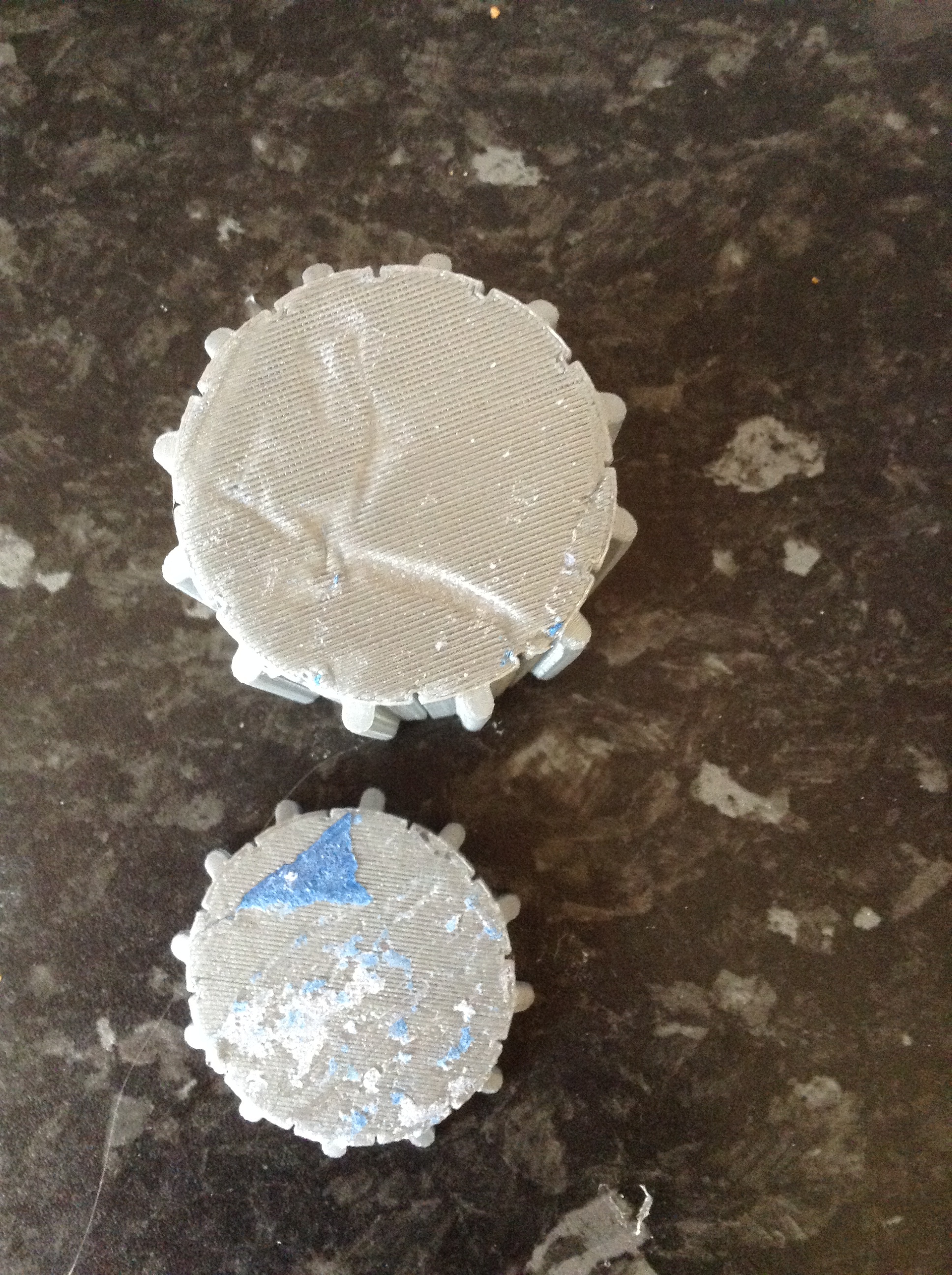

Ok so I have now changed the pulley back to a 16 teeth and now my prints are better but still smaller , I have enclosed photos , I’m going to try putting the 20 teeth back on and see then , but now my head stops short on the front left side and if cancel , it goes back to limit position and stops short there as well , no more juddering with a 16 teeth pulley on , machine is smoother , I am at a total loss now ,move fixed everything that was faulty , everything is smooth and running fine , sailfish seems to be ok , I’ve tried two diff sizes of pulley one goes to far and other too short , and my prints are about 3-5 mm smaller than they should be
