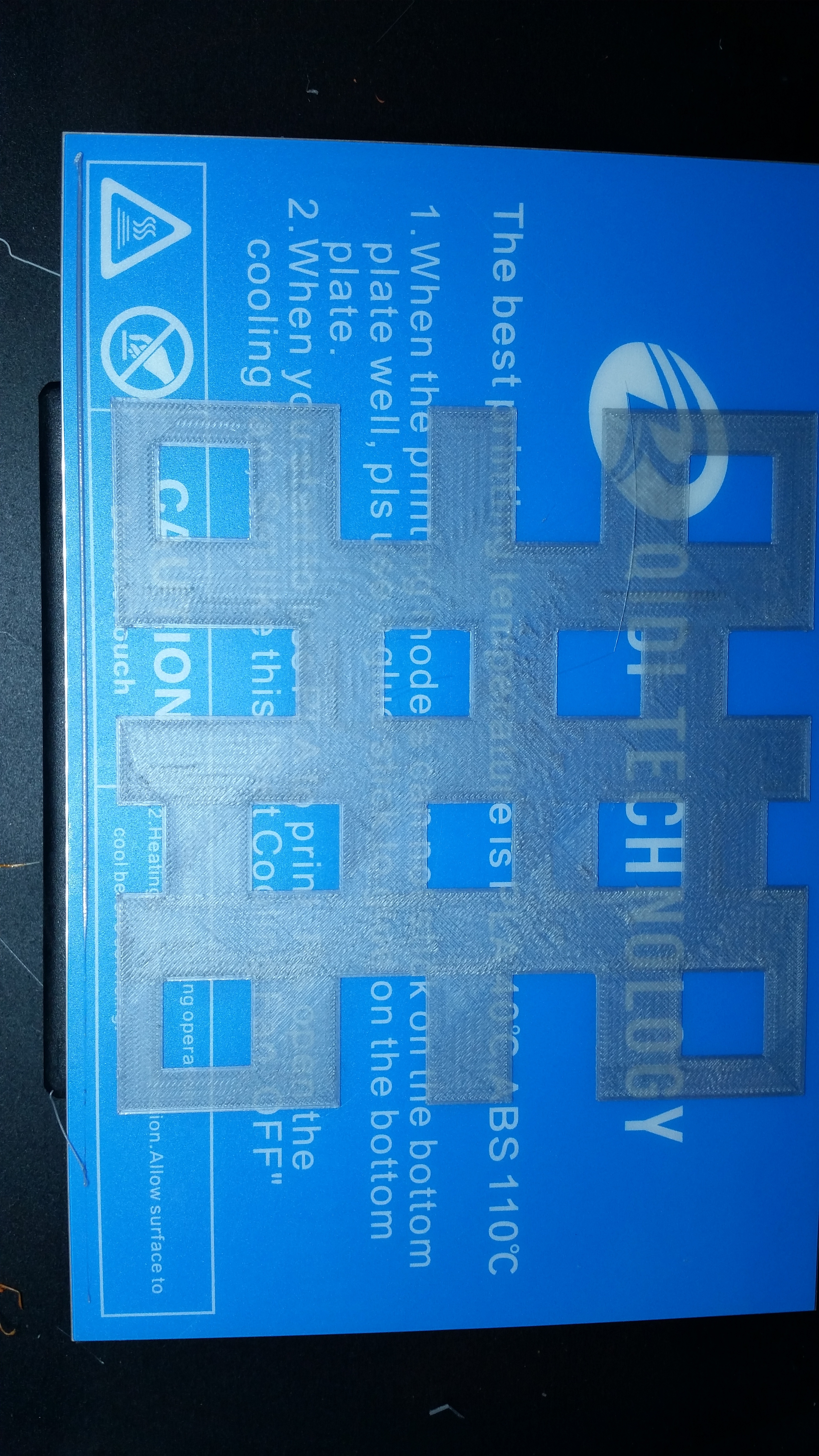

Well, I did one a leveling that seemed fairly good and ran the test from here: Build plate leveler by Woodsmoke - Thingiverse
I’ve attached a picture of the output. To me it looks imperfect (thought those got generally smoothed out by the later layers) but fairly good. I imagine if I’d had some actual adhesion issues I would have found myself with stuff being dragged around again. I tend to have more problems with flat prints than anything else.
There is one spot, directly along the first I in QIDI TECHNOLOGY where there is a raised line I’m not too thrilled about.
