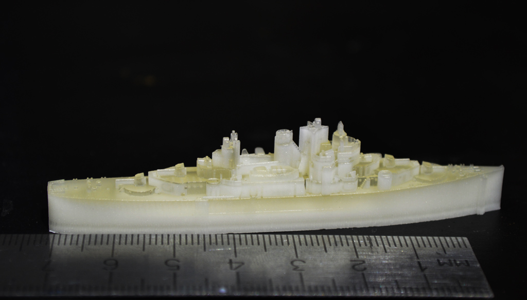

I’ve now sent out my parts to be printed on several machines to see how/who to print what parts in the future. The hard part is how to distinguish the machine from the operator in todays market because most machines still lack basic auto-calibration and feedback loops. Here are my results so far :
1. B9 (DLP) - Near perfect results! Looks like injection moulding. But very limited in print size. Not sure about long-term issues with light catalyzed material durability (see #7 below)

So going forward there is no doubt if the part is small, I’ll use the B9. Though I wonder if there is any solution to light catalyzed material enbrittelment over time, because that limits it to a short term prototyping. Eventually it will turn to dust.
For larger parts I’d like to see results like my ultimaker parts, but with soluable support so you can print things without screwing up the surface with support lines… anybody out there with such a setup? Or a larger SLA/DLP setup that prints accurately and with durable ABS-like materials?

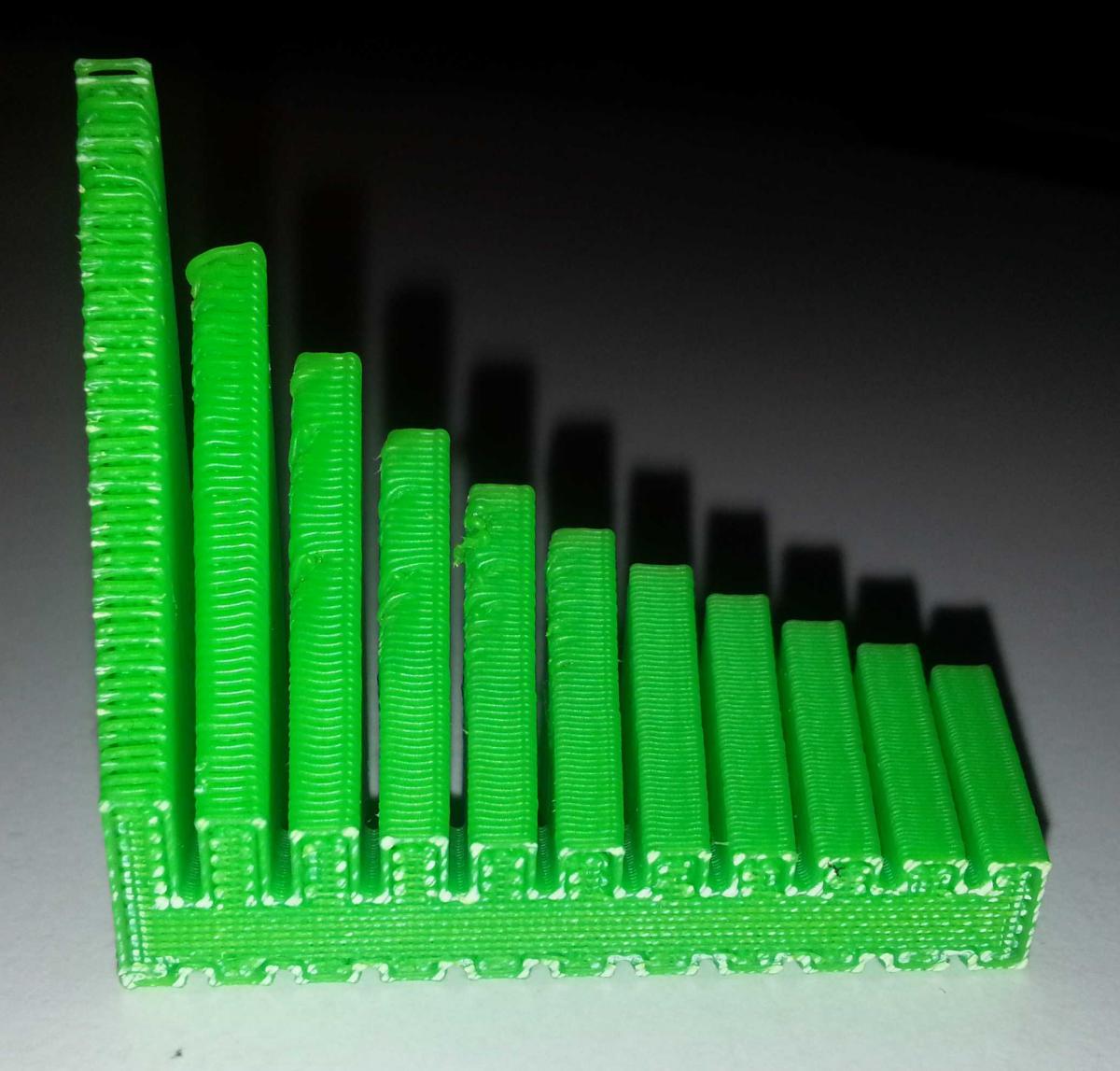

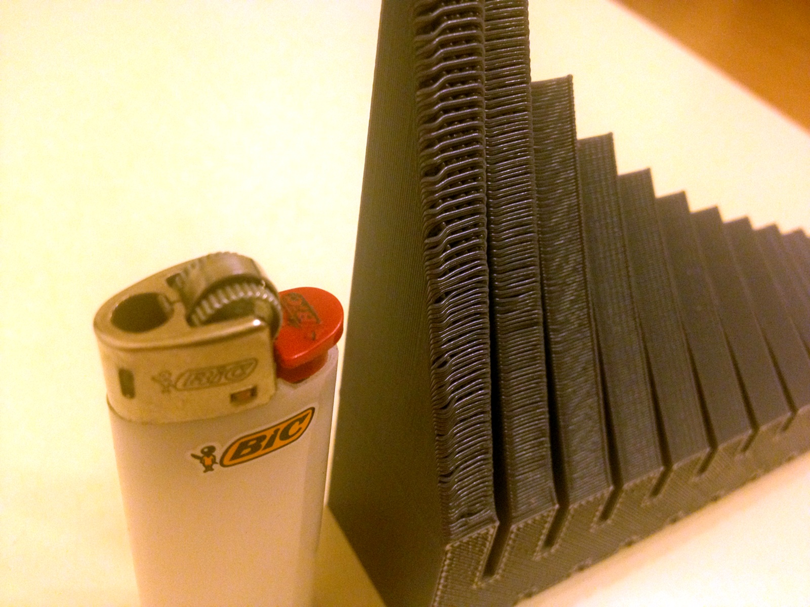

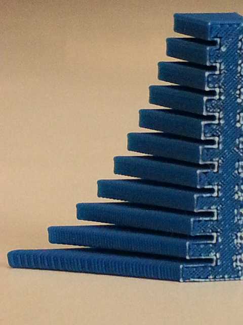

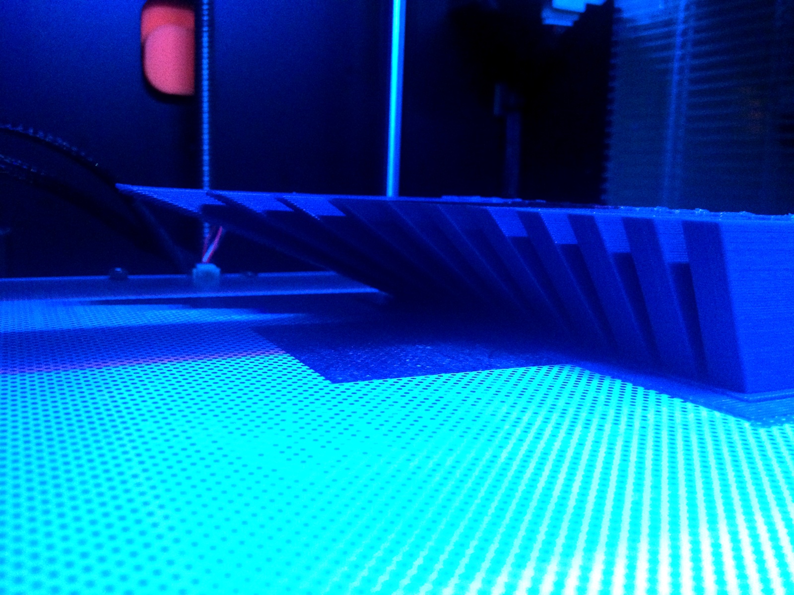

I bought my Ultimaker 2 in May 2014, hoping to have the second extruder for soluable support some mounth later. It happends that I talk with the Ultimaker staff at Maker Faire Rome last October and they told me it will be available in Aprile/May 2015 but i am not very sure of this because reading the news in the Ultimaker’s forum it seems the problem is bigger that they thought. Now, if i could turn back in time i would buy a zortrax instead.
I think zortrax deals better with overhangs than Ultimaker 2. Have you ever tryed to print the Overhang Test Print | Overhang Test Print (Customizable) by walter - Thingiverse with Ultimaker/Ultimaker 2?
This are the results with the Zortrax that i found in the zortrax forum:
