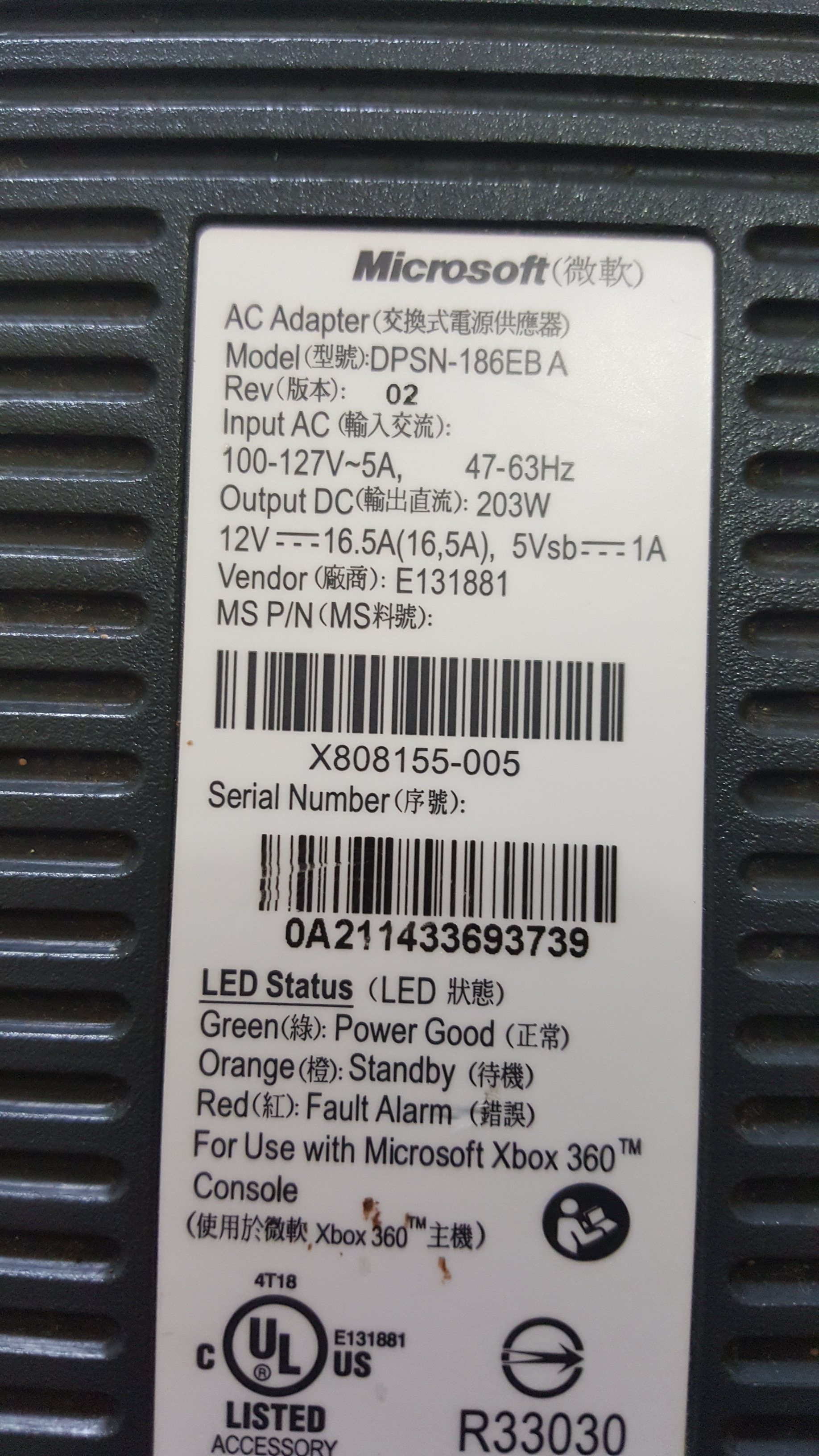

I have a xbox 360 power supply, but it says its a 12v 15amp and the printer is 12v 10amp…should i still use it for the printer? Thanks
Probably would be ok. If those specs are what I am assuming then it is telling you the output is 12V and up to 15 Amps. Probably good to check with others also to feel safe about it.
Sorry, its 16.5A
