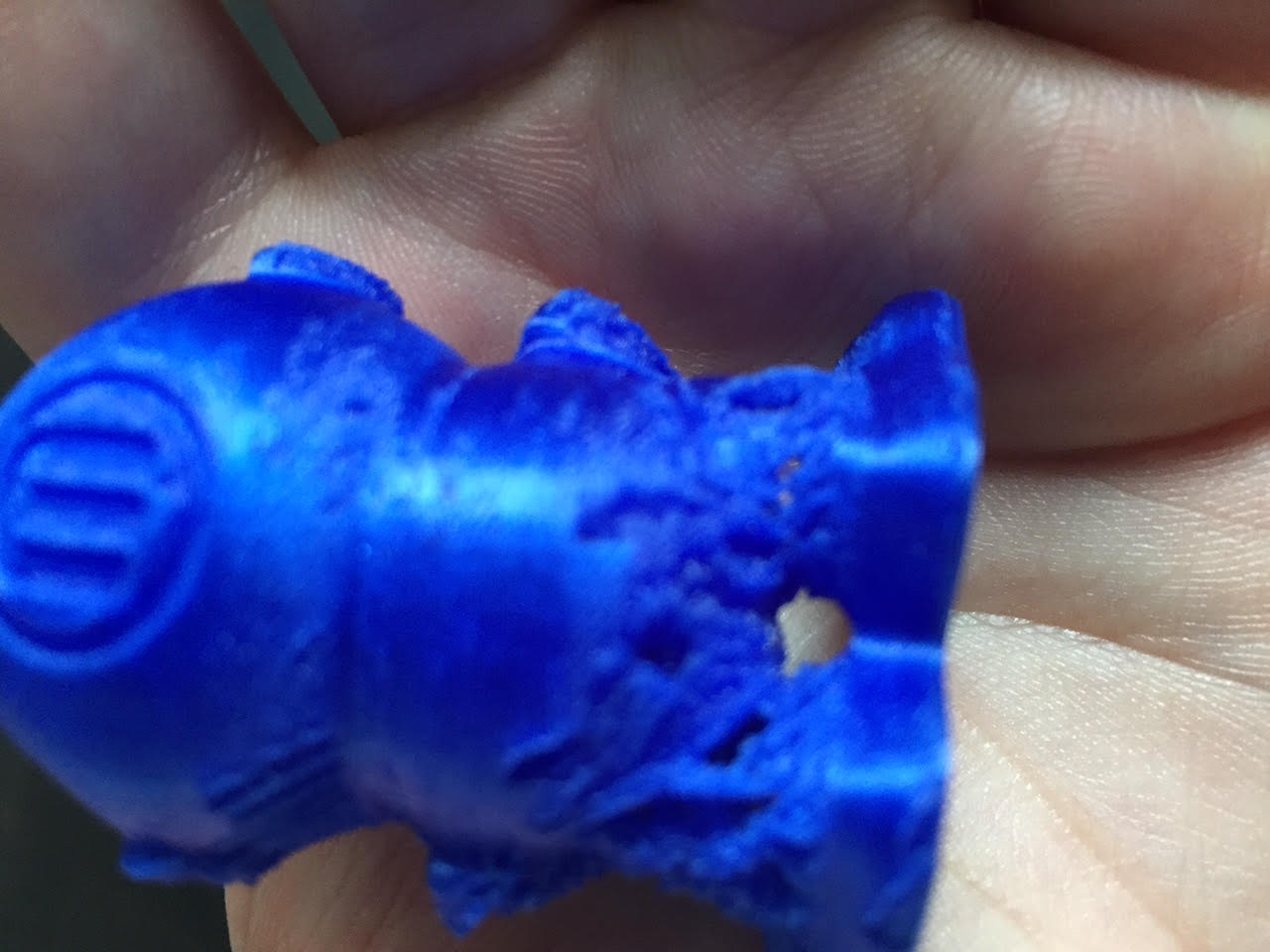

Hi I am not sure what is causing this issue i tried with both basic and high quality with the cura settings and it only improved it slightly ?any ideas

PLA I’m guessing? Looks like cooling. I typically like to increase the cooling time to around 17 seconds. Also dual fans is always nice.
Hey Cameron, I guess it would help if you’d give some info on the printer you’re using and the settings so it’d be a bit easier to predoct the issue
also, which type of material is it? Something went really wrong here ^^
Looks like an extrusion problem which might be caused by:
- print speed too fast
- printhead cooling problem (is the cooler fan on the back of the printhead working)
- jammed material in the printhead
