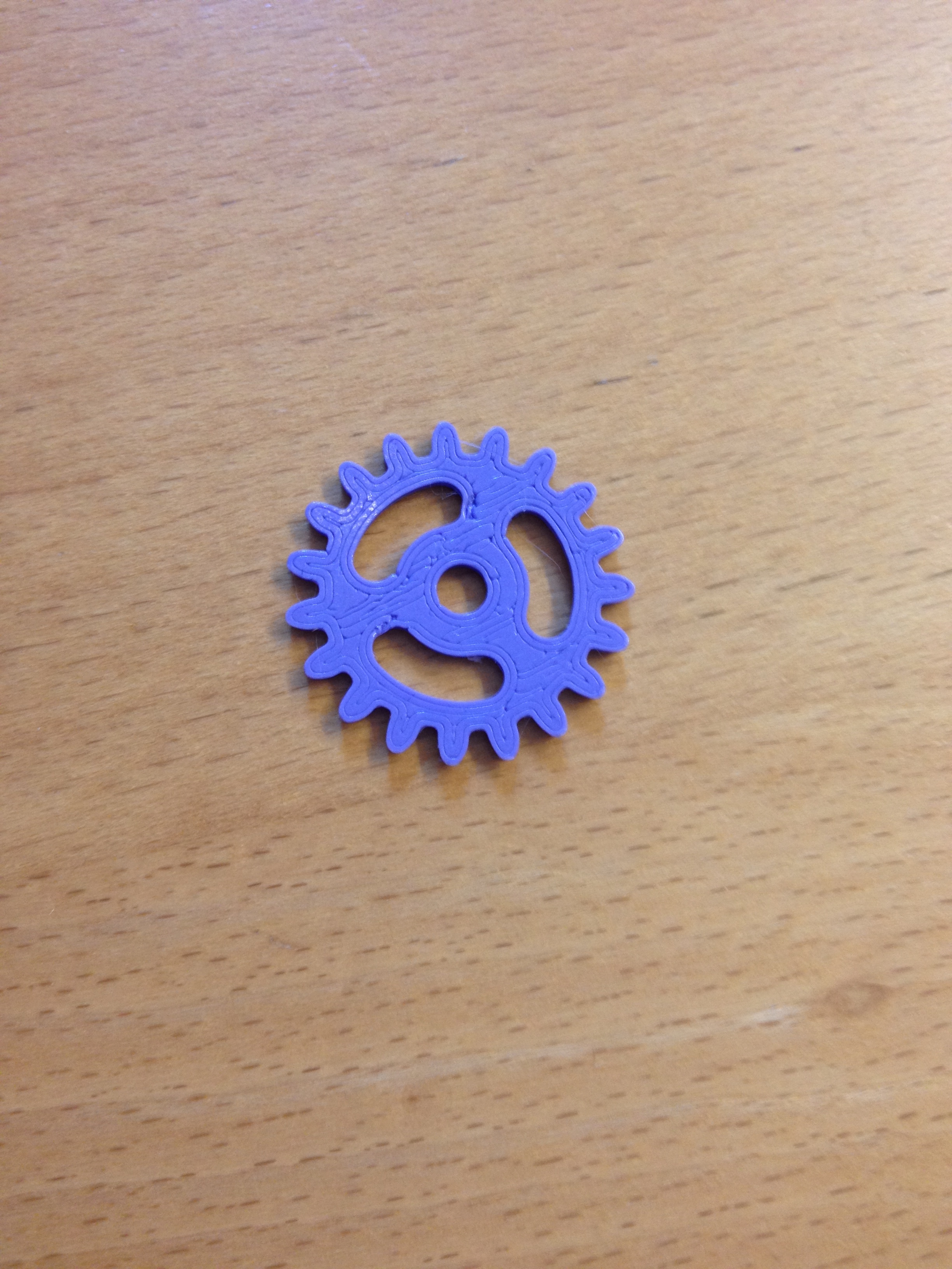

Hey guys,
When my print is done, I’m always afraid to break it while removing it from the printer.
Do you have any tips ? Here a picture of a particularly sensitive print I took a while to remove.
Thanks in advance

Hi @JulieSillam,
when you print PLA and have a heated bed you can print on glass.
When the print is finished and the object is cooled down you can just take it (or slide it) of the glass.
I clean the glass with alcohol before I start the print.
Only if you have very large/wide objects you have a risk of warping but you can prevent that by using Pritt glue only on the outter parts.
When you use pritt and can’t get the object off after cooling down (or using it on a cold bed) you can just take the whole bed and put it in some warm water. Wait for a while until the Pritt glue is solved by tge water and you can take off the part.
I hope that helps :wink: !
Kind regards, Guy

Julie,
What printer are you using?
What buildplate?
I use PLA on cold glass with diluted PVA glue (on a UM Classic) and the parts pop off loking like glass :slight_smile:
James
If you are printing on the blue painter tape, what works best for me is to just soak it in isopropanol Alcohol so that it looses the bond with the platform, after a minute or two you can peel off the excess painter tape around the object and then with very little force remove the object from the remaining tape.
For this one, it was an Ultimaker 2. I have no clue about the build plate though…

A UM2 will have a glass build plat - so i am asuming the white is glue?
If you are using it hit then let it cool down first and the print should just pop off.
I fina ascraper (with a razor blade) works well to just start the popping off process :slight_smile:

  1. Consider blue painter’s tape. It is worth the price. Your parts will stay in place but won’t get stuck.
  2. Use some tools
  3. I mainly use a japanese spatula (translation from French) - La Boutique Du Carrossier
  4. I used to use a sharper tool, but I hurt myself and did some scratch on the plastic bed of my Replicator 2
  5. For some parts, you can use a screwdriver. It offers a great lever and is quite harmless.
  6. Proceed with caution. Many 3D printers’ accidents append during the removal and finishing proces.
try dimafix; its a spray that you apply to the bed. here are the importers site for the UK http://www.kora3dprinter.com/store/dimafix-3d-adhesive-spray.html
