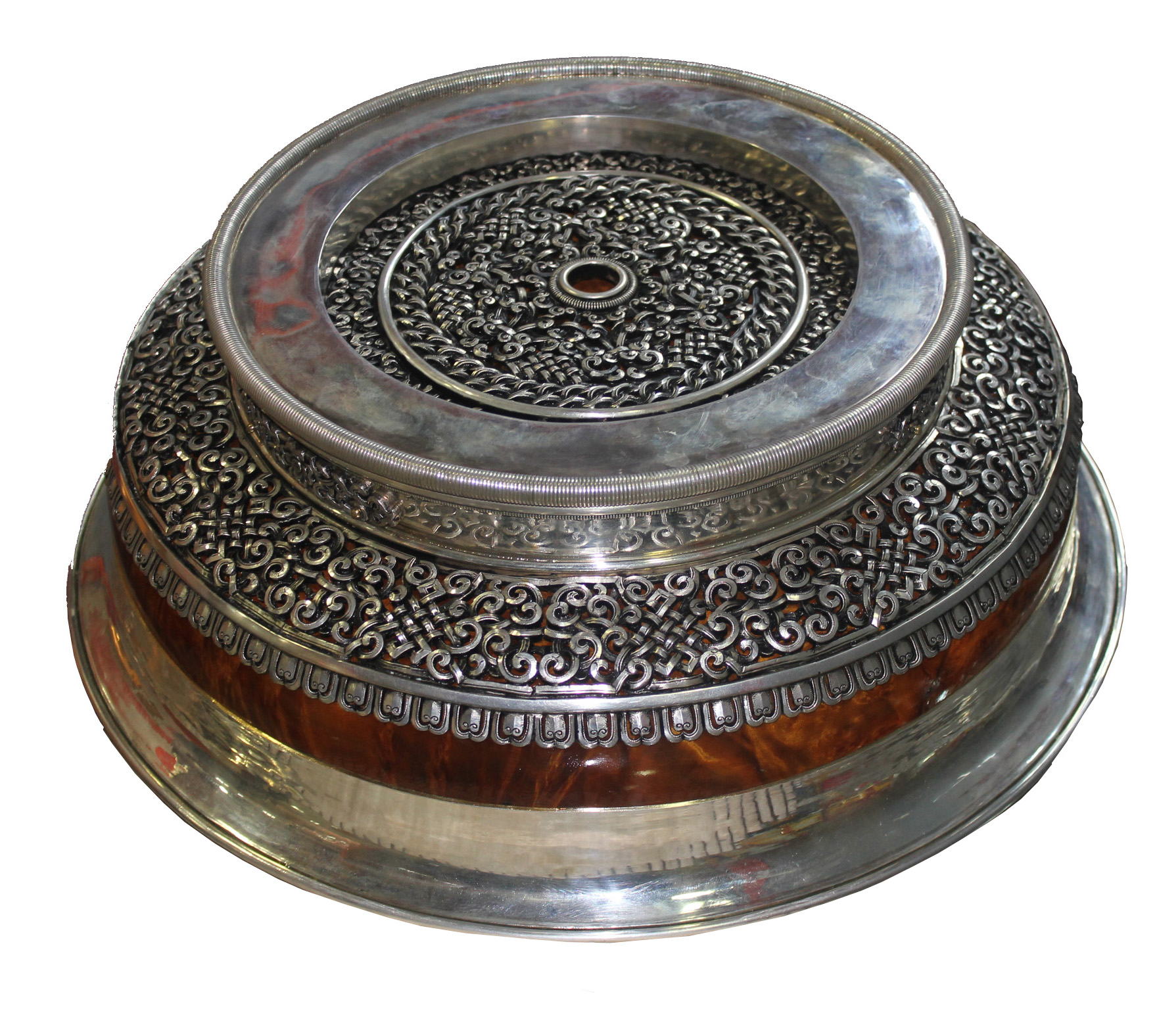

what is very high accuracy big printing area printer. i want to print silver cup like on the image
What’s the size of the silver cup?
You are a little short on details here :slight_smile:
- What do you mean with ‘big printer area’? Your picture gives us no clue at all about the size of the object.
- What do you mean by high accuracy? Do you mean very thin layers in the vertical direction (like 100 micron or less)? Or do you mean very thin horizontal lines, as in those printed with a 0.25mm nozzle?
For starters, you model shows a high amount of intricate carvings/casting details. This would be a nightmare for a typical FDM-printer because of the very small movements of the printhead coupled with an equal amount of retractions.
But a SLS-type printer would have far less troubles with that as it’s only the beam that’s moving.
15-20cm printing area and no mistake every single part like jewelry printer
15-20cm
We could do something of this size and detail on our polyjet 3D printer, but we couldn’t do the shiny silver colour. We could do grey and/or you could paint it with any acrylic-based paint.
