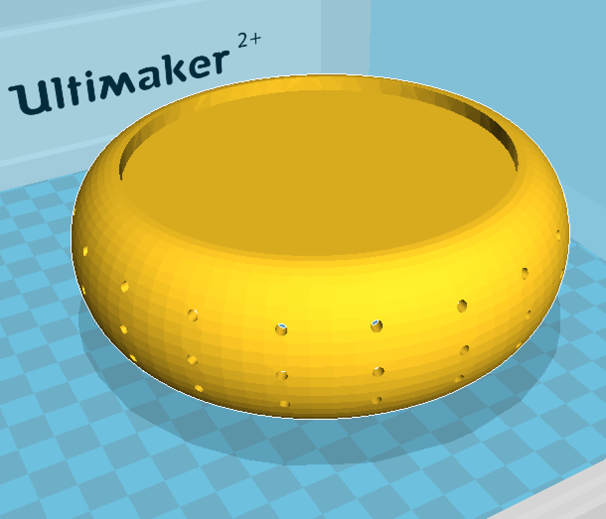

Hi, I want to print the shape as shown below. I would like some help on what would be the best approach for printing (I am using an Ultimaker 2+). I thought of cutting the shape in half, but that would require already too much supports.
Top view
Bottom view
Thanks in advance!

Hi thvanarkel,
The best way if printing this would probably to print it the way up as it is in the bottom view. This would take the least amount of filament as there are far fewer, if any, supports. If supports are needed I would recommend using a low density setting so it is easy to peal away and requires very little sanding.

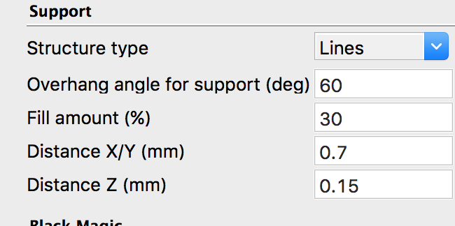

For an ultimaker:
Iâve found optimal settings to be the screenshot below

I agree with gift3d, this orientation will will require the least amount of supports. If you an change the design such that the âbottomâ instead of going up and then straight (horizontal) for the face, use a blend starting at the edge to provide a curve that may be able to reduce the needs for supports totally. The inside face can still be flat.
Hi, I would print this with the bottom down and choose support type âtouching buildplateâ, unless you are stick to this design you may decide to change the design of the object to touch the build plate without the need for support and use a low infill percentage.
With regard to the curve, i think you can do this without support, i use a UM2 and i made shapes with simular overhang (although i can not fully judge based on the screenshots, if it the same).
i think the best thing to do first is the print a smaller version (scale down) of this object to see how the overhangs are printed.

You can actually print this without support if you cut the model right at the limit of the solid bottom.
Then you would print the big part with a flat surface on the bottom, and the remaining ring alone.
No support, yay !
You can use netfabb basic to cut this, it is free.
If my explanations are not clear, send me the stl file and Iâll cut it for you.

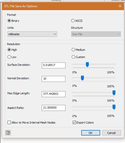

Try using a high setting when creating an stl file for a smoother finish.Use thinner layers, good quality material (no chinese rubbish) HD glas or petg is good and low warping .Fans on full hit & slow it down .You could then possibly get away from using supports. would be a gamble tho. try a scaled down version for a tea light holder first

How is the 0.15mm a good Z distance?
Do you print Z with 0.75mm layer height?
always make sure itâs related to the layer height you are printing with.
You donât need to cut the model, just add support at the bottom and it should be fine, br
