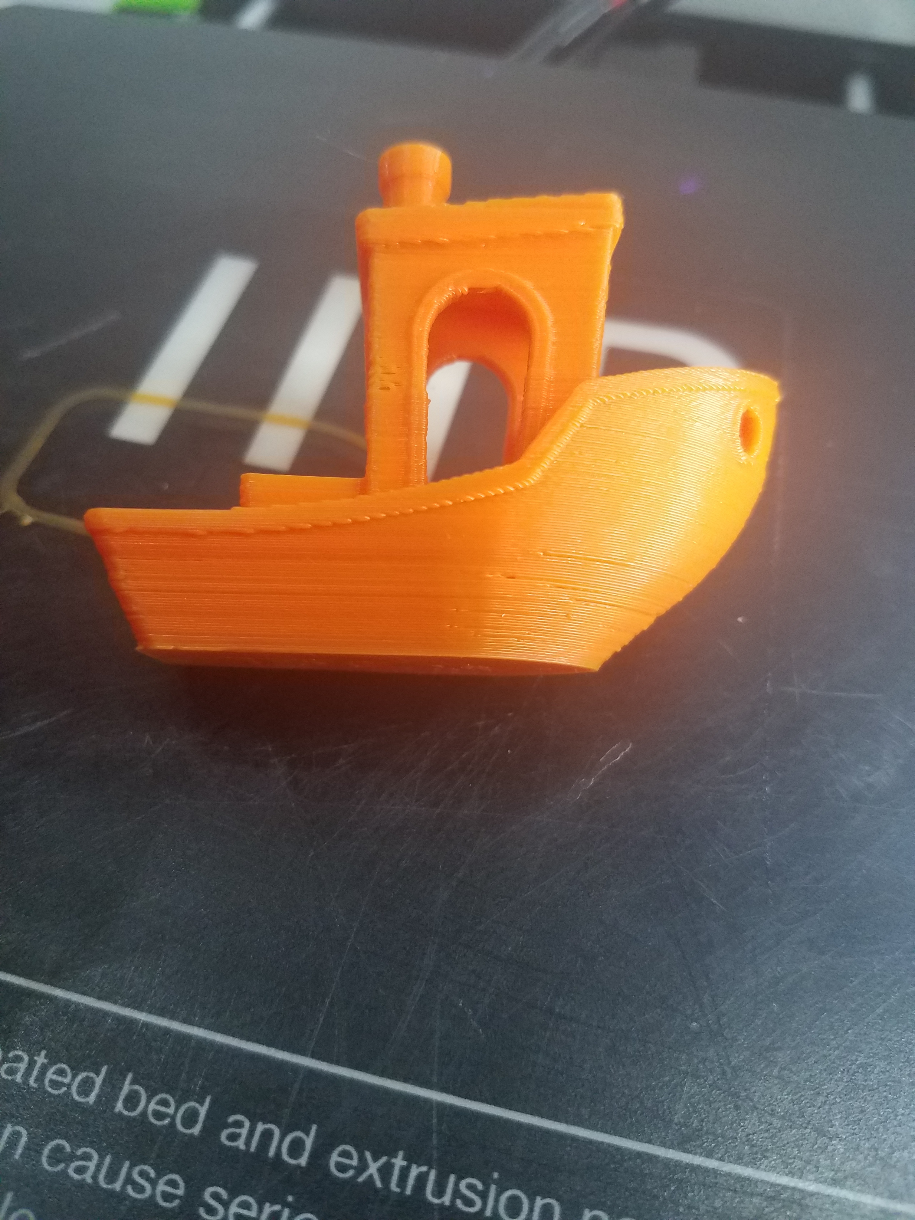

After a very short move I’ve been having issues getting good prints again. This is on a maker select v2.1 … It’s got all the usual mods. In an attempt to fix this I’ve replaced all the bearings, got the aluminum carriage and replaced nozzles and ptfe liners a few times. I also completely disassembled it to make sure nothing was askew. The only thing different at the new house is the ambient temp in the room it’s in where it was around 65 in my basement year round it’s more like 75 in its current location. Tried every combination of temp and fan settings 6 different filaments 3 different versions of cura, slic3r calibrated extruded 10 times . I’m resorting to you guys for some help here because I’m at my wits end. PLA at 200/50 (tried 180 to 215) printing at 40mm/s. 1mm retraction. There are now a lot of sections where the walls have gaps and that was never an issue before either. The little mast thing on the back was like a tiny useless nest of filament. https://i.imgur.com/va525Vj.jpg
