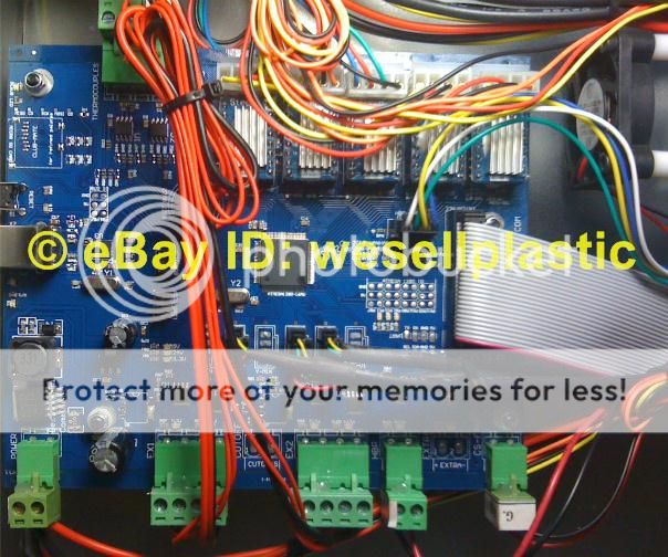

My bed has stopped heating up… Can anyone post images of what I need to check for loose connections to get it working agian.

I would check the main board and make sure everything is connected, you can access it by removing some screws on the bottom of you FF. The connectors are usually secured with a bit of glue, but they can still come loose because of vibrations and may need to be reseated. (The heated bed is labeled “HBP” it should be the third green connector on the to left side of the board.)
Before you start digging into the wiring and everything, it is worth checking that all the connectors are seated correctly.

It isn’t annotated but here is an image of the board.

The green connectors at the bottom are all labeled pretty well. Left to Right the green connectors are: Power, Extruder Head 1 (Heater and Fan), Extruder Head 2, Heated Bed (this is the one you want to check, it is half the side as the extruders) and the last one is the board fan to the far right top in the image.
