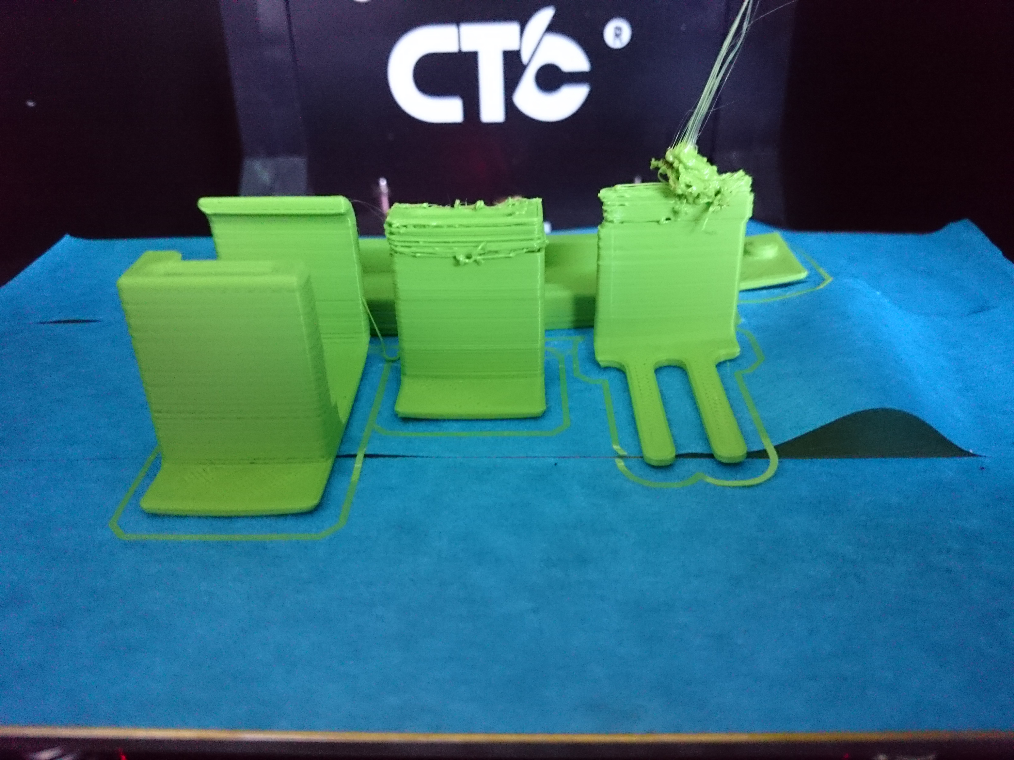

I ran a print at 230C yesterday and put the speed in Simplify 3D at 1400mm/min The print initially didn’t stick when doing the Skirt, but on the second round on the skirt it stuck and the print started well. But as you can see from the pics things didn’t turn out very well at all with a lot of warping and layers not sticking together. The second pic is of the 1st print I did at a higher temp.
I did notice that the top layer didn’t seem to go all the way to the edge for some reason?

The second print does look good. I have seen that issue of the top layer also.
