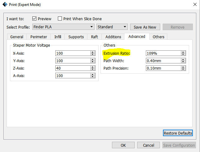

It’s been a while since I’ve used flashprint, but I think slightly upping extrusion multiplier helps with this also.

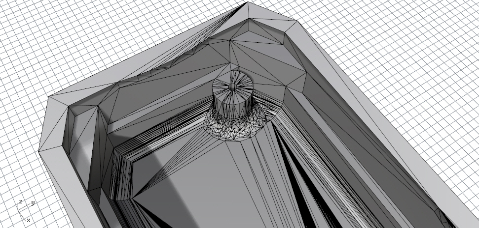

Hi hahanfry,
A have attached the render picture with original model topology (have a look please).
Strange situation then. If perimeter shells doesn’t solve the problem, then the model itself might have a gap in it - but that would even stranger as I can see there is infill visible through the gap.

Thank you for your comment.
I have attached the picture with original mesh topology. I just want to print solid cylinders and the slicer preview is not promising good result

I can find this parameter by activating FlashPrint expert mode in the section Advanced -> Extrusion ratio.
Is this correct? It will probably all dimensions of the model that is not acceptable…

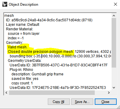

I’ve just checked the model in Rhino, it says model has no errors.
I also checked the cross-section on the models. I think this is purely slicing issue…

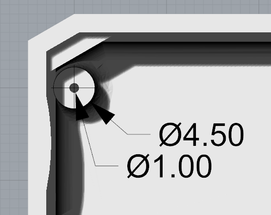

Hi. The drawing seems to be ok. Probably the diameter is too small for our slicer.
Okay,
So here are the measurements
inner hole’s diameter - 1.0 mm
outer cylinder diam. - 4.50 mm
Wall thickness = (4.5 - 1) / 2 = 1.75 mm

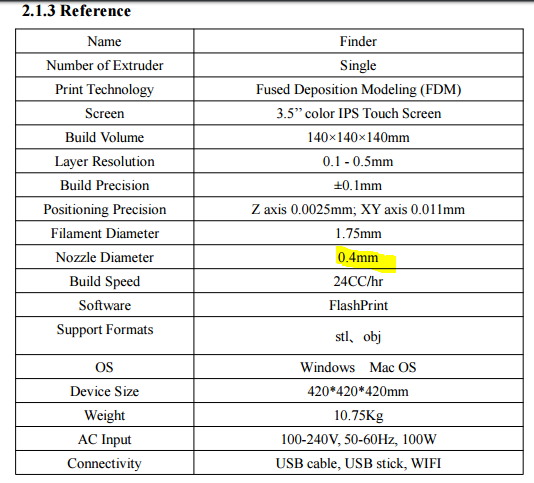

What is the nozzle size and extrusion width?
Hello,
3D printer model - Flashforge finder
Path width - 0.4 mm (I checked in FlashPrint expert mode).
Nozzle diam. - 0.4 mm ( I have found it in user manual)

Try changing the path width to .39, .38 etc. each time checking the slice and see if it changes. Also try if you didn’t already, 1 perimeter.
On occasions where I have seen this it is because the post isn’t big enough in diameter and/or the wall isn’t a multiple of the extrusion (path) width so it leaves a gap.

But what happens when you use 2 perimeter shells?
Or is object in a picture with 2 already? Maybe the cylinder is so small that only 2 shells fits in it, no matter that you set 4 or 3 of them?
Everything is clear now:
2 shells at both sides = 2 x 2 x 0.4 = 1.6; and 1.75 - 1.6 = 0.15 = the gap is too narrow for 0.4 nozzle.
