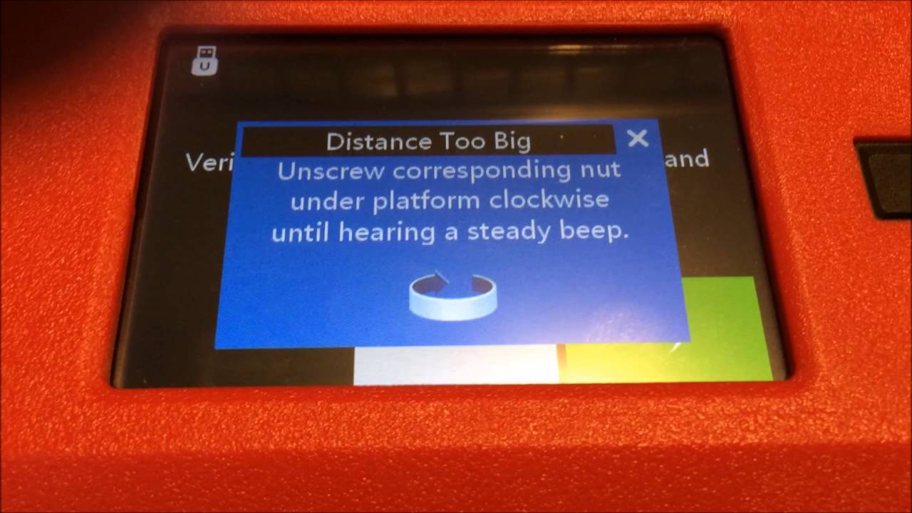

Hi, recently got a finder and as stupid as I am I deleted the defult contents of the USB stick that came along and now i’m having problems with leveling so i need the leveling recovery on the stick. In the levelingmenu I follow the instructions until it starts actually sensing the level of the buildplate. Then it says that I have to tighten the screws even MORE anticlockwise wich is impossible. So I was wondering if someone could help me with either of these problems.

The leveling function of the Finder is a little tricky. When the printer says to “Tighten the screws anti-clockwise,” you should be turning the screws from left to right (as you’re facing the printer). This is indeed “anti-clockwise” (counter-clockwise) when taken from a perspective above the bed, and not below it. That’s why it can get confusing (believe me, I’ve been in the same situation).
There is a video on YouTube which shows the basic process:
Notice that when he loosens the screws, he turns them from right to left. This loosens the bed, bringing it closer to the extruder until the ideal space is achieved.
Hopefully this helps.
