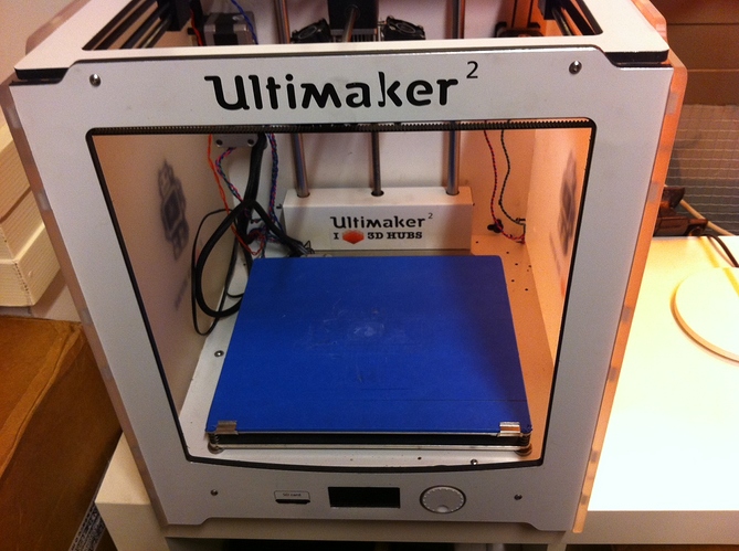

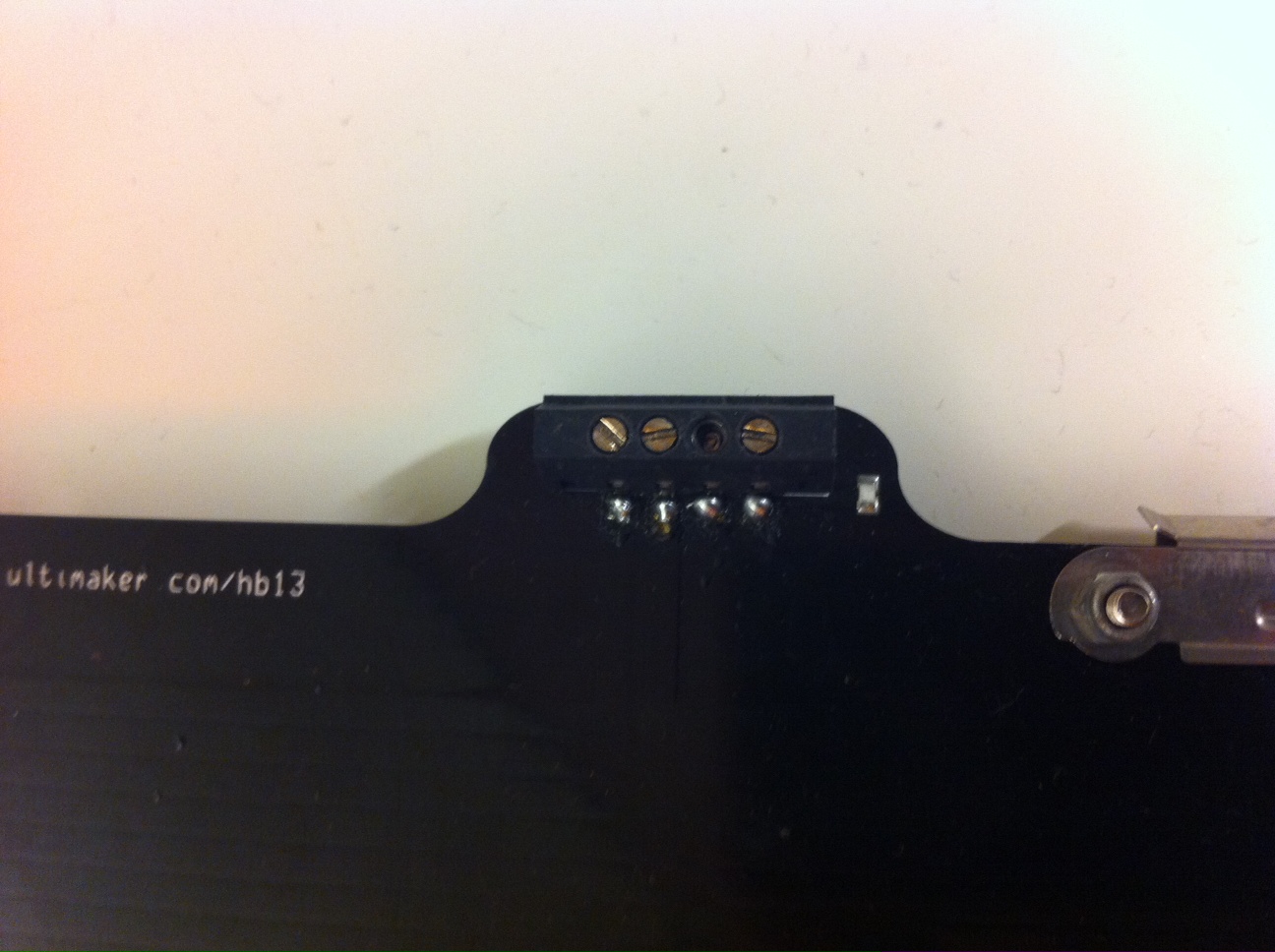

At our in-house 3D Printlab @3D Hubs, we have a couple of printers to experiment with. However our Ultimaker 2 only worked the first two weeks when I started my internship at 3D Hubs. I took the challenge to figure out what the problem was and see if I could get it fixed. By doing so I gained some useful tips I’d like to share with you.
‘’ERROR - STOPPED Temp sensor BED’’
It basically all started with this error. First by unplugging and plugging in the sensor of the heated bed (Temp3) it was solving the problem and the UM2 was running again for a while. Unfortunately not for long.

Most likely #1 the wires could be the problem as plugging in and out Temp3 first resulted in fixing the problem.
So I checked the wires and cleaned them up although it resulted in the same error message. A useful guide for How-to-assembly-your-UM2 can be found here.

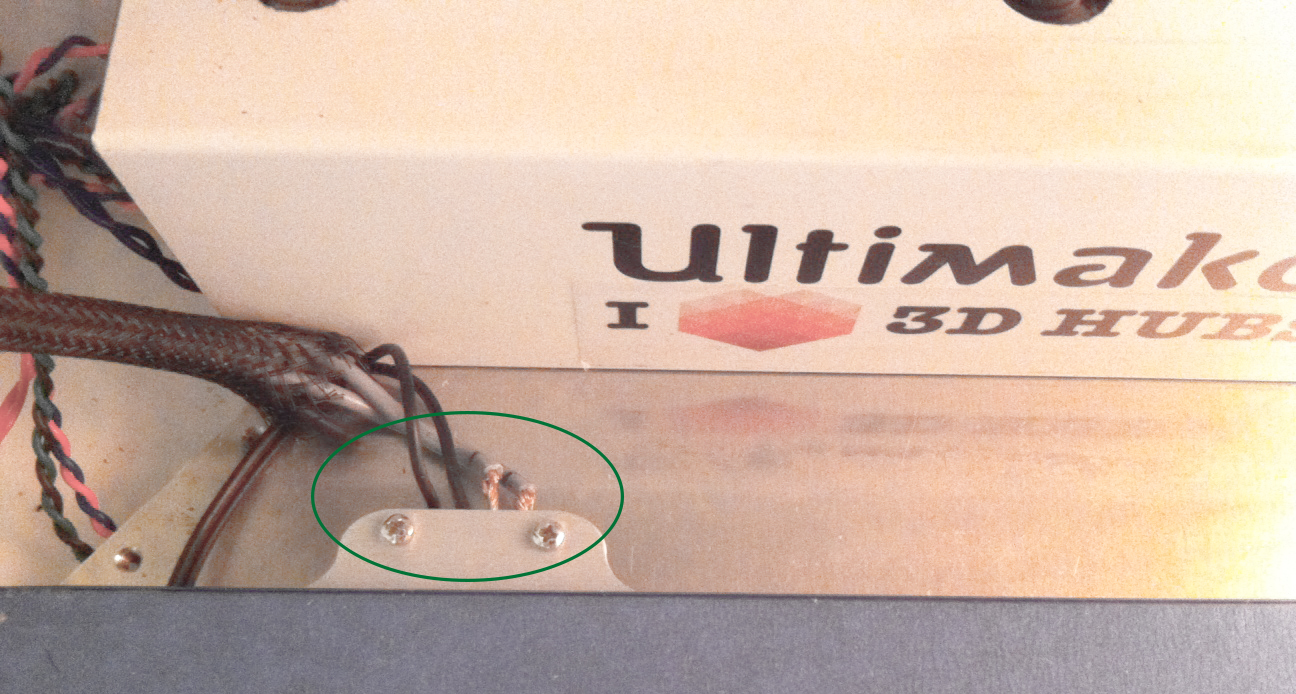

As you can see in the picture the solder joints on the heated bed do not look that good and re-soldering to prevent cold joints was also not fixing the problem.
The same error kept appearing again and again…
One tip I got after contacting Ultimaker to see if the heated bed is broken is the following:
Switch Temp1 with Temp3 on the PCB. This way you let the printer think that the sensor in the bed is now in the head and vise versa. If the sensor is broken the error will change to:
‘’Error - Stopped temp sensor’’. If the error stays the same, then the mainboard is broken and needs replacement.
In our case the error switched and this indicated that the heated bed needed to be replaced.

It is working again!!

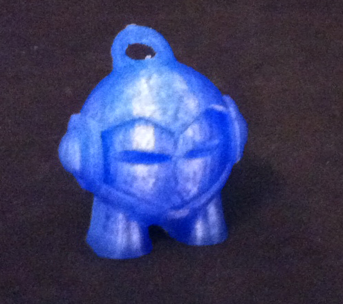

Hey guys,
UM2 has successfully printed a Marvin again! Yay!
