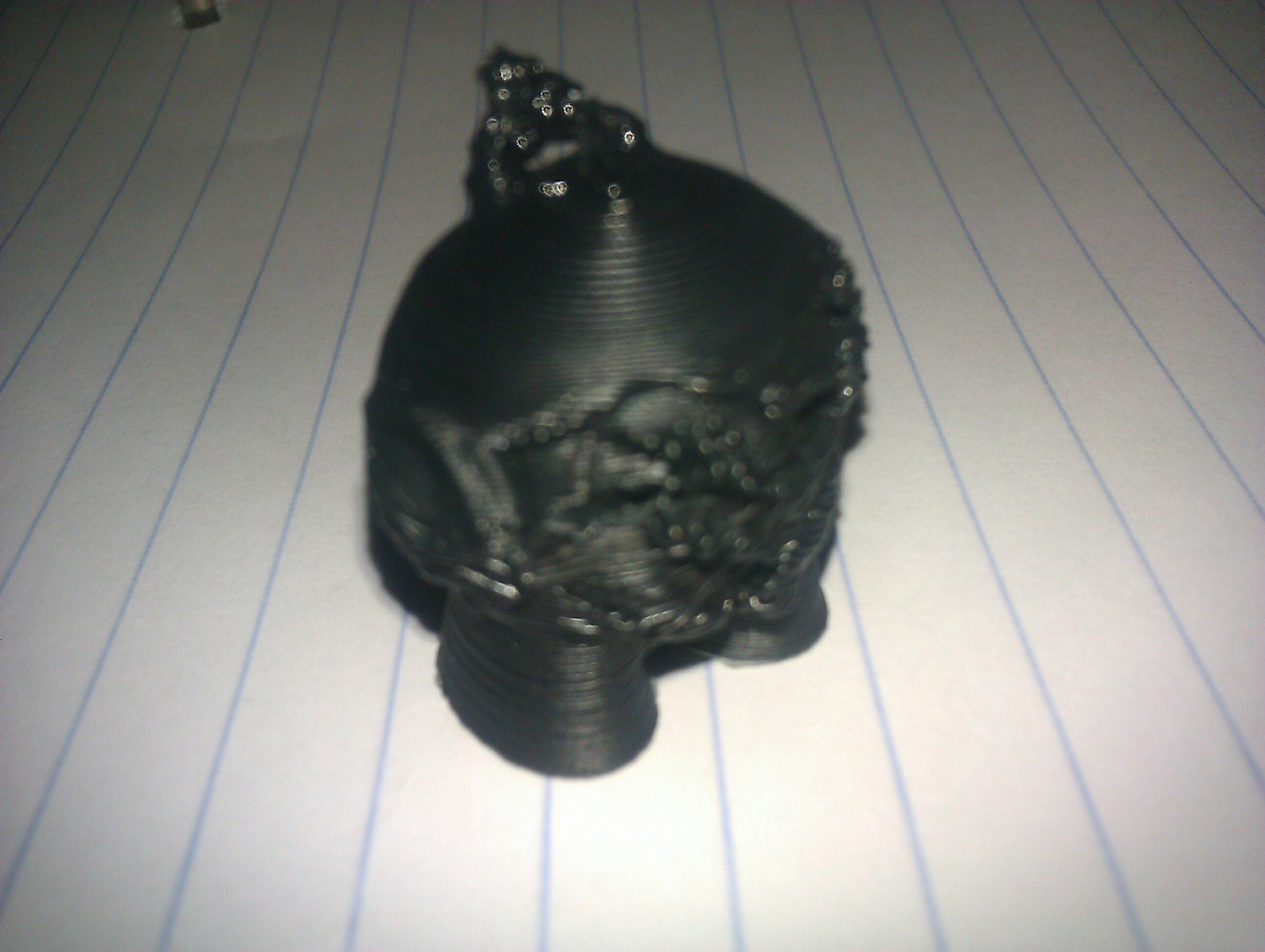

0.2 layer
250 end
80 bed
60`mm/s
What should I do?
Hey Henrique,
Try lowering your hot end temperature to about 230-240ºC, and decrease the speed to about 20-30 mm/s.
And increase the bed temp to about 100ºC.
Kind Regards
Max Moors
You can also trying printing a couple Marvins at once, which allows for the layers to cool better between each pass of the extruder. Marvin is a fairly small print, so each layer stays hot for awhile since the hot extruder is always in contact with the body. Printing 2-4 Marvins simultaneously was the only way I could get it to print decently, regardless of speed, infill, wall shells, and temperatures.
Each printer is a little different, but as was said above, you definitely want to bump up your bed temperature.
I had the exact same happen to me, just turn your bed temp off after the first layer, it’ll turn out way better.
My settings if you want to try.
e temp = 230
bed temp 90 - 0
speed 50
0.2
speed assist on for small layers.
Thank you all for our help, I managed to get it done following up all the tips given.
