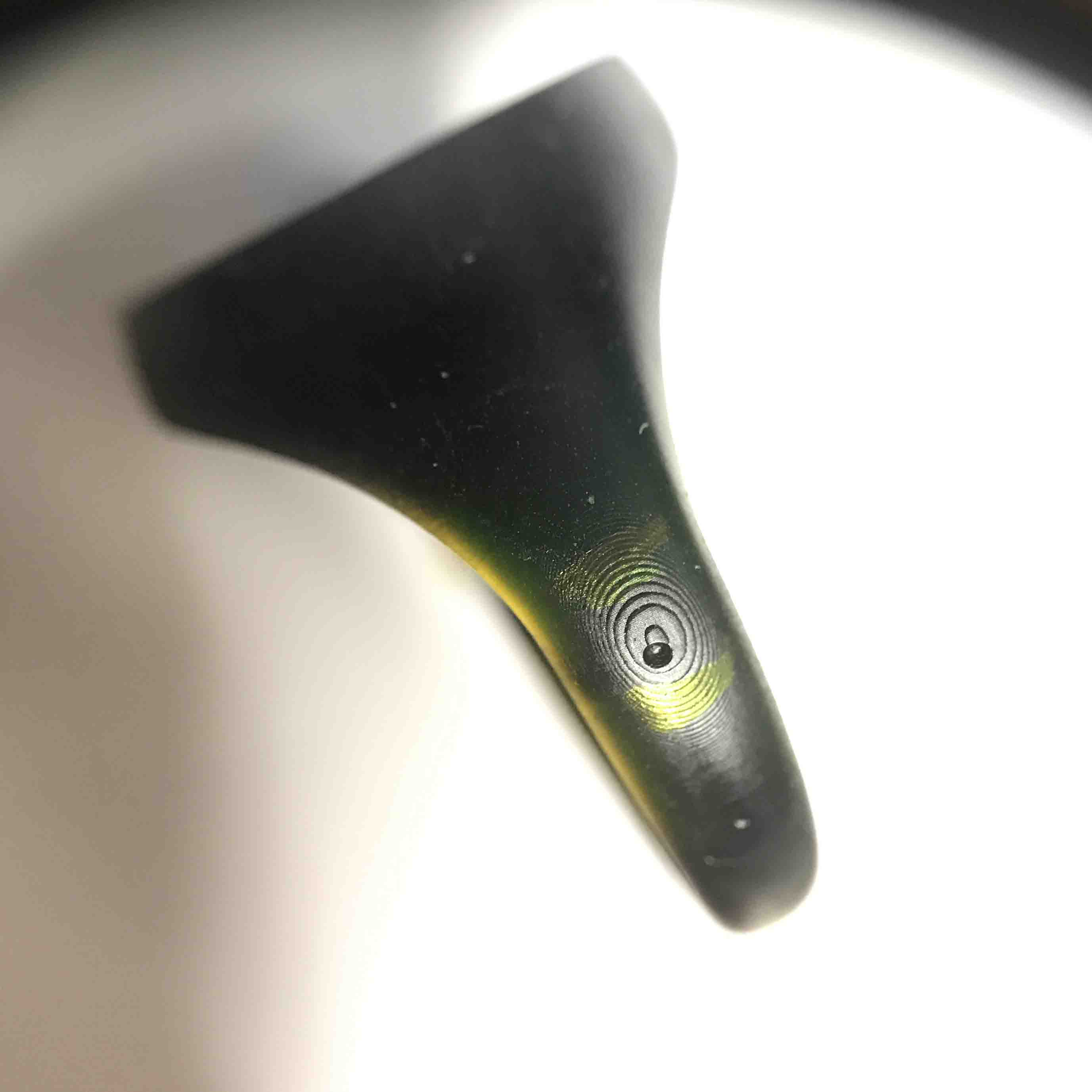

We have an Envisiontec Perfactory Mini machine. Lately, we have holes from our printed models. I’m trying to find out what is the cause of this problem. I attached few pictures here. I really appreciate if anyone can help.
Thank you
Pic100G resin

Have you checked the PSA foil?
I also have that problem sometimes on our perfactory 4’s
Hi Mx,
I have not check the PSA foil. Can you let me know where is PSA foil located in the P4?
The PSA foil is the transparent film between the resin and the glass at the bottom of the basement. If you drain the resin out of the basement you should be able to see it right away. Sometimes it may have bumps or even small holes. If that’s the case try replacing it. It should be good after that.

The PSA is a three part system. The first part is the metal and glass that stays with the machine. The second part is the upper metal frame with the film stretched over it and the third part is a loose piece of release film that floats between them. Are you talking about the release film or trying to rebuild an old frame?
