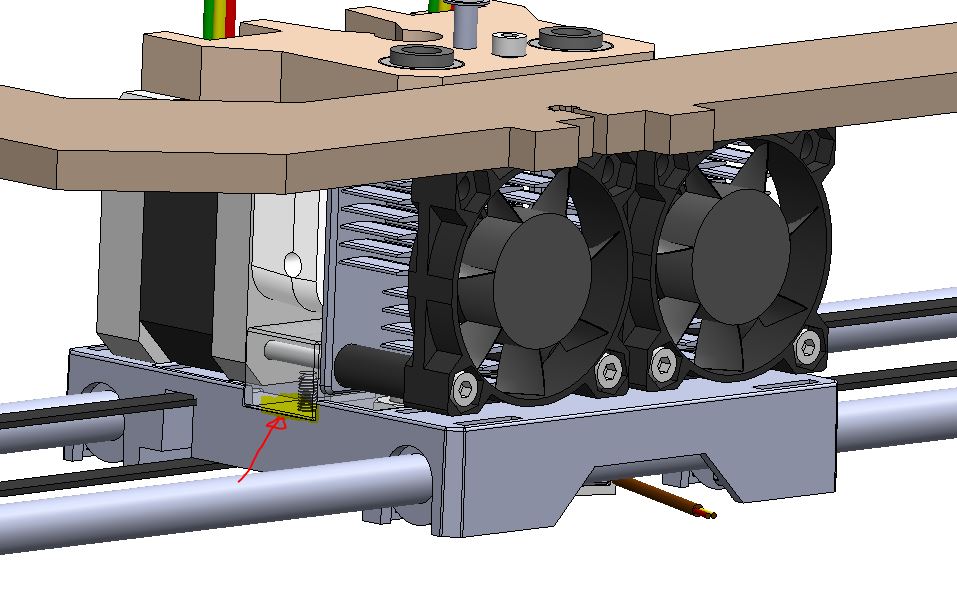

Post-it notes work well since they stay in place. Cut the strip you need with an exacto. I make a piece that is the depth of the bar front-to-back and has cutout to go around the screw. Almost a [ shape around the screw coming up from below.
Nate, dont suppose you could take a pic of what you are describing, re the position of those post-it notes?
thanks!
The image below shows where to shim, on the surface highlighted yellow between the bar mount and plastic carriage .
Unscrew the two screws that hold the extruder assembly to the carriage.
Put a shim of paper or thin plastic under the left side if you want the left extruder to go higher (if it was lower than the right).
Do this on the right side if the right extruder is slightly lower than the left.
