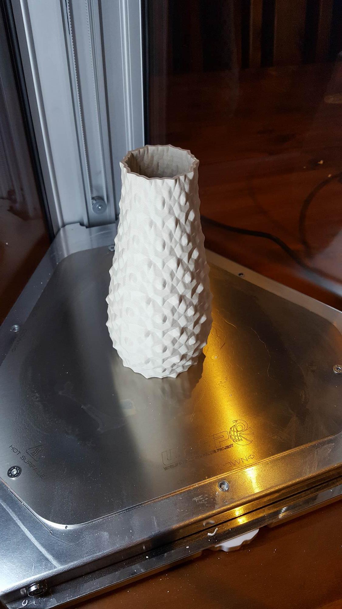

Hi all!
I have read briefly through other threads about the topic (including Talk Manufacturing | Hubs)
but have had no luck with my problem.
Originally I was having problems with the extruder, but with a firmware update and correct calibration it was easy to get it working with a default model that came with the product.
I am now trying to print my own fairly simple designs but am having some major dramas.
Things that are working:
  1. Clay is coming out
  2. Path output from slic3r seems correct.
Problems I am having
  1. Noise which sounds like the stepper motor or drill bit is slipping for the first 2 layers
  2. It appears too much material is coming out
For the material I am unsure if it is just my distance between layers is too close, as I am unsure the perfect height for the 1.2mm nozzle. Although this is what is crossing my mind, I believe the sort of squashed effect the ceramic is having makes me think that the material is simply coming out too fast.
I have manually tried to change the gcode, and from what my little knowledge in gcode is, I came the conclusion that the feedrate F#### may need to be adjusted. Having done that, matching some of the speeds with the “spiked vase” that came with the ceramic printer, I had no luck producing the parts I required.
These parts are extremely simple, a rectangular prism with a small cut out (used for a charpy test).
Any help with this problem will be greatly appreciated and may even get you a mention in my thesis!
Thanks
Per ottenere una buona stampa dell’argilla occorre stabilire il giusto equilibrio tra:
qualità del materiale impiegato
durezza dell’impasto
pressione dell’aria
velocità di estrusione
Se l’impasto è troppo duro la pressione dell’aria (6bar) non è sufficiente (ci sono compressori che arrivano a 8-10bar)
Se l’impasto è troppo tenero la stampa potrebbe collassare
I layer devono risultare schiacciati per ottenere una buona adesione tra i layer con un uggello da 1.2mm puoi usare dei layer da 0.6-0.8mm
Se esce troppo materiale puoi calare la pressione dell’aria.
Se con estrusore fermo esce l’argilla c’è troppa pressione oppure il materiale è troppo tenero

I am currently using a good grade clay supplied by the manufacturer with an additional 5% alcohol in weight to the clay.
It appears that it is printing fine with an attached picture to show. However this is a default model supplied by the manufacturer, and I need to print my own models. I will try to adjust the print speed using slic3r before posting again. If anyone is a professional at slic3r and can give me a few pointers, that would be amazing
