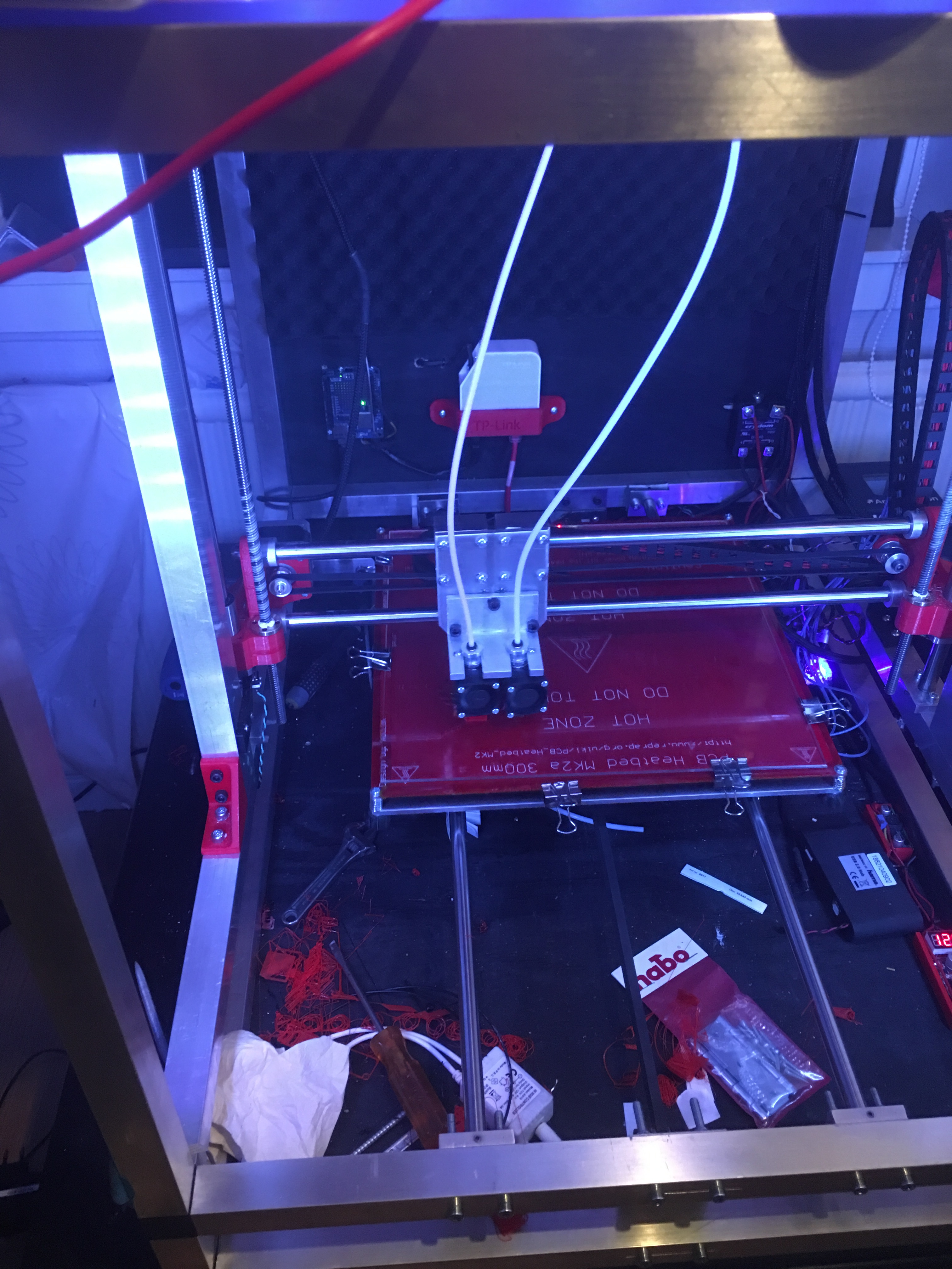

Yes I understand that. I am capable of making one that’s for sure. I like the challenge to build stuff
i already have one homemade 3D printer (pursa type) and it’s a pretty simple and easy design.
The reason why I want to build my own delta is because I’m curious. And already have a pile of motors, controller boards on hand.

ive already built a 3D printer //build in progress
waiting for the last parts to arrive and then it should be ready
