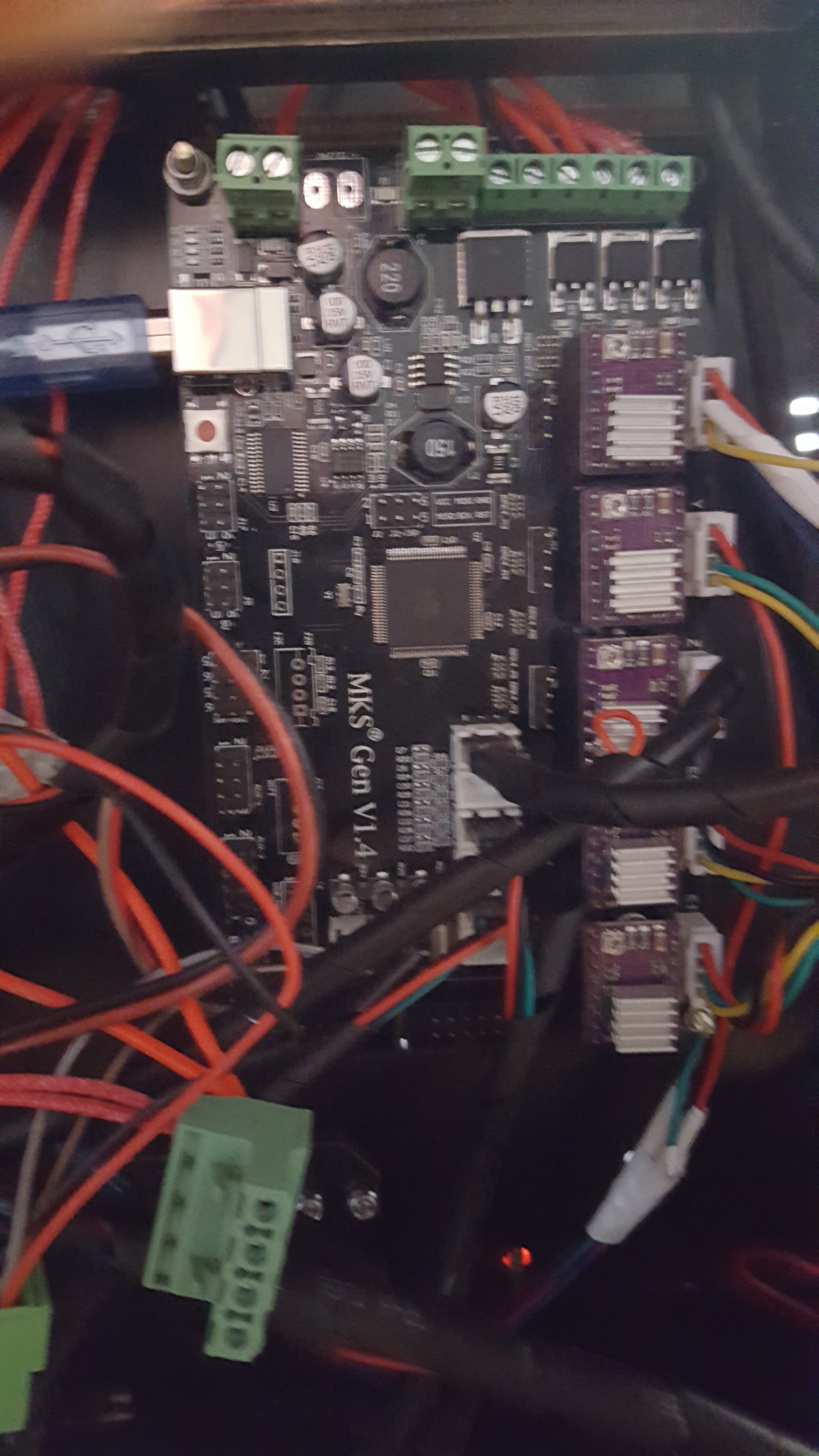

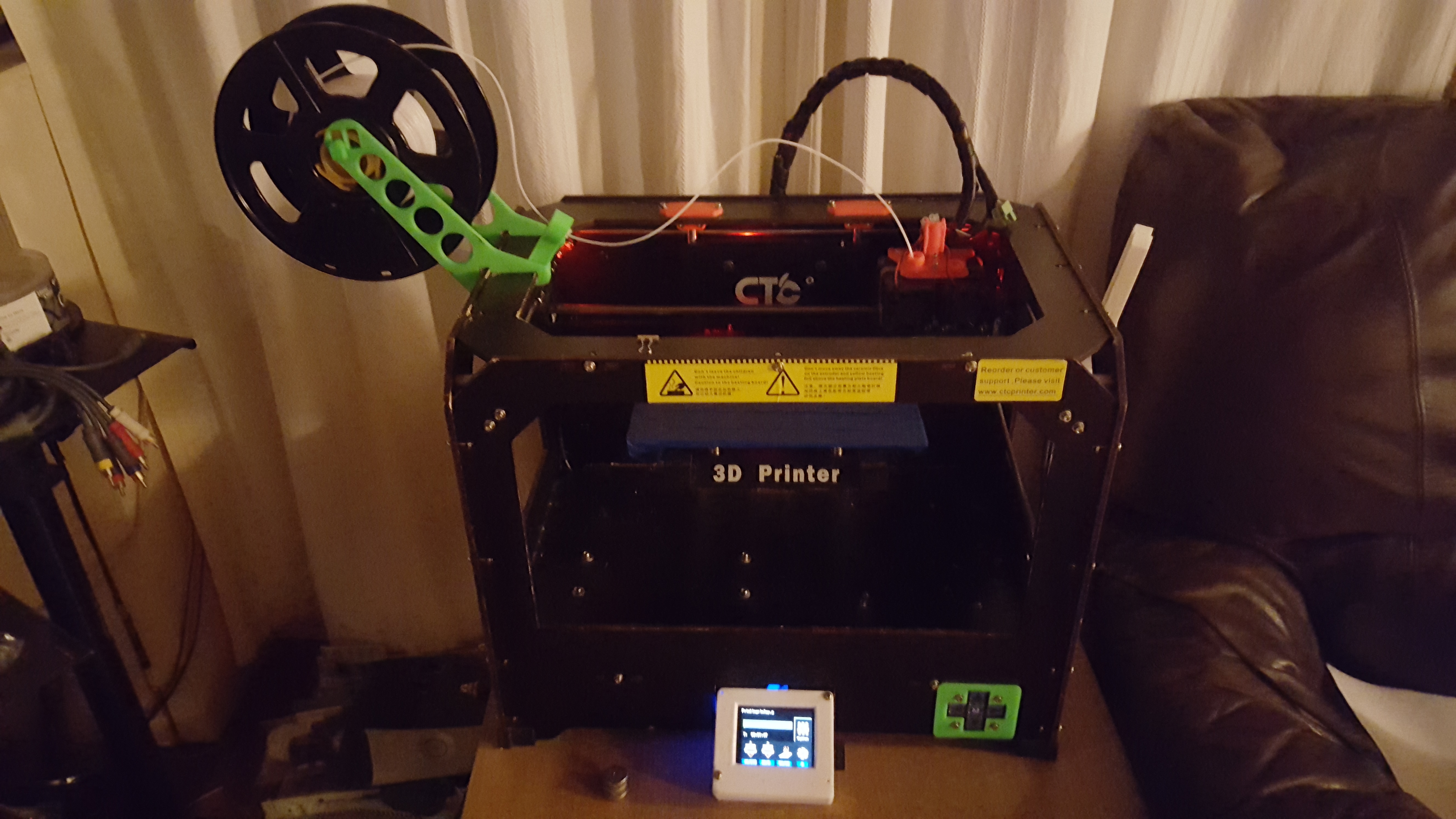

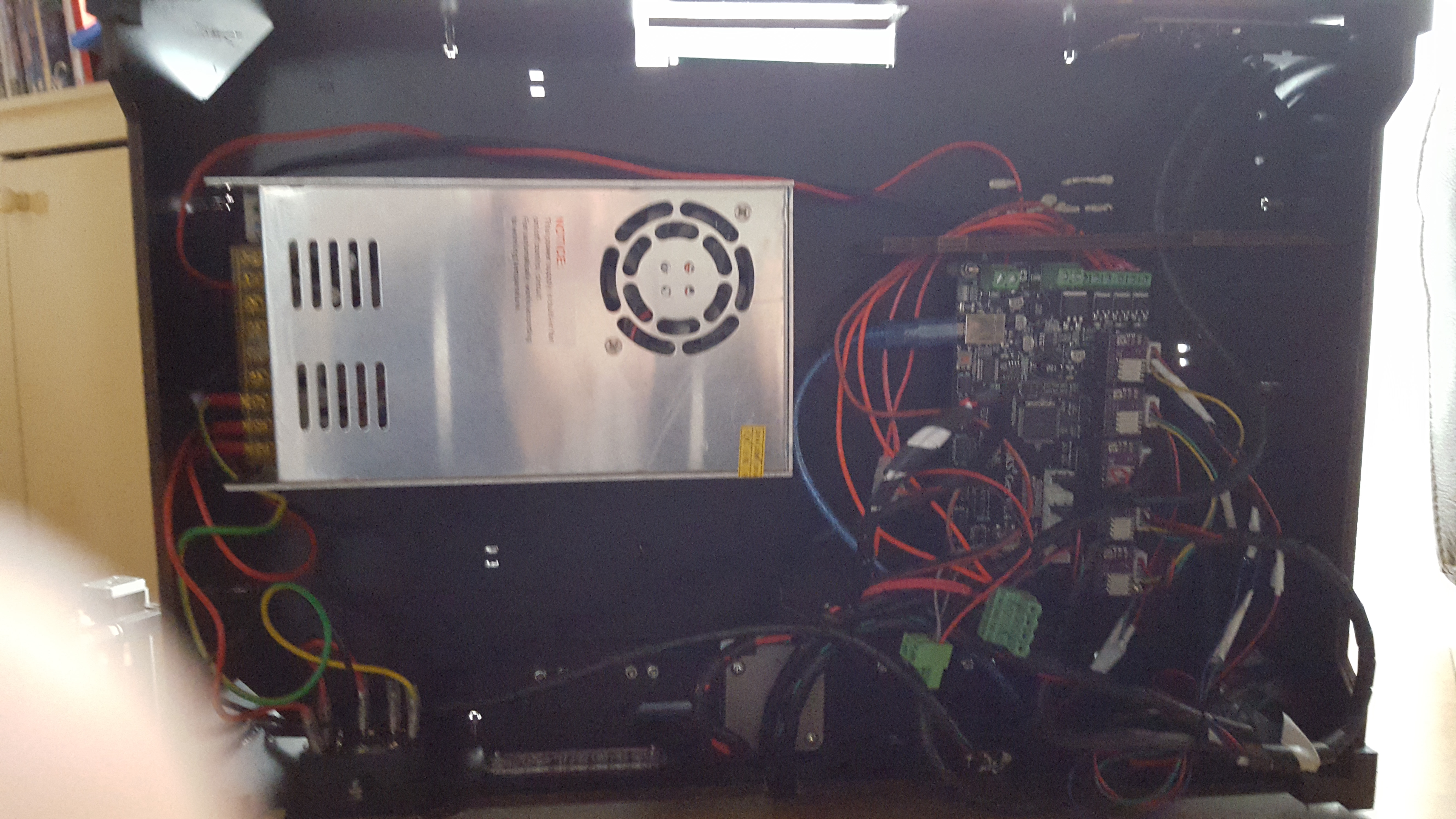

My CTC Replicator (copy of the flashforge) motherboard is broken down and as I can’t find a Mightyboard at an affordable price, I am planning to use my spare MKS V1.4 with Marlin RC7 Bugfix firmware.
So far I haven’t managed to get the default steps per millimiter of the other board as is completely bricked, I wonder if anybody could tell me the default settings of the CTC?

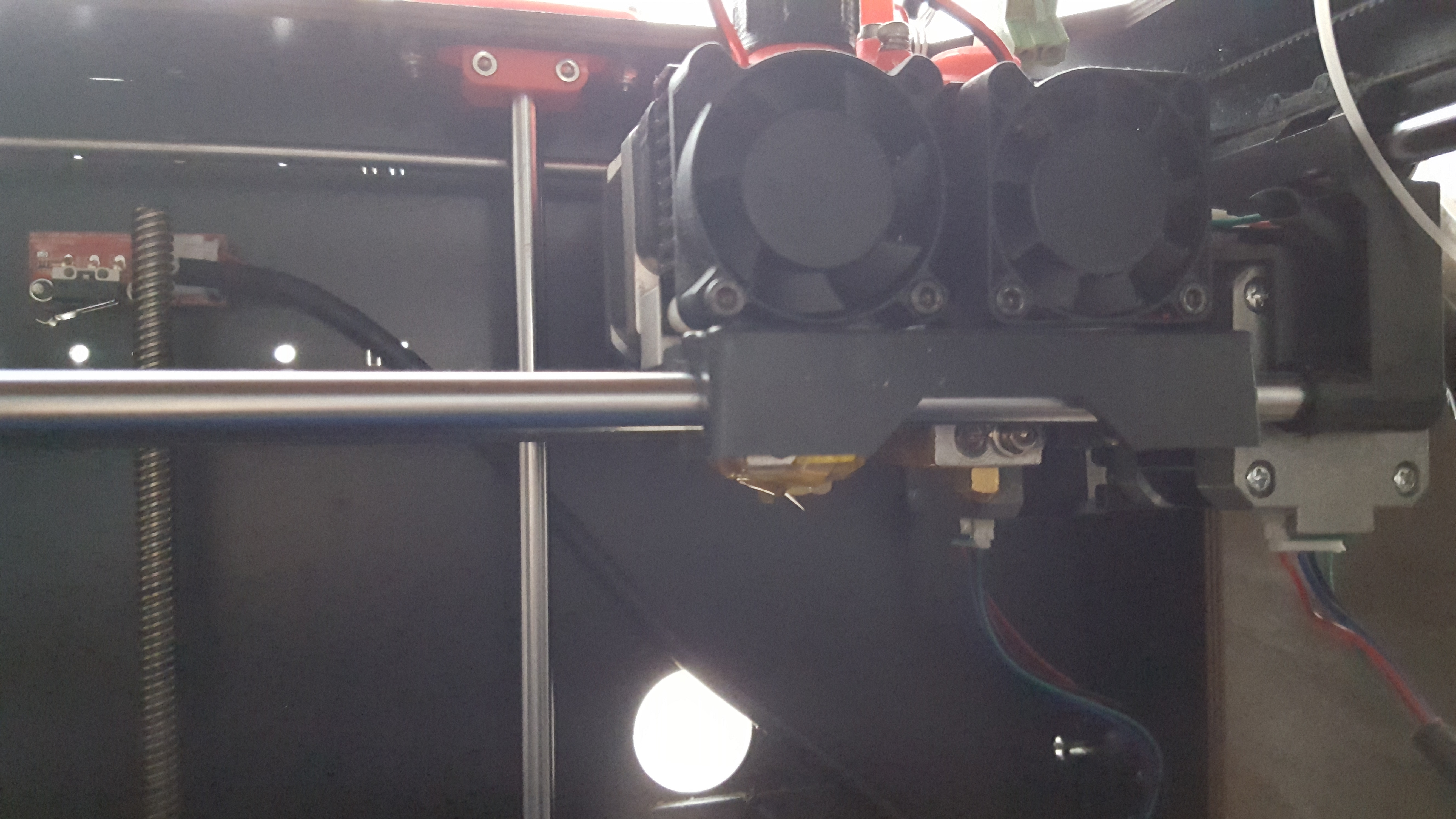

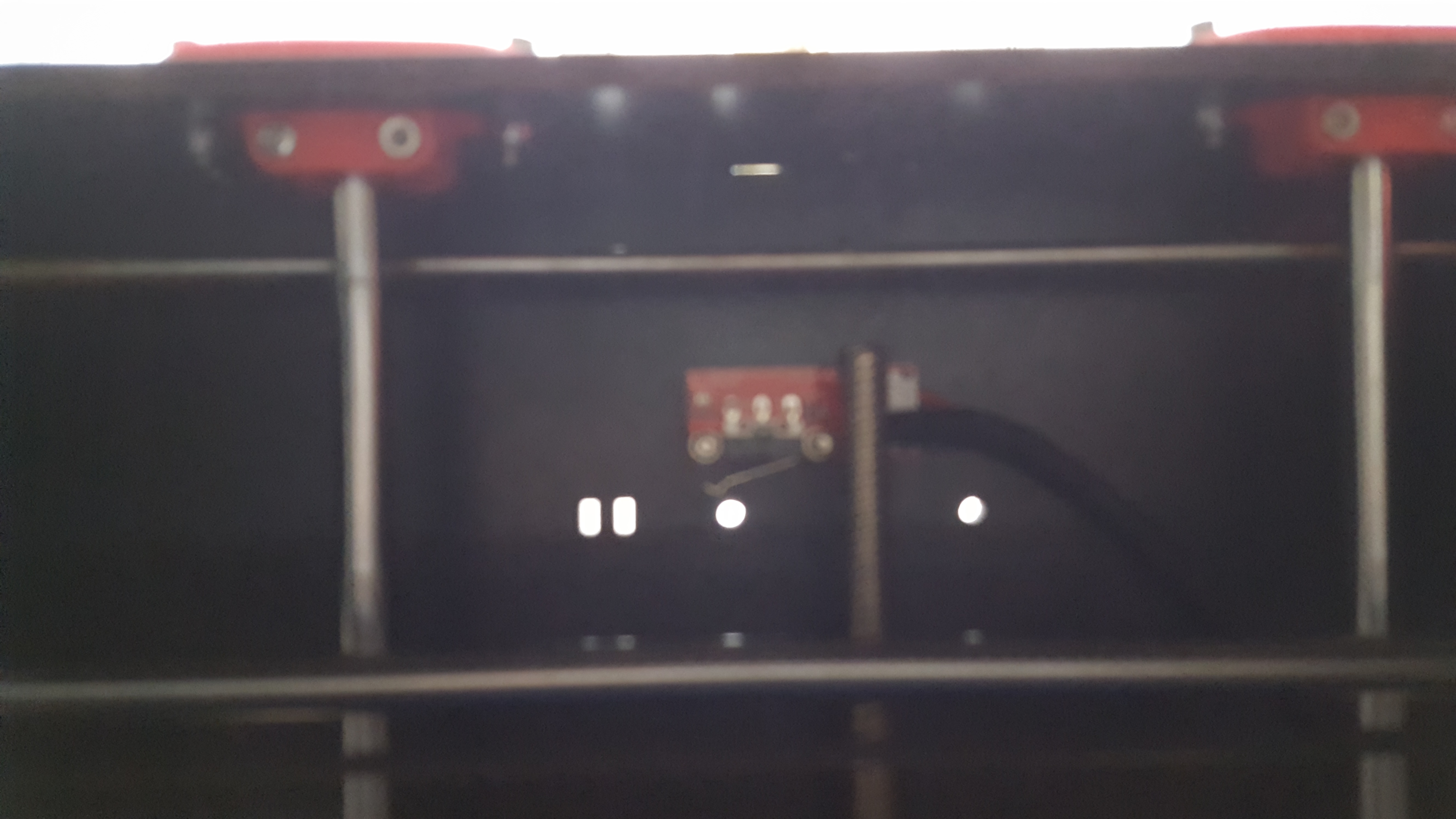

I have already converted to thermistors and replaced all endstops with the mechanical version and also replaced the cartridges to 12v although unsure if I need a 24v or 12v Heated Bed as the MKS takes both PSUs, although I had put a 24v I think that the MKS reduces the output to 12v. Maybe someone can help me and let me know if this is correct.
Once I’d managed to get all settings I will be happy to share the Marlin Firmware and list of materials/pictures in this thread for the conversion to MKS / Ramps 1.4.

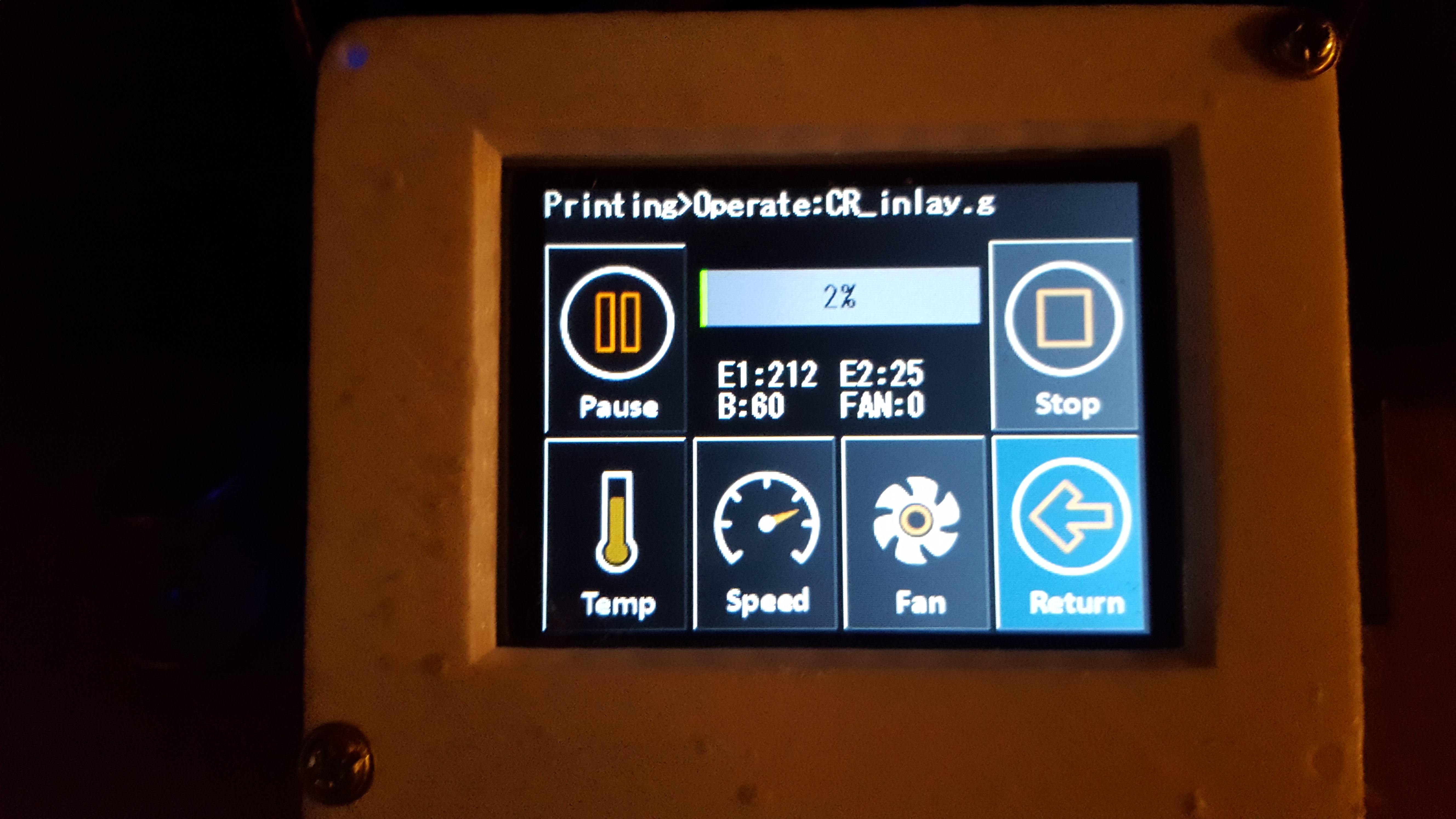

The MKS does support the 24v bed and 24v heat cartridge, so I only had to rewire the bed to the MKS and replace the thermocouples for thermistors. The firmware seems to operate correctly, however I have tried to print and is off centre I believe is my settings on Cura. I have also implemented a MKS 2.8" Touch Screen and is looking sweet. I have to fine tune everything and will reupload the new firmware, in the meanwhile could someone help with getting the print into the centre of the bed, maybe someone with better knowledge could make a Cura profile (bearing in mind is Marlin not Makerbot firmware).
UPDATE 3!!!
Still have got problems, it seems to print on the top right without printing entirely on the bed. The good news is I have research and for the initial position can be specified in Slic3r rather than in Cura, so I am going to experiment Slic3r settings and the CTC Marlin firmware for the next few days.
If anybody wants to help please feel free as this conversion it seems to be a good upgrade once I implement Auto Level and sort all the touch screen controls (as the all the bed leveling commands needs to be changed in the MKS 2.8" Touch Screen V1.2 firmware).
