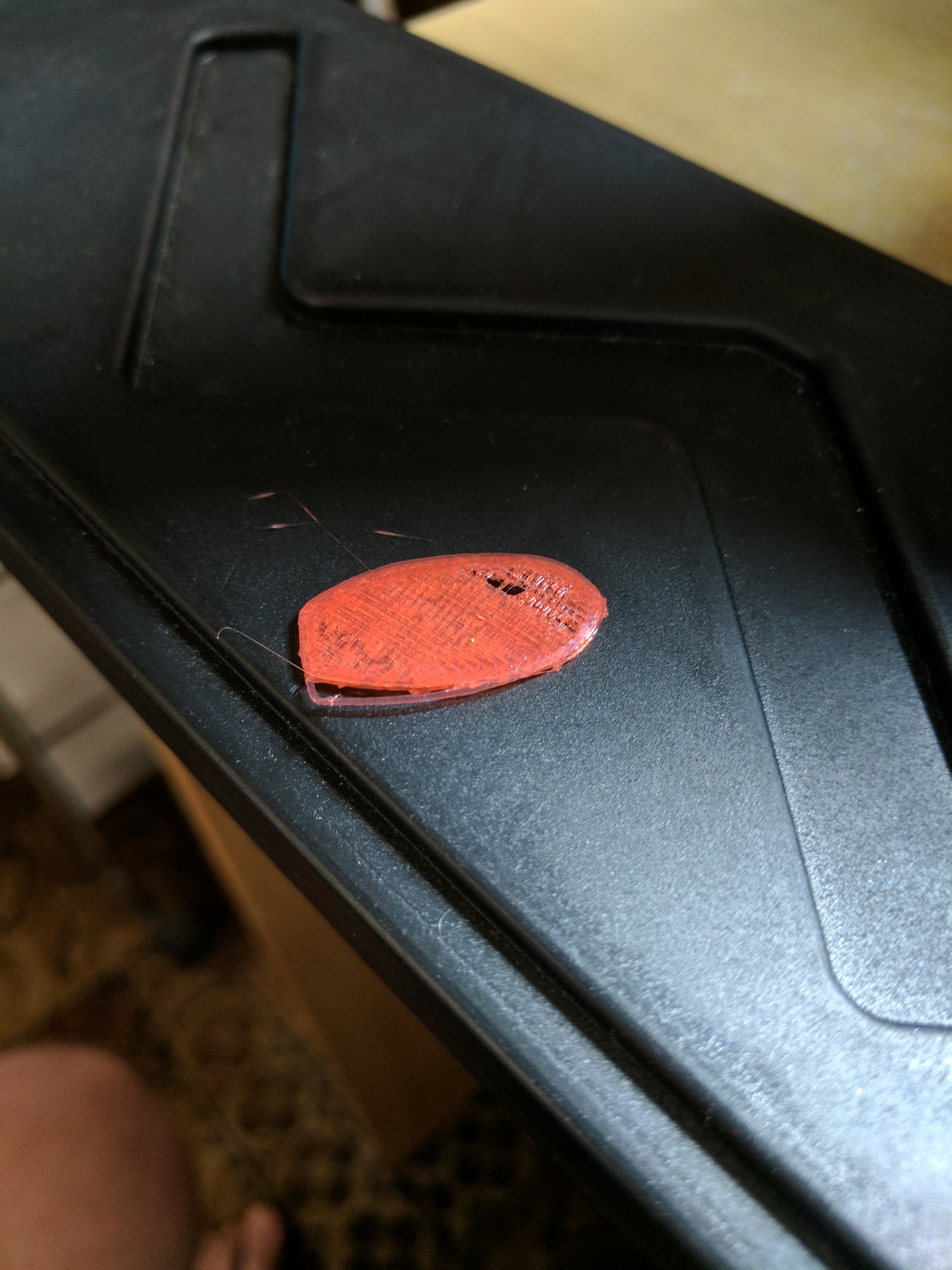

Hey guys, I’m hoping someone on here will be able to help me. I have a CTC Duplicator 4 and I’m having issues with my first layer (and then every layer after that it tries to do ?). I’m printing with PLA at 200 degrees. It was printing fine for quite a few prints and now it’s doing this :confused: I have taken the nozzle out and cleaned the crud out with a gas torch, so it’s pretty darn clean and I’m still having issues. Fresh pfte liner as well. It seems to do one or two layers partially okay, then just stops extuding and its like it’s just ripping up the filament as it passes over. I’ll post up some photos so you guys can see what’s going on. Any help is much appreciated!
I would re-level the bed. Nozzle might be to high now. Clean the bed.
