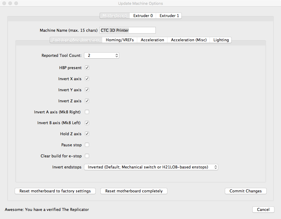

Have you been fiddling with Machine Options in replicatorG?
Because the extruder layouts are mirrors of each other, one extruder has it’s motor axis reversed. This is a firmware setting. Your machine options page should look like the attached image - B axis is inverted, A axis is not (A and B are the extruders (they’re not really axes, but it’s just terminology)).

Hey slippyr4,
Thanks for the info. First to answer your question, yes I have. I have been messing around with a lot of things in different software that I have ( I was using Makerbot and ReplicatorG ) and another one, I was trying different things and experimenting, just being a newbie… LOL :-).
I don’t remember changing anything in the machine though, I may have. If I did, would it change it in the machine itself? I thought about what you said, so I disconnected the USB and tried loading Filament from the CTC Clone itself, thereby eliminating any changes that I may have made in any software, but it didn’t change, the left motor is still turning backwards.

Also I checked and my settings are just like yours. I committed it to the firmware one more time just to be sure, but no change, motor still running backwards.
Latest update:
I went into the Firmware screen that you showed me and inverted the A axis (sorry I have been saying the left extruder when it is the right one), so anyway when I inverted it of course it goes the right way now, but I that is just putting a band-aid on the problem. Not sure though?

Ok, Stop the presses, I must apologize to all that was trying to help me, I made a very stupid and newbie mistake!!
I was looking it the stepper motor the wrong way. The feeder is of course on the opposite side as the Left motor so of course it will rotate in the opposite direction. So problem solved, with the rotation, and it stopped extrusion because it was clogged. Again I am sorry for wasting your time, and I hope it will not reflect on any further questions that I have in the future because I am sure I will have more.
