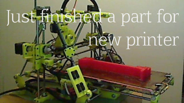

Hi Kyle,
I have a printer design on instructables with a 200mm. x 425mm. x 140mm. that may have some design elements you could incorporate into your build. The printer as it is may not do well in an enclosure, I have not experimented with ABS yet. The i2 design has preformed very well with 750+ hr. print time, and still going strong. Here is a link to the printer: http://www.instructables.com/id/Long-Bed-Printed-3d-Printer/
The Y Axis design will be made Into an separate instructable, so makers can adapt it to different machines, when time allows.
Good luck with your build,
Dennis
