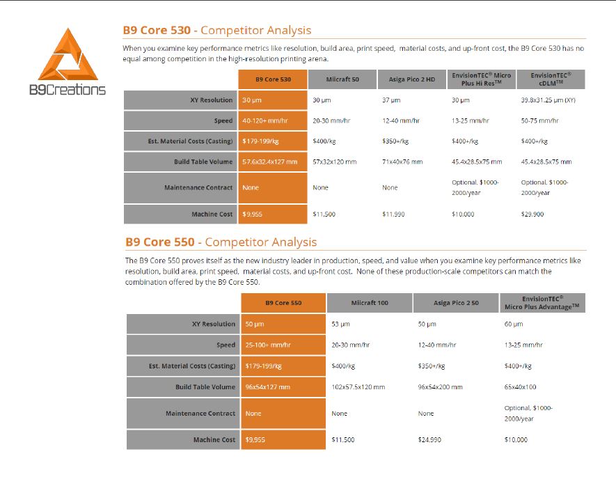

Here is a comparison chart for the Envisontech and B9 Core Series printers. Please let me know if you have any questions. Thank you.
