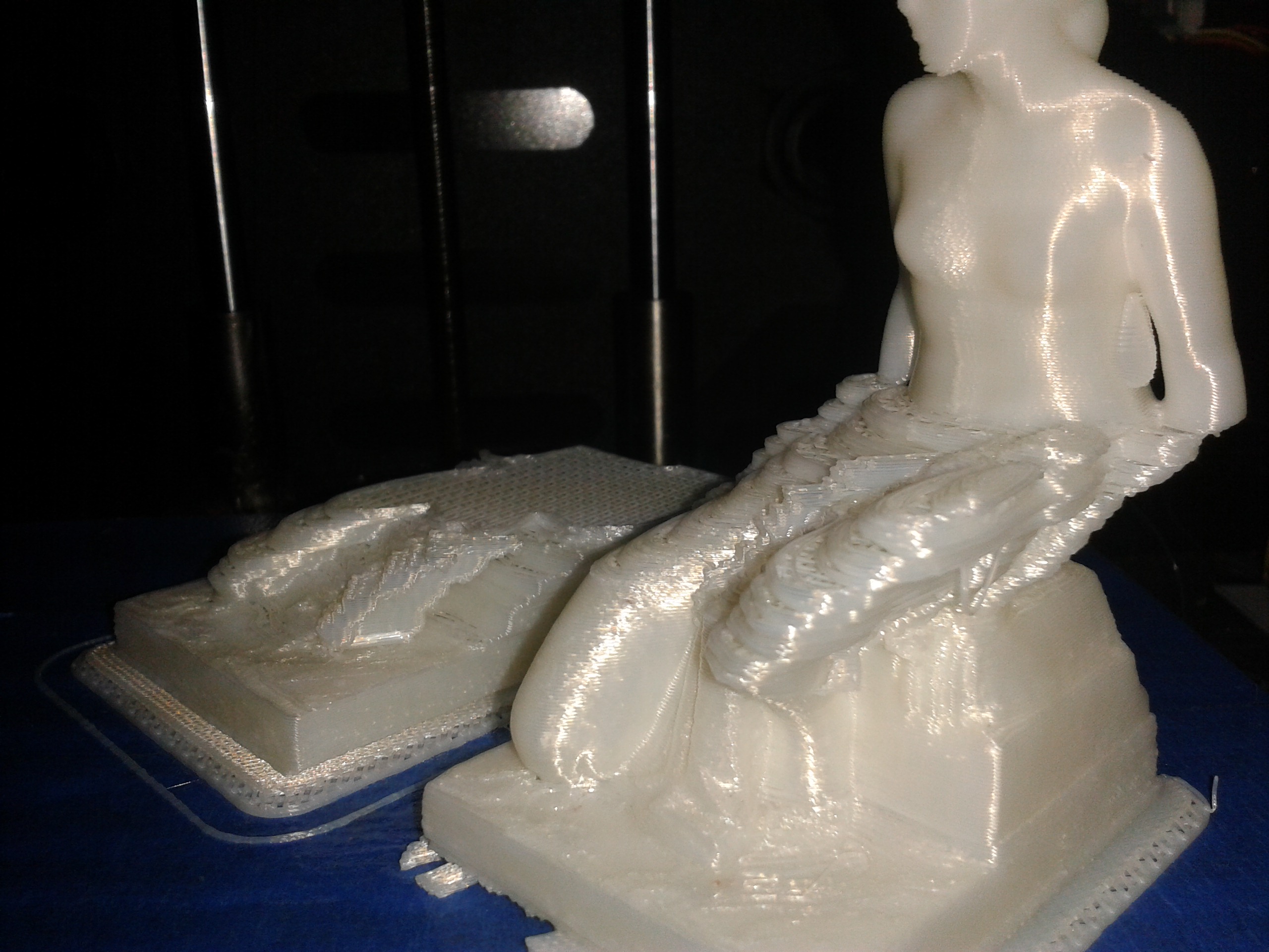

I got a FF Creater Pro last november, and it’s started to go wrong!!!
It’s an amazing machine, just keeps going. Till it stops…!
This has been happening for a week or so. It only happens after I have been printing for a while each time…
I printed one model without problem, and then this started to happen with the next one. As you can see from the attachment, the left-right axis (is this x or y?) starts skipping. The model at the front is was the first try, and then the one at the back.
The skipping/slipping starts at random points, so it’s not the model itself. The belt doesn’t seem to be especially loose.
I’m hoping that this is something quick I can fix for myself as I have a couple of other orders backing up…
Any suggestions?

Hey - Shifting layers can happen when one of the pulleys is not secured properly to the axis/axes. The pulleys may need some tightening with a set screw.
This article goes into a bit more detail troubleshooting this issue - Hope it gets you started in the right direction.
Great answer. Does your FFCPro also suffer from intermittent stops? Or where the printer might cease mid-print and slow move toward the X or Y axis? -Andy
The other thing I’ve seen, though not on the FF, is if the head catches on the print. Can be caused by crud on one of the nozzles, too much plastic being extruded, or the print warping off the bed.

I checked out Alex’s article and made sure all my rod gears were tight. Nothing loose.
So I oiled the rods… Boom. Fixed. I think hairspray residue must have been building up on them, drying them out.
Need to find some proper grease (I used baby oil!!)
I have experienced the exact same problem on my Creator. The problem was the timing pulley slipping on the motor shaft.
Tightening the set screw fixed the problem…for a while. Taking a closer look I realized the set screw was contacting the motor shaft at the very end so it would eventually vibrate itself loose. I had to flip the pulley around on the shaft so the set screw could do its job. Haven’t had a problem since.

Make sure acceleration is turned on via the lcd for speed ramping. Large builds may hit the limit switch and make the stepper skip. Check the stepper cable. Wiggle it while printing. Check pullies, tighten belts ect.

are you sure the nozzle is not hitting the print? I had to adjust my nozzles the left nozzle was lower and kept hitting anything i was printing with the right nozzle. The result was something like i see in your photo. Once i adjusted them I did not have this issue anymore.

Hello, try to limit vibration on 15Hz in Slic3r
