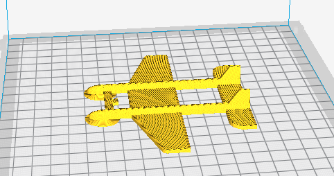

I made my first two prints today on the A8 and they turned out awesome. One was the chess piece pre-loaded on the card, and the second was an upgrade off thingiverse. I noticed on both of them (and on cura for the third print I wanted to start) that there were these totally awkward and unnecessary bases that did nothing but use my filament and my time because I had to pick them off with a knife.
It’s like an extra perimeter’s circumference on my first print about 2 or three layers thick, and you can see it on the two tips of the glider in cura. I have no idea why it’s there, I have printed this glider before on a school printer and it never printed these. I’m using the exact same file, and neither of the three prints require supports. Any Ideas?

It sounds like you might have “raft” turned on in your slicer, which would cause an extra 3 layers to be printed before the part begins.
