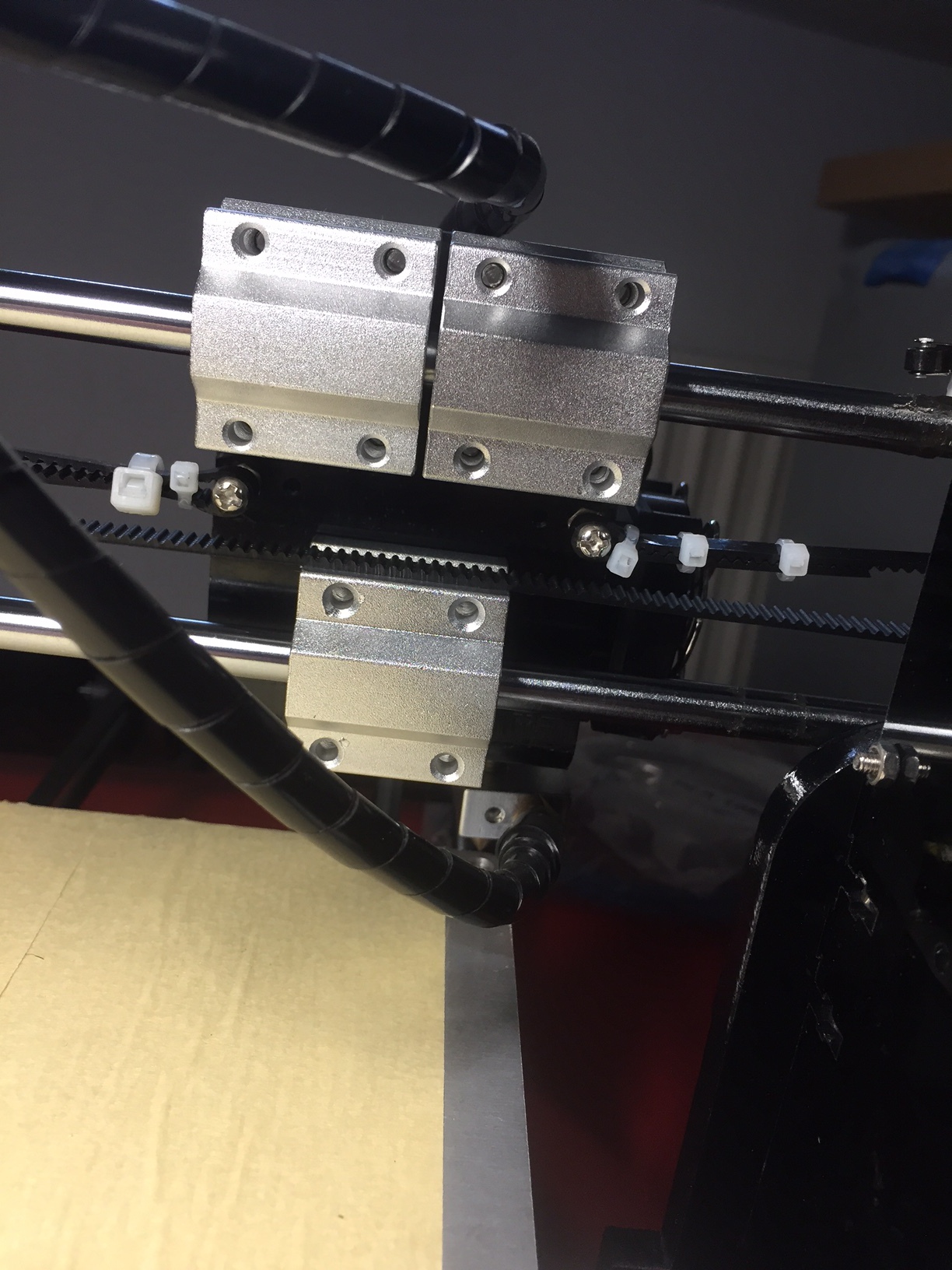

after I installed everything … I turned power on the Anet A8 … went to the return home function and x goes in the opposite direction. What is wrong?
Moin, T-Belt wrong installed or the Stepper Motor wrong cableing (Factory). Check the colors and compare with the other Motors. Artur
Can you post a picture of the back side of your x-carriage?
Hi . If it’s the same thing that I did ? Then you may have put your x belt on upside down . Like I said it’s what I’d done and it went the wrong way . Hope this helps , Andy

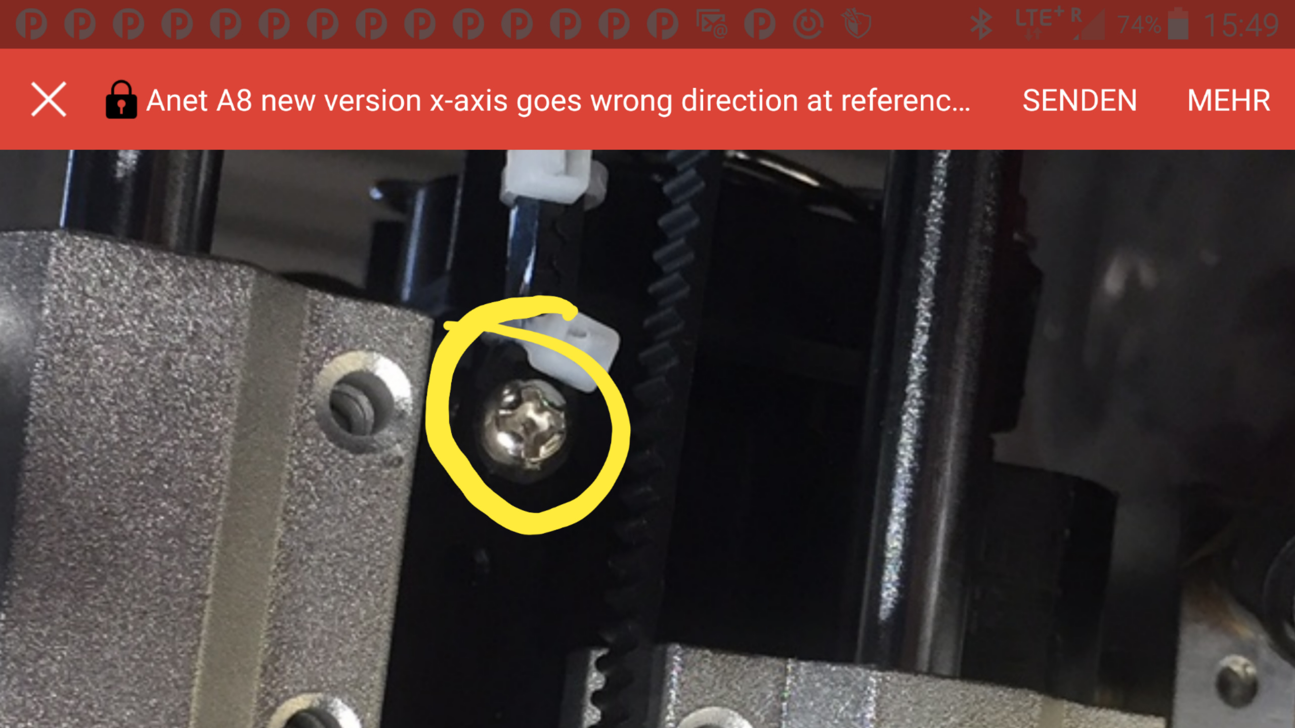

Thanks to all for this fast help. Here are some picture?
From picture 2 i can see that your x belt is “upside down”. It’ s supposed to be fastened to the screws, then goes under the motor pulley, around, back above the pulley, over both screws, over the second pulley, back under the second pulley and finally to the second screw. Edit: the best way to describe it is probably that the lower part of the belt is fixed to the x carriage, while the upper part is not.

Udo your Belt is wrong. The moving part of the Belt has to toch the TWO upper sliders. Artur
Udo, you used the wrong holes for the belt fixing screw. Artur
Hi Artur
Thanks for your awesome eyes… you were right … my failure … it works like it should :slight_smile:
