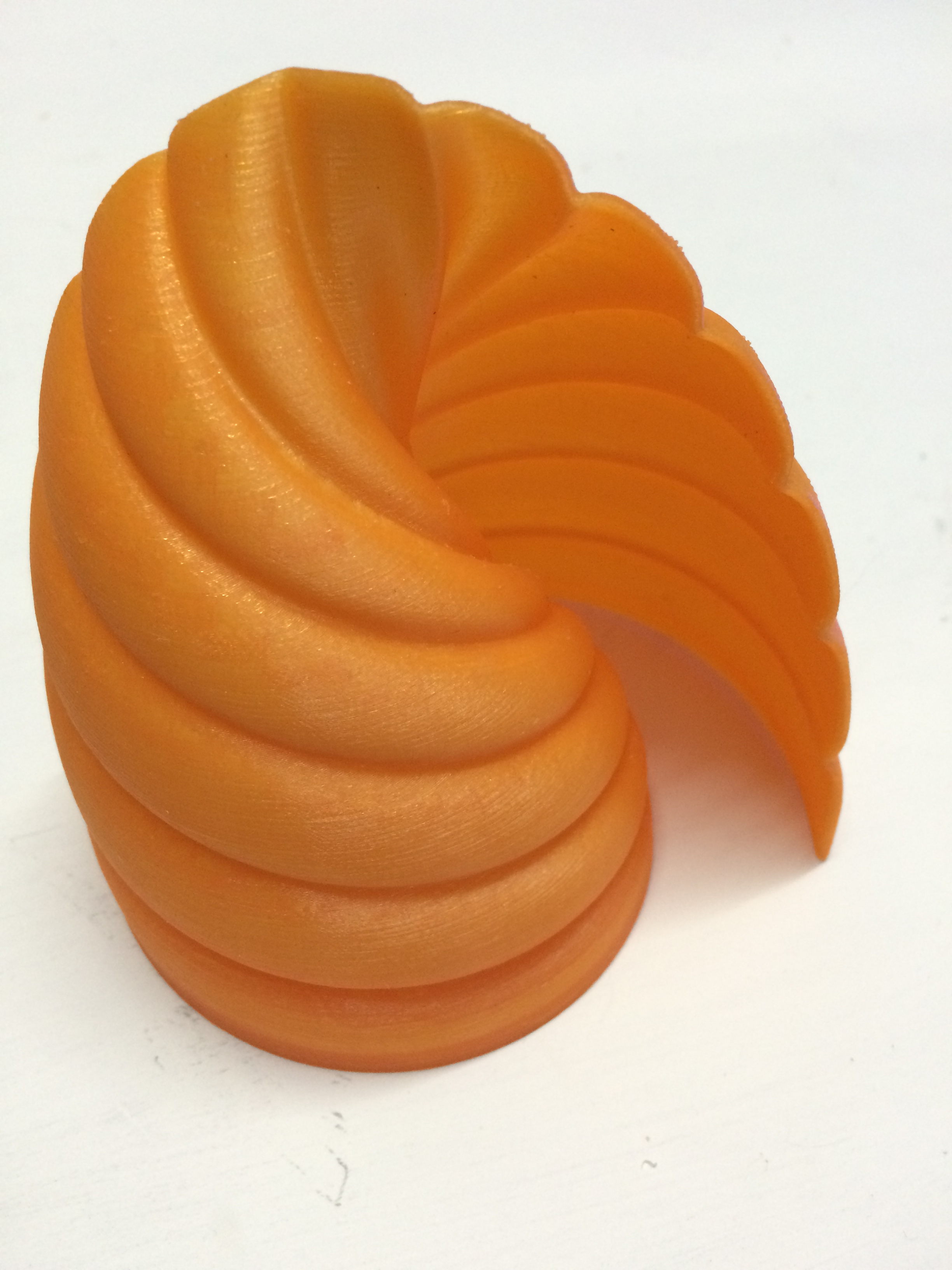

Hi, I own 3 Prusa I3’s, Zortrax M200, Deltasine Redback2, Kossel Mini, Wilson & Flashforge Creator Pro.
In my opinion if you have the dollars, I would definitely buy a Flashforge, best out of the box printer I have seen, you have to put a couple of things together as they are packed very well.
My concern with the creator pro is that because of the box it would be very hard to upgrade. Seeing so few post or videos of people upgrading one made me start thinking about the prusa i3 in the first place. Can you share any insight into upgrades and or extensions on the creator pro? is it even possible to extend the print volume due to the box?
Only upgrades I have done to the Forge is Active Cooling Fans and Flex extruders, so I can do flex, not sure if the new Forges have these pre fitted.
Obviously you cannot upgrade out of the limits of the box, so yes, limited.
Prusa’s are fantastic if you DIY you learn a lot along the way, and it does not take long to build one at all.
The Picture I uploaded was the very first print from a new Prusa I3 I had just built.
