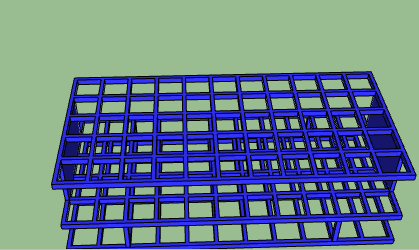

What is the best print software for designing stuff that looks somewhat like this:
The “racks” I am designing will probably be more complex than the one included but that is a good idea of what I am referring to.

SketchUp’s free version is good enough for the most part. You can start with that one to see if it meets your needs. However, free version is meant for personal work. If you need to do commercial work, you will need to purchase the Pro license.

My designs are usually quite simple and your grid would be quite simple to draw.
