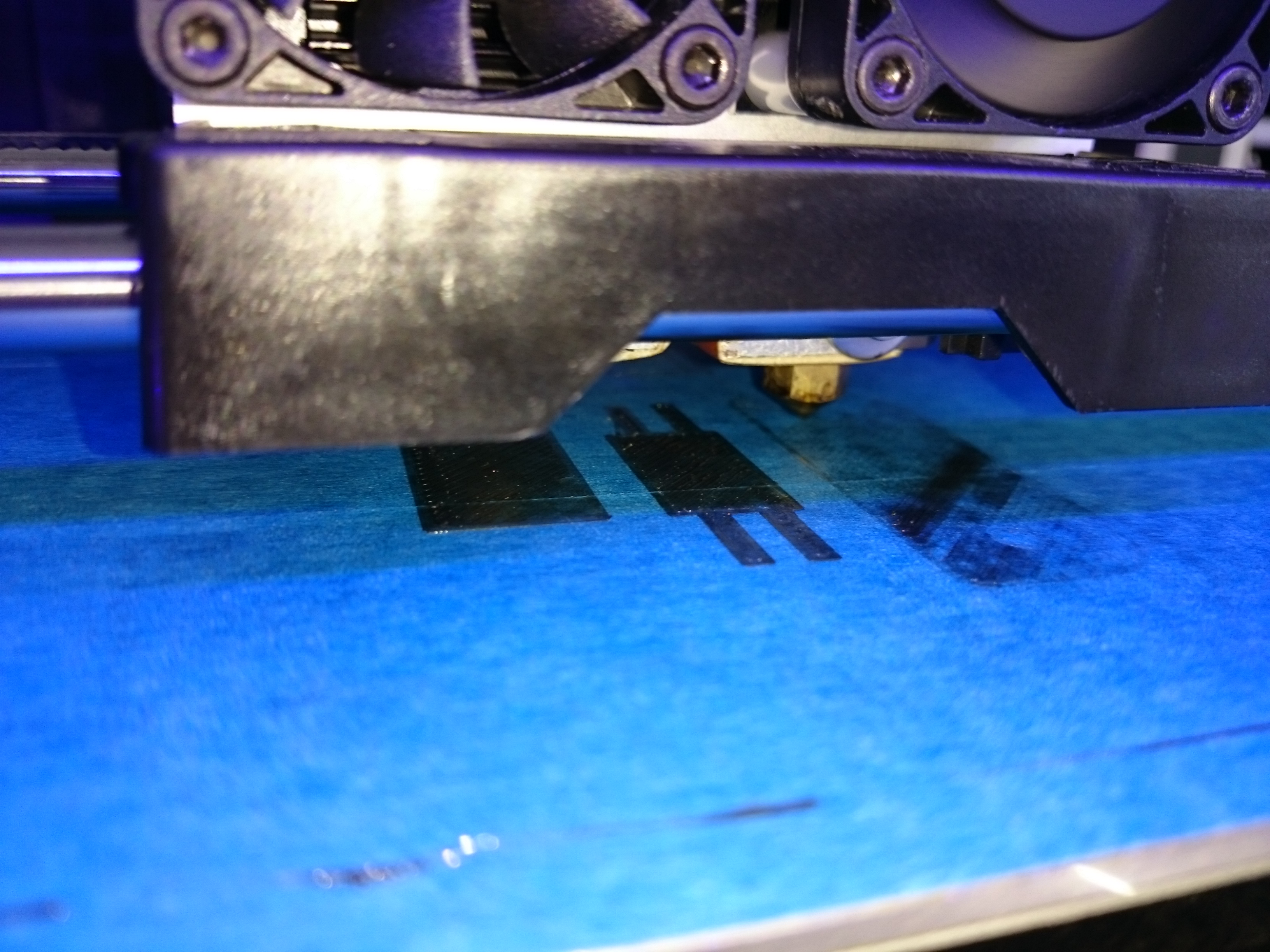

My prints generally turn out O.K but I always have a problem with the 1st layer. As you can see in the pick some of the objects 1st layers are fine and other barely print at all. There doesn’t seem to be a pattern to this either. If I print just a single object part of the 1st layer will be fine in some places and in other’s will be very thin.
I am using Simplify 3D to slice and the settings I have for my PLA are:

Is the extruder motor clicking when I started printing the part that is missing the first layer?
Yes the extruder motor does click but not sure if it’s when it’s missing the parts of the first layer. The motor clicks but not constantly during the whole print.
Are you printing onto the aluminium build plate? If so check its not warped and making high spots causing the nozzle to be to close to the bed causing the pla not to extrude
I have had a look and the print bed appears to be level. I have taken a video of the printer printing while clicking. The file is here:
https://dl.dropboxusercontent.com/u/71489447/2016-09-28%2010.48.10.mp4
If the extruder is clicking on the one with the thin first layer then the nozzle is too close to the bed which was my first thought.
Without changing anything move all the prints to the left about the distance of one item so the thin print is in another area and see what happens. This could help to determine if the bed is warped or out of level going to the right.

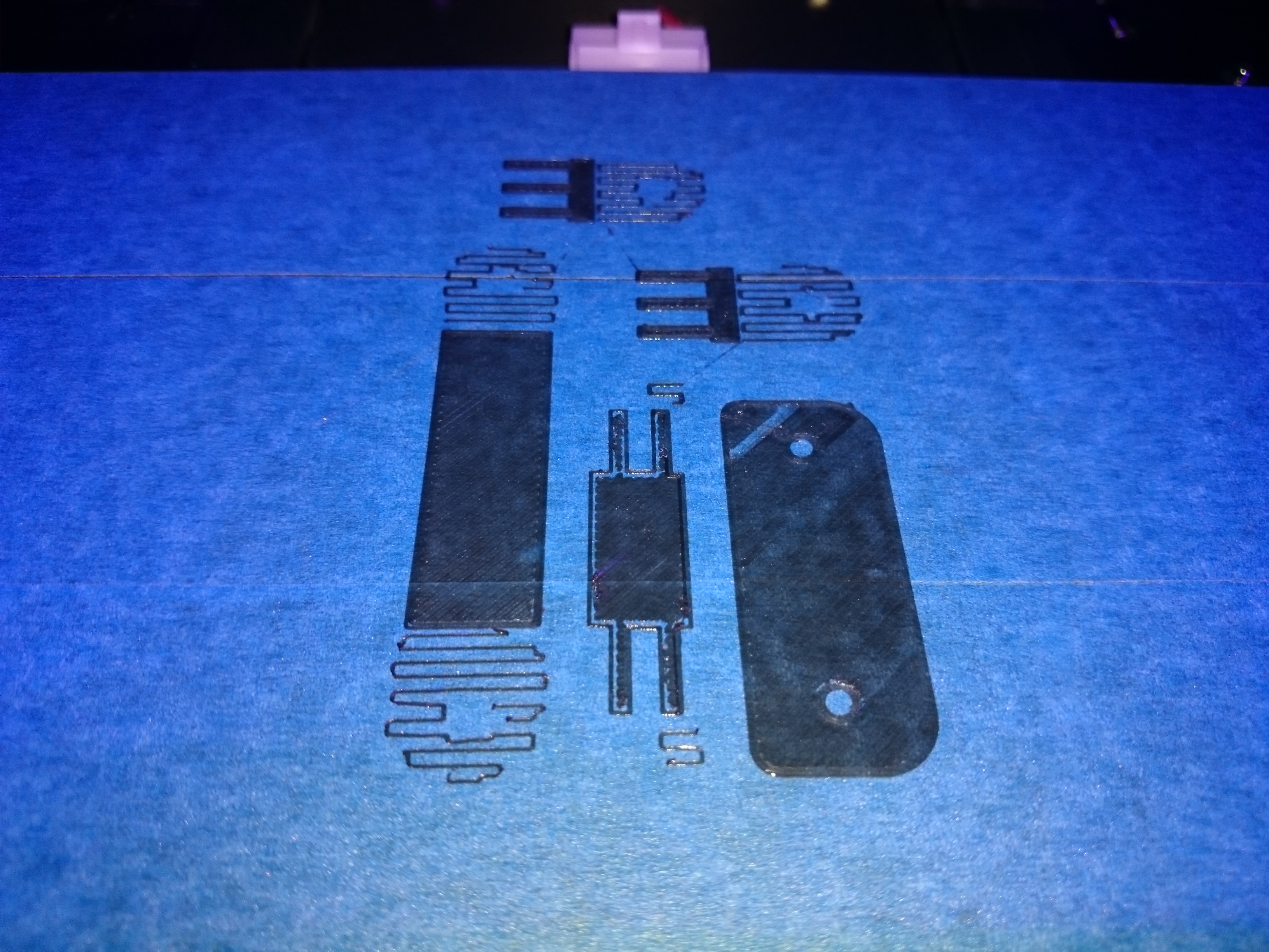

I got my dad’s set square and his feeler gauges today (So glad he didn’t bin them when he retired) I checked my build plate and it’s not warped so first part all good. I then ran the level build plate several times and used the .10 on the feeler gauge, then I did as you said moved the hot end about and checked and it was all the same gap.
Next, I heated up the hot end and build plate and ran the level build plate again and all was fine. I have ran the same print again and stopped it at the first layer as you can see in the pic it’s a lot better.
The only issue is I still get the click and it sounds like it’s coming from the newly printed guide I did. The gap you see in the pic is when I pressed the spring arm too far in and stopped it extruding mid print. However when I put pressure on the spring arm the clicking stops, even just the smallest amount pressure on the spring arm stops the click. However, with the clicking, it still seems to put the first layer down better than before.
When you put that ‘smallest amount of pressure on the spring arm’, are you compressing the spring, or extending it? If you are compressing the spring, that means you are putting less pressure on the filament and on the stepper motor. It could mean you need to increase your temp to allow the filament to flow easier. If you are extending it, it could mean you need more tension on the spring, so put a thin piece of cardboard or something under the spring to give more tension.
I am putting pressure on the spring to compress it. I will try tomorrow with higher temps and let you know how I get on. I am also going to test just loading the filament and letting it extrude into thin air as well.
Higher temps didn;t make any difference and the clicking is still there. However, the prints come out better than before thanks to the help in getting the bed level etc.
