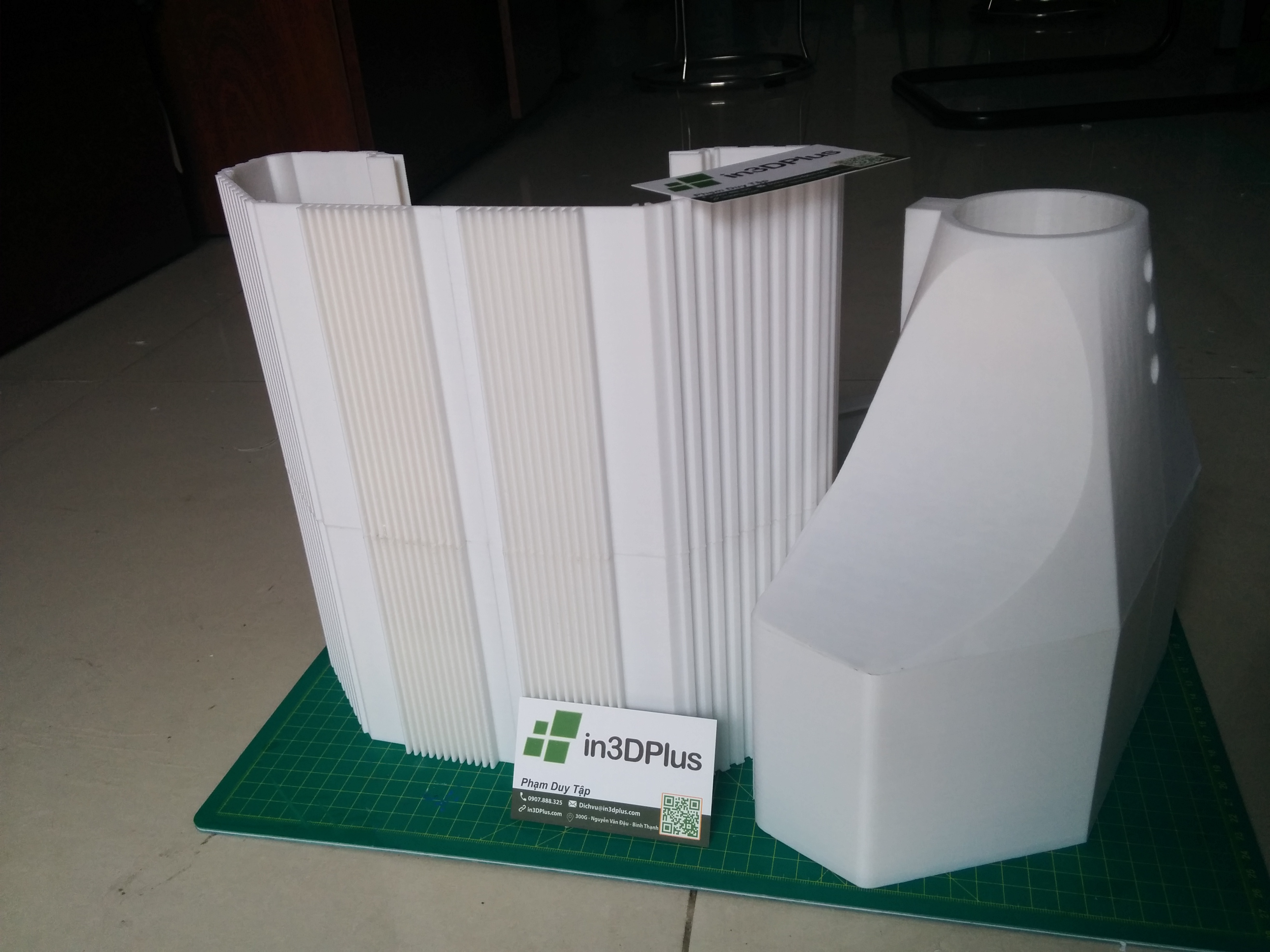

The main point here is " Try a better setting in 3DPrinting programer"
I used to print some things like that box. And it worked well with PLA fillament ( I bought from Nhựa in 3D PLA )
You can try these setting:
- 3 wall shell
- 100 % infill ( for smaller size box)
- change the wall thickness to 1,2mm or 1,6mm ( or any value that multiple x0.4mm , 0.4mm is the nozzle’s diameter)
Another helpful way is using some coasting material, like: AB glue, Silicon ,… to appetite
