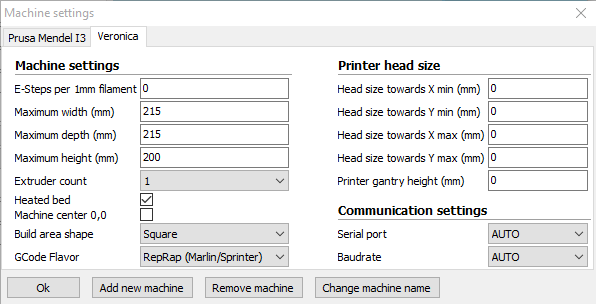

Sounds like you need to modify your machine settings.
This is what my machine settings looks like (the link below). I called mine “Veronica” HAHAH!
I really hope this helps!
![Newer snip.PNG](https://www.3dhubs.com/talk/uploads/db5060/original/3X/2/7/2789cea424def80ba1e4a4ac9c5244322f0557fa.PNG)
