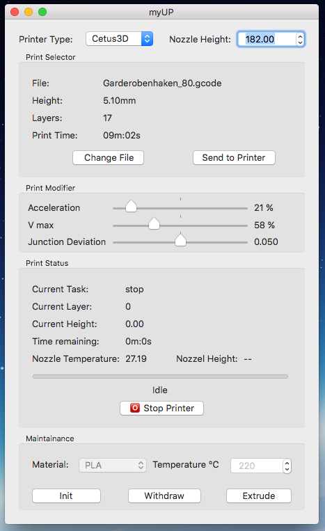

There is now a new transcoder version available which allows for acceleration and speed control. This version includes also a alpha release GUI fronted forOS X.
See details here:
