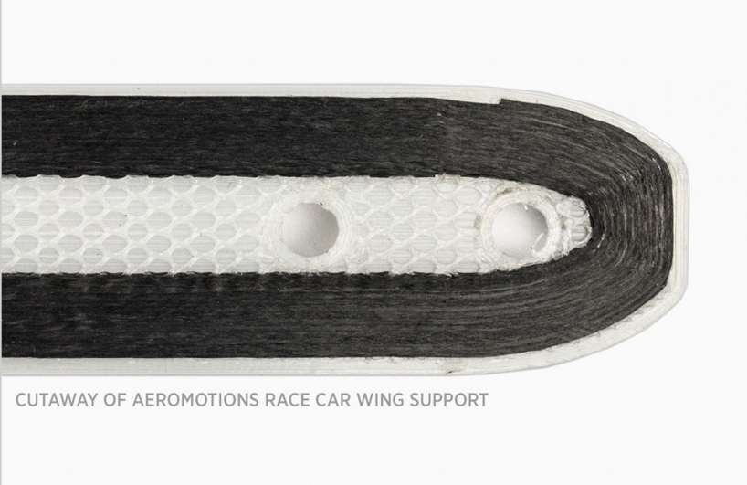

Carbon, Glass & Kevlar fibre melted down to 260-290C can hardly be too ‘stiff’ can it?.. the concept of 3D printing with something like carbon fibre generally speaking is an anathema… carbon fibre products get their strength from the weave & layering of the fibres bonded by/within resin which in turn gives the beautiful patterns on traditional carbon fibre products… hence the term ‘carbon fibre’.
However if carbon 3D filament is laid down correctly within the confines of another strong 3D printing material rather than using traditional resins it does indeed act like a reinforcing and rigid fibre style alternative… encased by nylon regarding the MarkForged printers. This 3D printing concept relies therefore on printing in long bonded lines to achieve something close/near to what/how traditional raw carbon fibre is woven/made/produced/prepared to function as a super strong engineering type material which in turn is then manufactured into a multitude of shapes and sizes.
The MarkForged printers have therefore been designed to deliver this conceptual dual 3D printing/Carbon Fibre production/preparation which necessarily limits/governs how these printers actually produce finished 3D prints… damn clever but is it really a ‘carbon fibre’ 3D print or just a smart ‘smoke n mirrors’ alternative using both carbon and nylon printing filaments which look, feel and function well when printed together?
Buy one and you’ll find out… just don’t bother with the MarkOne though cos it looks like it wasn’t very useful. (oops… he has bought one… no offence intended
Last couple of points… I always wondered why they didn’t have the carbon filament layer in a weave type pattern on the MarkOne… would have at least looked more convincing… and why no black nylon filament alternative?

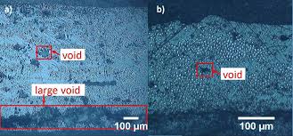

link to Academic research paper here regarding structural performance or more appropriately perhaps… lack of enhanced structural performance regarding the Mark One carbon prints if anyone is interested…
Thanks for the link to the paper. I don’t see in the paper where it drives you to the conclusion that the fibers are not continuous. There was one specimen where they happen to catch the beginning/ending of the fiber path in the test area. Makes sense that they would see lower results with that discontinuity in the test gauge area. They did measure the fiber volume % at 34.7%. For sure that is low for an optimal carbon composite which would be more in the Vf%=55-65% range. 34.7% is still respectable. And their modulus and strength correlated to T300 which is a very common standard modulus aerospace fiber…think fairings and control surfaces Not a bad paper for what was clearly put together by undergraduates. Not quite the level of testing necessary to be able to actually develop a statistical allowables database to be able to design with a reasonable margin of safety.

You are correct… they did observe some microscopic continuity but hardly the point when all the ‘voids’ they found are also noted and even if this research was for their first degrees (which it isn’t) you would still have to concede that this very informative and thorough scientific research report does not support ANY of the Markforged marketing hype… particularly regarding structural integrity… the concluding 6 carbon layer tensile results were actually appalling when compared to traditional carbon fibre products… and to claim that MarkOne prints are comparable to metal in any way at all is clearly reprehensible after reading this report… but hey if you want to believe otherwise… why not… you paid more than $5000 for the privilege of self delusion so its clearly your prerogative? Personally… I’ll be steering well clear of ANY MarkForged products… once bitten twice shy!
One last question… if you print and sell a load bearing product through your hub… whether you knew what it was going to be used for or not… using your much hyped Mark One and it failed catastrophically… do you think MarkForged or even 3D Hubs will be held responsible… or do you think it will be you who will suffer the consequences?
The voids did not surprise me. I think you would find significant porosity in most any FDM part under the microscope. Would have been interesting to also see a more zoomed out view. Guessing there would be significantly more porosity between the courses for each fiber bundle. That level of porosity wouldn’t impact the performance all that much parallel to the fiber direction. 2-3% porosity is usually kind of a magic number where the matrix dominated properties (shear and transverse strength). Eyeballing those photos look to be less than 5% not bad for a process without an autoclave or press.
Failure at tabbed areas of the thicker coupons probably has more to do with how they chose and prepped the tab material. Coupon alignment in the load frame and the stress discontinuities where the tabs terminate will also cause low failures. Add to that grip damage and their higher variability in the 6 ply coupon probably has more to do with the test than with the material. Even on the low end the ply modulus and strength were significantly higher than say 6061-T651 (aluminium to you). Average modulus was about double 6061. The strength ranged from 370 to 520MPa. That is much higher than the yield strength of 6061 at 276MPa. You could still probably match the stiffness in laminate form with multiple ply angles. Strength might be a bit less in the laminate but that would really depend on the ply orientation stacking sequence. So their marketing material stating you can get stiffness similar to aluminum is still accurate. I am still holding out hope that Markforged can update the settings on the Mark One to allow multiple ply orientations with Carbon. I hope you were not under the illusion that printing with the Mark One/Two would give you isotropic performance like a metal. No composite can do that. The properties are always planar and highly tailorable.
