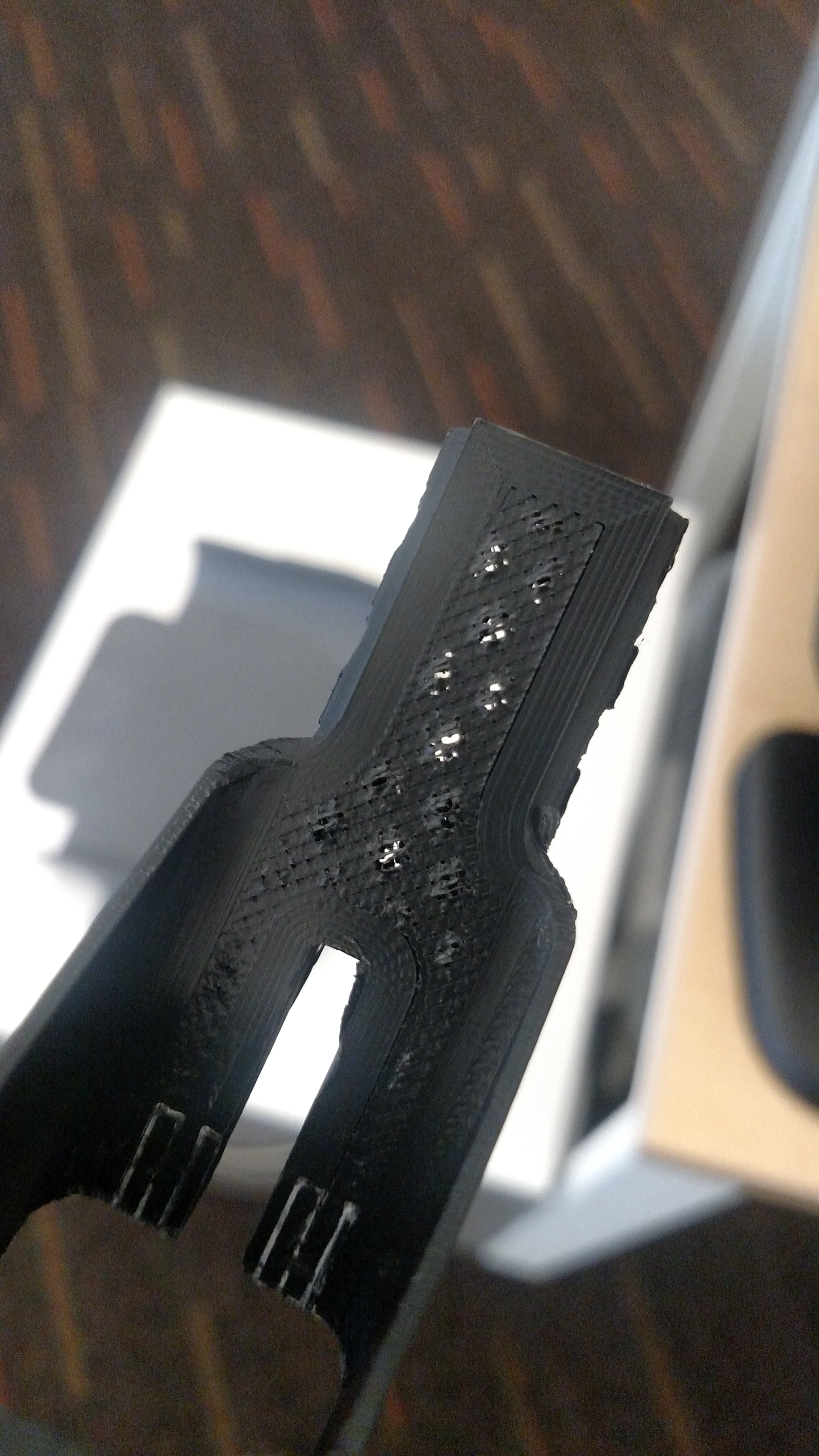

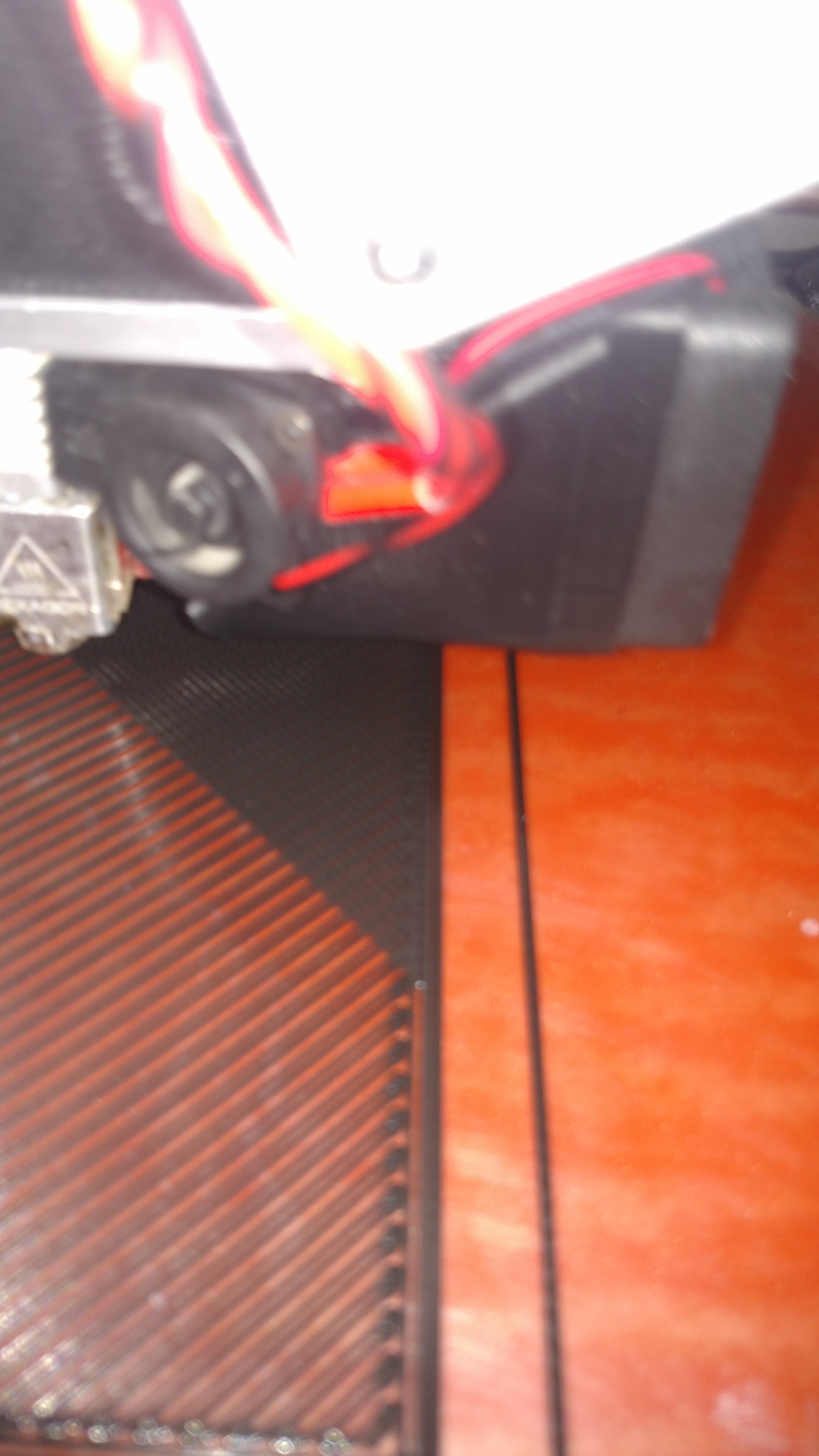

Just purchased Simplify3d to run my Taz 5 printers and I must say, the prints are fantastic HOWEVER for some reason it will not print the first or last layer properly??? In the pictures you can see it’s incomplete and almost looks as if its printing every other row??? Any advice would be greatly appreciated.
Hi @jv550510 unless I’m mistaken, the Taz 5 has a minimum printing height of 0.075mm (75 microns); your settings screenshot shows a layer height of 50 microns and you’ve asked for a first layer at 85% of that (42.5 microns). Essentially, you’re asking the printer to print way too thin a first layer. The first layer thickness is really important and sometimes it needs to be thinner than the rest of the print (when the rest of the print is relatively thick layers), sometimes it needs to be thicker (when the rest of the print is very thin layers). For a 50 micron print, I’d actually recommend setting your first layer height at around 150 - 200%, maybe even more, but whatever you choose, your layer height can’t be lower than the spec of the machine (so if it is 75 microns, that’s the thinnest you can print at) and the first layer at this height can’t be less than 100%. I note that the profile name actually says “100 microns”, so you’ve modified it to below what the printer can achieve.
The top layer problem is something else. Was that print done under the settings in the screen shot? That doesn’t look like 4 top layers, it looks more like 1. It could be not enough top layers, maybe a little under-extrusion.
Agree on the first layer. Really thin then thinning it more. To print that low for layers the machine is going to have to be set perfectly.
Top layer could be that there are not enough top layers for the infill percent.
The first layer problem looks like it is because the first layer width is set to 200%. 200% means that it IS printing every other row. The bigger the number, the more that gap will increase. Change that to 110% and run the print again. I think your layer height is actually fine.

Your problem on the first layer with the gaps has everything to do with that “First Layer Width” Setting of 200%. Change it closer to 100%.

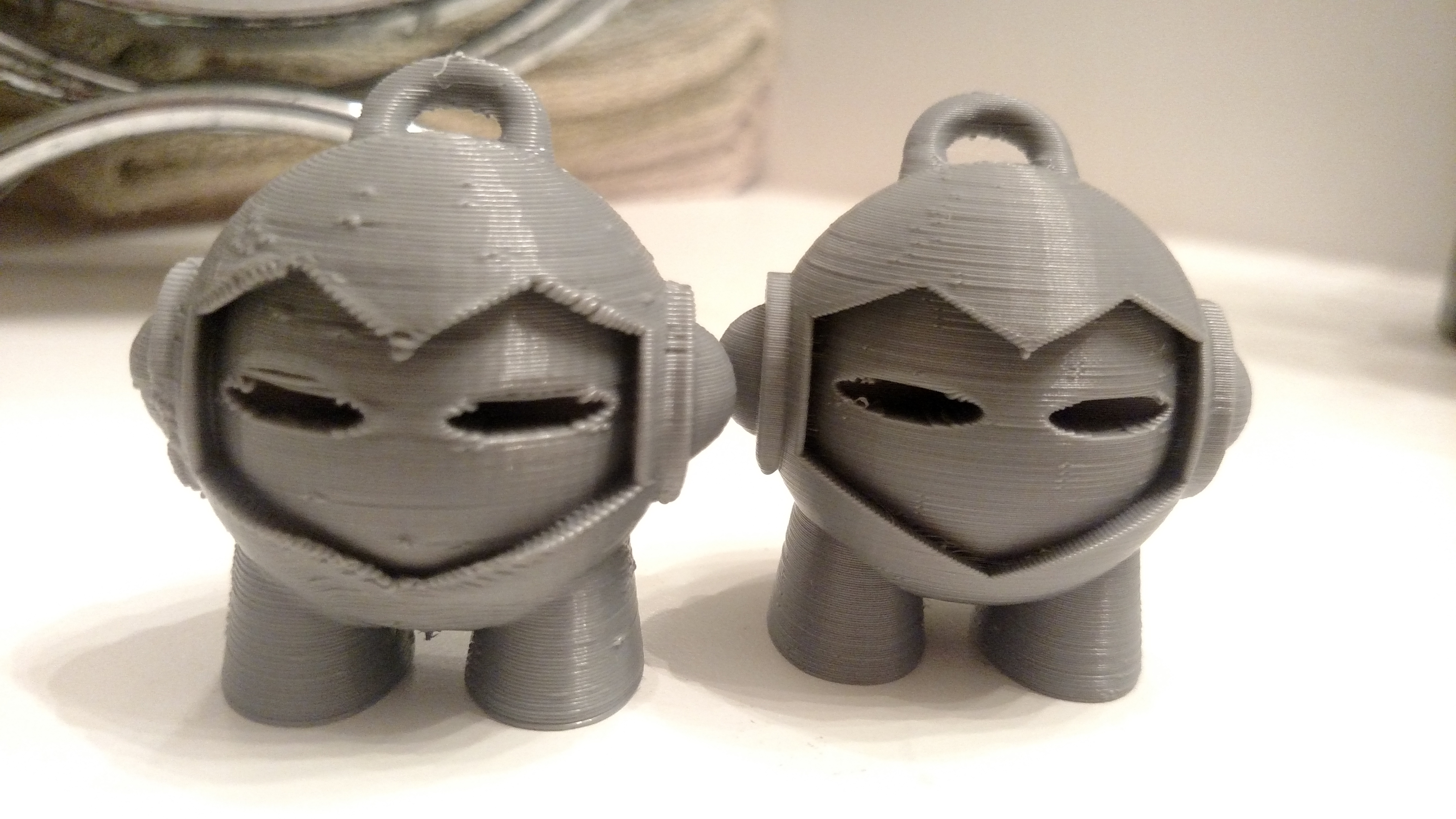

I’ve attached a few pictures below if you’d like to see the comparison between The Marvin printed on the Cura software (left at 180micron) vs S3D (right at 150 micron) and both from the exact same printer and spool of filament (cheap Inland 3mm silver). Fortunately for me, the issue I’m experiencing doesn’t affect the sides for these rounded prints so I’m not totally out of operation!
Again, thank you for your time!
Everyone, thanks for the replys.
Current word from Lulzbot Support (thus far much better than S3D) is to update the firmware and see if that resolves the issue since the underextrusion/line spacing is only on the top and bottom layers. With some luck, my parts won’t look like kitchen strainers anymore!
Attached is a photo from last night. 50% infill, full honeycomb, and 4 layers top and bottom. Transparent part lol. Although other details are masterfully done!
Did you try changing the first layer width from 200% to 110%? That should fix your first layer problem.
I have not yet changed that setting for the first layer but I will this evening when I get home.
Outside of the first layer problem, there should still be 3 layers above that and then 4 more layers on the top. I would assume that regardless of that “first layer width” setting being incorrect, I’d think the remainder of the print should be solid enough to prevent to prevent the part from being transparent. I hope you are correct tho. I’ll test this when I get home and update everyone as soon as a solution is found. Thanks again for your time and help!
That top layer is pillowing. Google it, not uncommon.

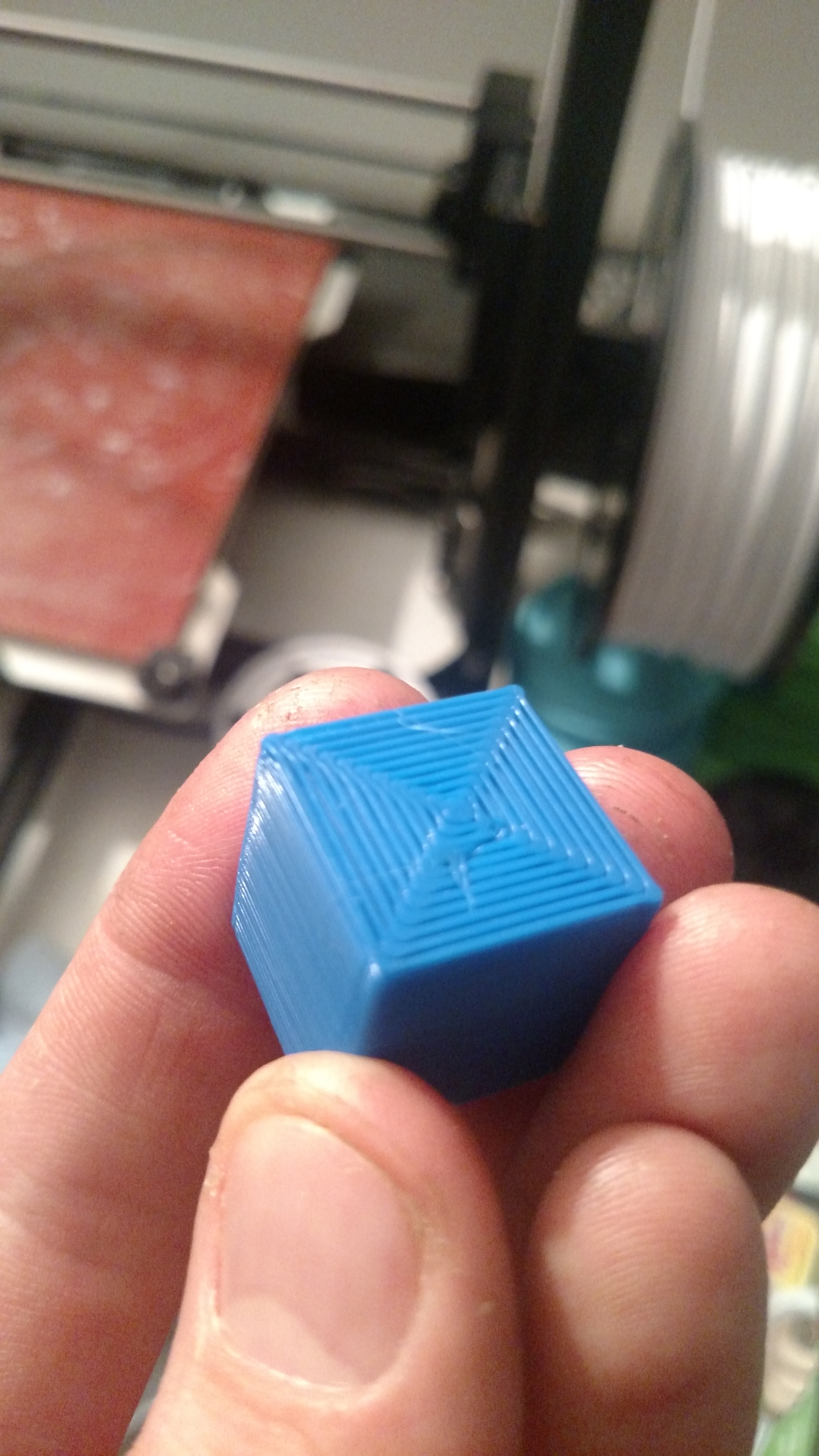

Afterwards, I was tinkering around with some 20x20x20 cubes for the extrusion and other settings. As DesignGuyJared pointed out the layer width setting, this refers to the bead size. Basically S3D multiplies the extrusion as the Width setting is increased, very misleading comparing the name to the description. My settings and results are posted below…
Resolution: 300 micron (sped up the printing process for testing)
Layer Width: 150%
Layer Height 100%
Extrusion Multiplier: 1.15
Speed First Layer: 60% (of 50mm/s)
Print Pattern: Inside-Out
This give me the results in the following picture. Almost spot on in Length, Width, and Height. Excellent surface bonding. The only thing I did now was lower the Z stop by a 1/16 of a turn for a little tighter first layer.

The problem with the top is your top layers setting. when printing 50 micron layers, the 4 top layers only give a 0.2mm top shell. I tend to run 8-10 top layers at 50 microns to give a top shell of 0.4 - 0.5mm thick. This reduces pillowing and any other artifacts from bridging over the infill and will give you a nice smooth top layer.
So divide 0.5 by the layer height and that will tell you how many top and bottom layers to use. (I tend to use fewer bottom layers because I always set the first layer much thicker than the rast… it helps to get a solid bottom layer and negates any tiny bed levelling issues.
