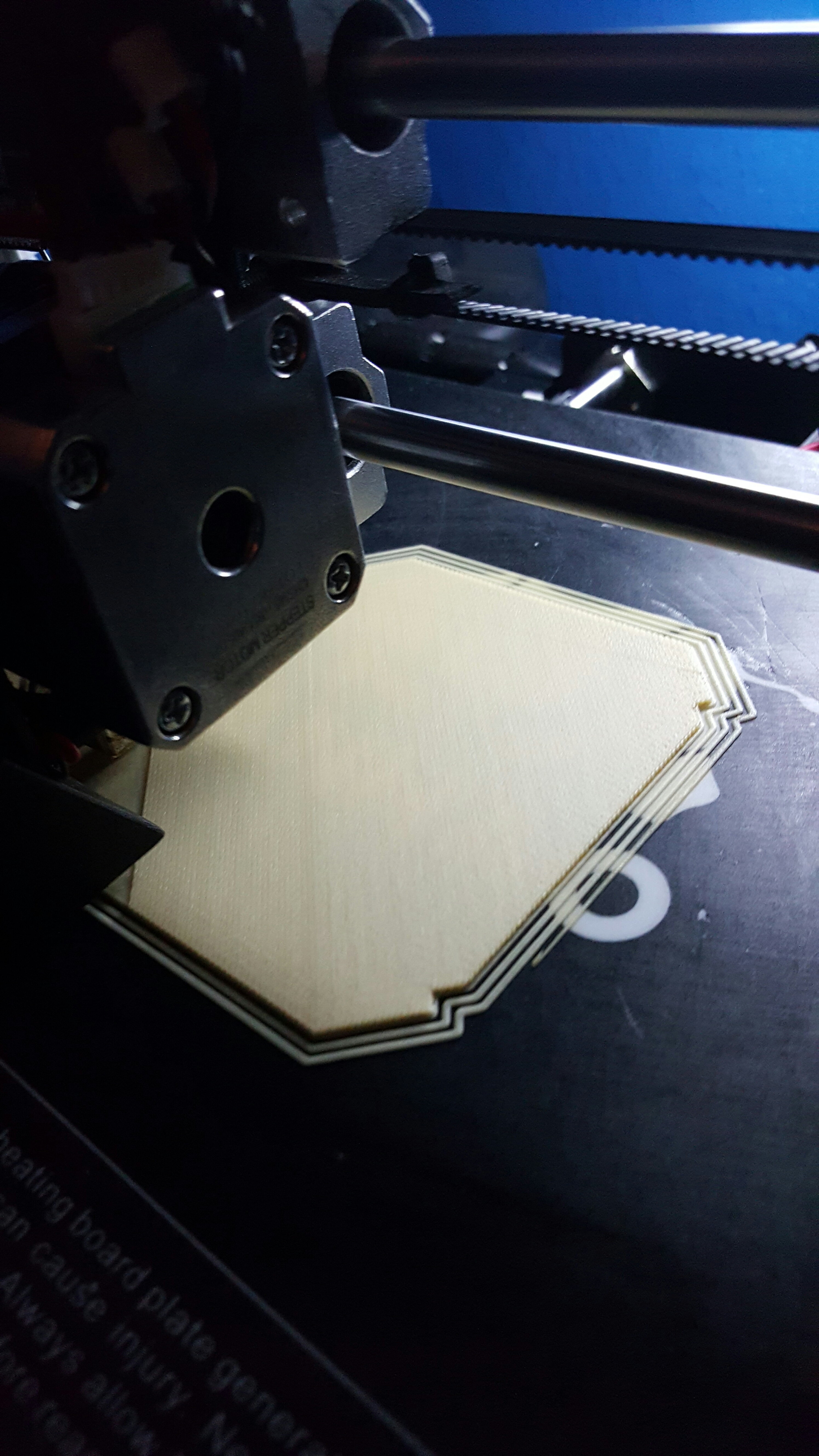

Im home Trying a new print added a raft, fiddled with a few settings leveled the printer hot and increased the bed temp to 80c looking good so far crossing my fingers
Awesome, let us know how the print did.
I will post pictures after work but this is how it went, the Raft laid down like a dream it looked perfect, then when the print started… I curled and bubbled just like when there was no raft, it makes not sense, but the difference being, it stuck to the raft, mainly because I pushed down on the curls as it did the first layer. In the end the print came out ok and my Dice tower is finally done.

Ok Pictures the first one is the raft laying down, perfection, Then the first layer same as always… Then a closeup of my extruder. Finally what I took all this time printing this week :slight_smile:
Printing my die, I changed the first layer to 90% and it is working great I really think that was my problem, I think :slight_smile:
That print looks really good. Tweak that first layer and you should be good from here on out. Nice job.
In my opinion, I think you should go with .3 for your initial layer thickness. It for some reason is what Wanhao profiles are showing. It is what I use for PLA, HIPS, and ABS, and I usually get good results. I know that the 3dprinterwiki.info web site says otherwise, but try both and see which one fixes your air bubbles.
