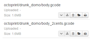

I have octoprint, it works well.
I can see a full directory structure for files within the octoprint server, while sd card files are displayed like you see in the attachment.
While on the octoprint FS each folder is a link which when clicked shows the files that are inside it, if you see the SD cart it will display items as “[folder_name]/[file_name]”. So it is hard to read and less usable.
Is there a way to make the SD files view like the FS files view?
![octo.png](https://www.3dhubs.com/talk/uploads/db5060/original/2X/b/b54ca68b75d313ec18ba58cb513d6ecc82718ee9.png)
I think for the SD card it is really going to be dependent on the board and firmware how is sees it. Some don’t even allow or recognize folders or a folder structure just the files have to be loaded at the root level of the SD card.
