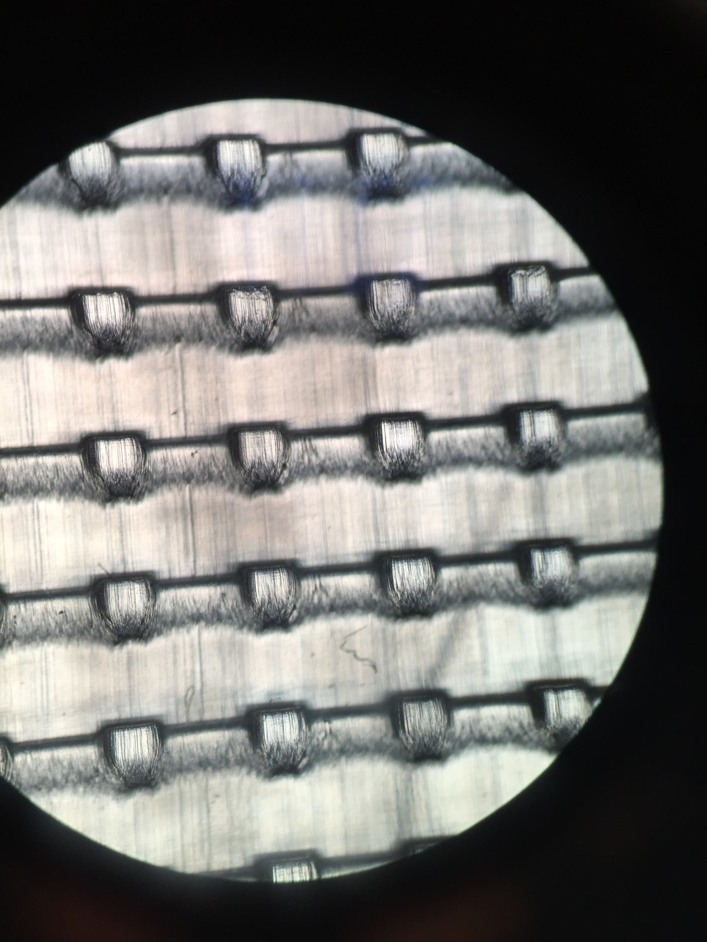

Hi! I’ve recently bought a form2 3d printer and I am trying to print a device which consists on an array of cubes (250x250x250 microns), as it can be seen in the image I have attached, there is an area in all the cubes that are diffuse, is it because it could need some support in that area? Did someone try a similar design or features of this sizes?
Thanks!!

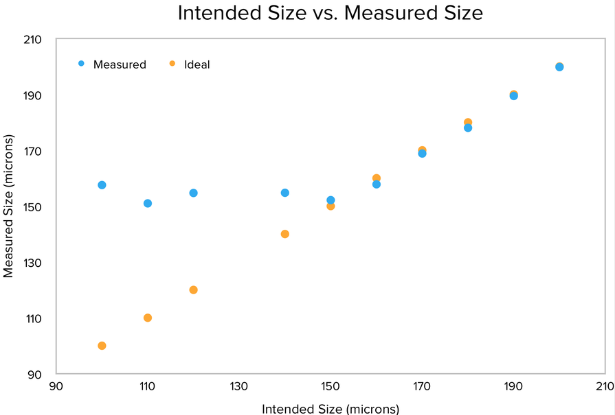

@shahramrobotics although the spot size is 140µm, the laser can focus on any point on the print bed, down to about a 10µm precision, it’s not a grid of 140µm square pixels like a DLP printer so it’s certainly possible to print embossed features like this at 250µm. Attached is a graph of Formlabs results of a test for resolution on the XY plane, as you can see, anything down to about 200µm is spot on, and 150 is darn close. 250µm should be a walk in the park and I regularly print details at and below this level.
@alexrp92 supports won’t help as the minimum touch point is 300µm - the support itself would be larger than the feature and very difficult (if not impossible) to remove cleanly. How was the model aligned on the bed? It looks like it was printed with the disk almost vertical, which side faced the wiper? Have you tried it at 90 degrees (so the “bars” are parallel to the bed)? I’d also try printing it a little flatter, say at 45 - 60 degrees.
Have you been in touch with Formlabs support? They’re usually very helpful.

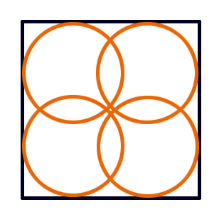

Hi @shahramrobotics I can totally understand the Photoshop analogy, however, that raises other questions (for me!) when looking at the image from @alexrp92. If we have a square at 250x250 and a spot that’s 140 in diameter, it seems to me that it should be impossible to get good corners for that square. See attached first pic. The spot could get no closer to the corners than shown, so the filled square should look something like the orange area of the second pic (assuming the “circle” is able to be positioned to 10 microns multiple times within the square). However, Alex’s image shows quite sharp corners on the left-hand side, they’re not pin-sharp, but they look a lot more “square” than fitting a 140 micron circle into a 250 micron square suggests should be possible.
Not sure what slicing software you’re using, but Preform (for Formlabs) does not remove details at this level (see final image). This is a quick mock up of Alex’s model, the cubes are 250 microns, the support touch point 300 microns.
Not really arguing here - I’d certainly agree you can’t fit a circular peg perfectly into a square hole - I’m more just interested in the tech/processes! ![:slight_smile: :slight_smile:](https://www.3dhubs.com/talk/images/emoji/apple/slight_smile.png?v=9)

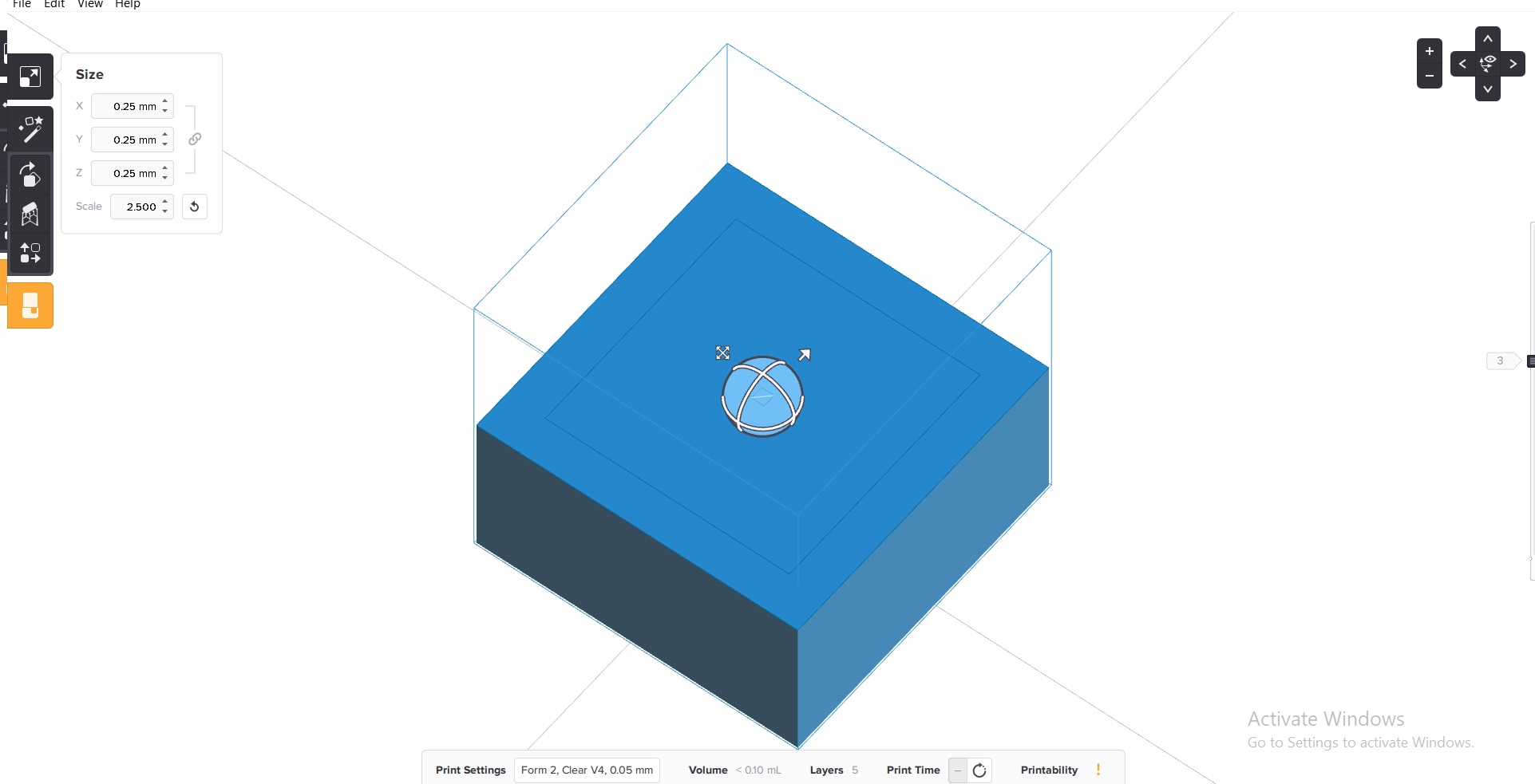

The important thing is that the laser intensity distribution is like a Gaussian kernel, it doesn’t have the same intensity in all areas, it’s stronger in the center and weaker on the edges. You can see in the attached photos the exact 250x250x250 microns cube sliced in preform. If you look at the first image you see two rectangles as the shells and one teeny tiny line in the middle as surface filling. As you increase the size of the cube (third image) the shells stay on the edges with the exact same outter offset and the rest of the model is filled by a zigzag pattern (shown as parallel light blue lines). So for the thickness of the shells you can see in the second image I came up with a rough estimation of 100 microns which makes sense, it’s like the laser spot was drawn on the blue line with ~50 microns area all around it to cure the resin. So I think in preform they considered the effective laser spot size a little less than the specs like around 100 microns. That’s why you get even better and sharper results than your calculations for 140 microns. I believe the diffusing problem is caused by a combination of uneven laser intensity distribution and the way Form2 detaches the model from the resin tank to move to the next layer. It pulls the model up while sliding the tank to the right, so the remaining resin on one side is pulled and removed but the other side is pushed to the side of the model, and specially for Alex project it quickly starts to collect the resin on one side because there is no way for the resin to go out. And of course the extra resin start to cure gradually on one side. I think he can fix that by just changing the orientation of its model.
