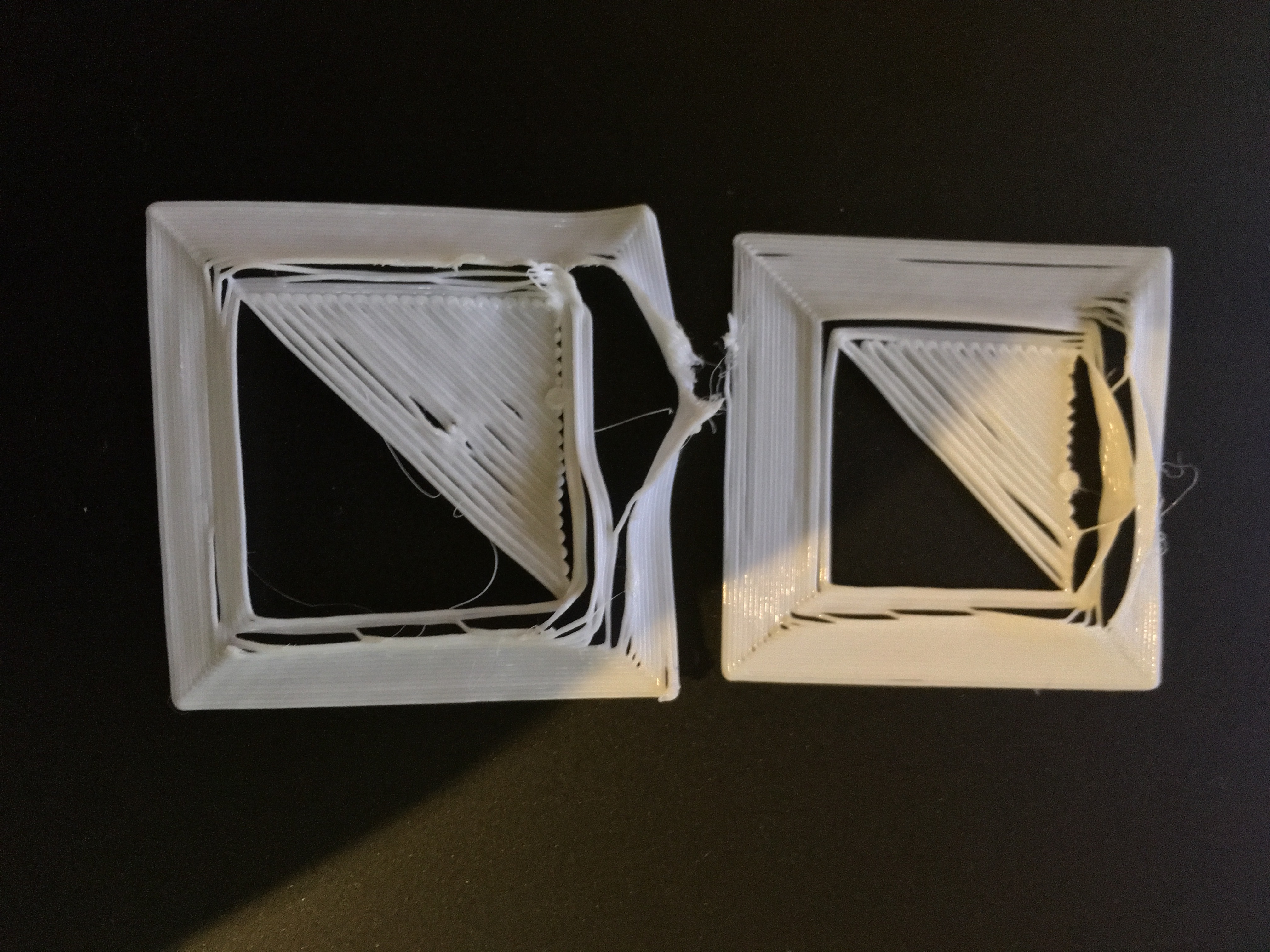

Hello i did build a custom 3D Printer. It is running Marlin with the Ramps 1.4. Mechanically it is working fine. I wanted to print a Cube. The printer does only half of the first layer and then restarts the board. I am using Cura as slicer but also tried Slic3r. I tried to printed from an SD Card and directly from Cura with the same result. I got Endstops at (0,0,0). The Internet didn´t gave results but i don´t really have ideas for keywords.

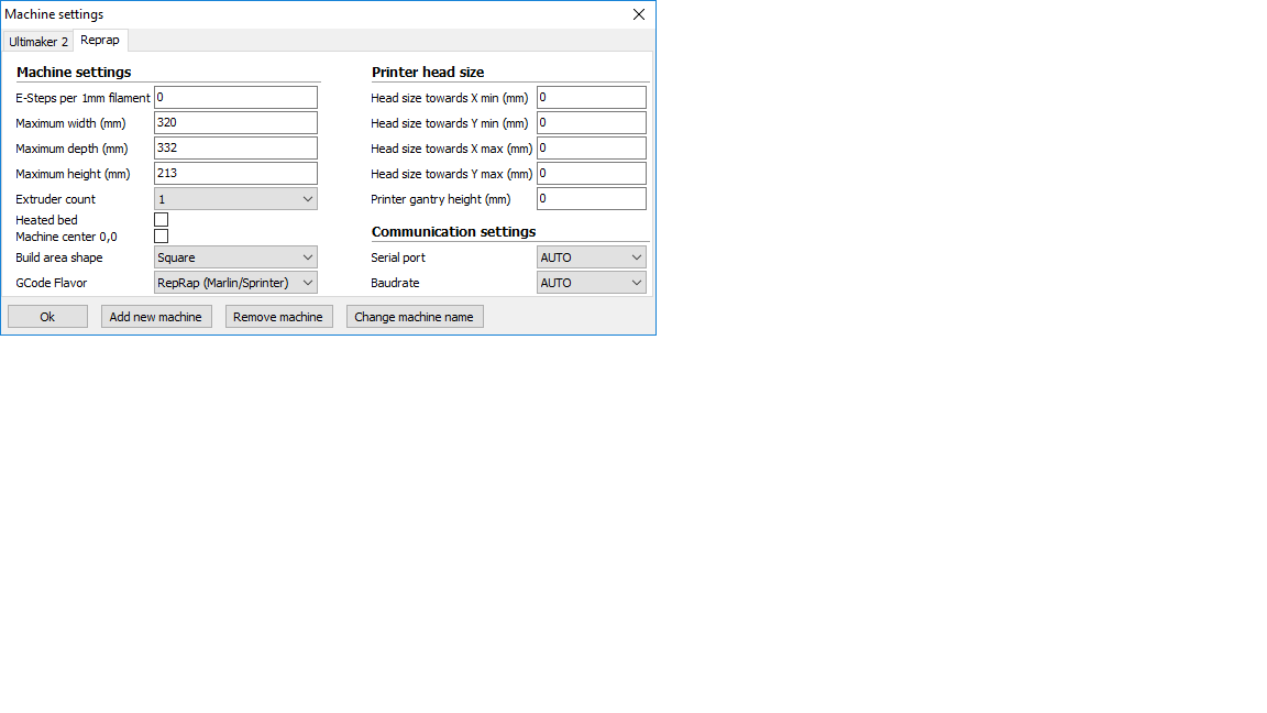

Did you try slicing a different object? There could be an issue with the STL preventing from completely slicing. Could be an error in the GCode file throwing off the printer from continuing. Did you at least re-slice the same file to make sure it was not just a poor slice. It could also be your setup of Cura and making sure you selected the right firmware type for your machine as each firmware type has some special commands that could be throwing the printer off if incorrectly setup. A remote possibility is that your power supply is dropping out (but that occurring at the same point on two prints seams a bit remote, but maybe since you only have a sample of 2). There is a grocery list of possible issues if it is a home built and this is the first run. Just need to start with the most common and talk through the evidence.
Also noticed a possible first layer adhesion problem. What kind of plastic are you starting with?

The reboot is odd. To different slicers would not generate gcode with the same error causing a reboot. You try and reflash the aurduino. Is this firmware you configured, compiled and uploaded to the arduino?
