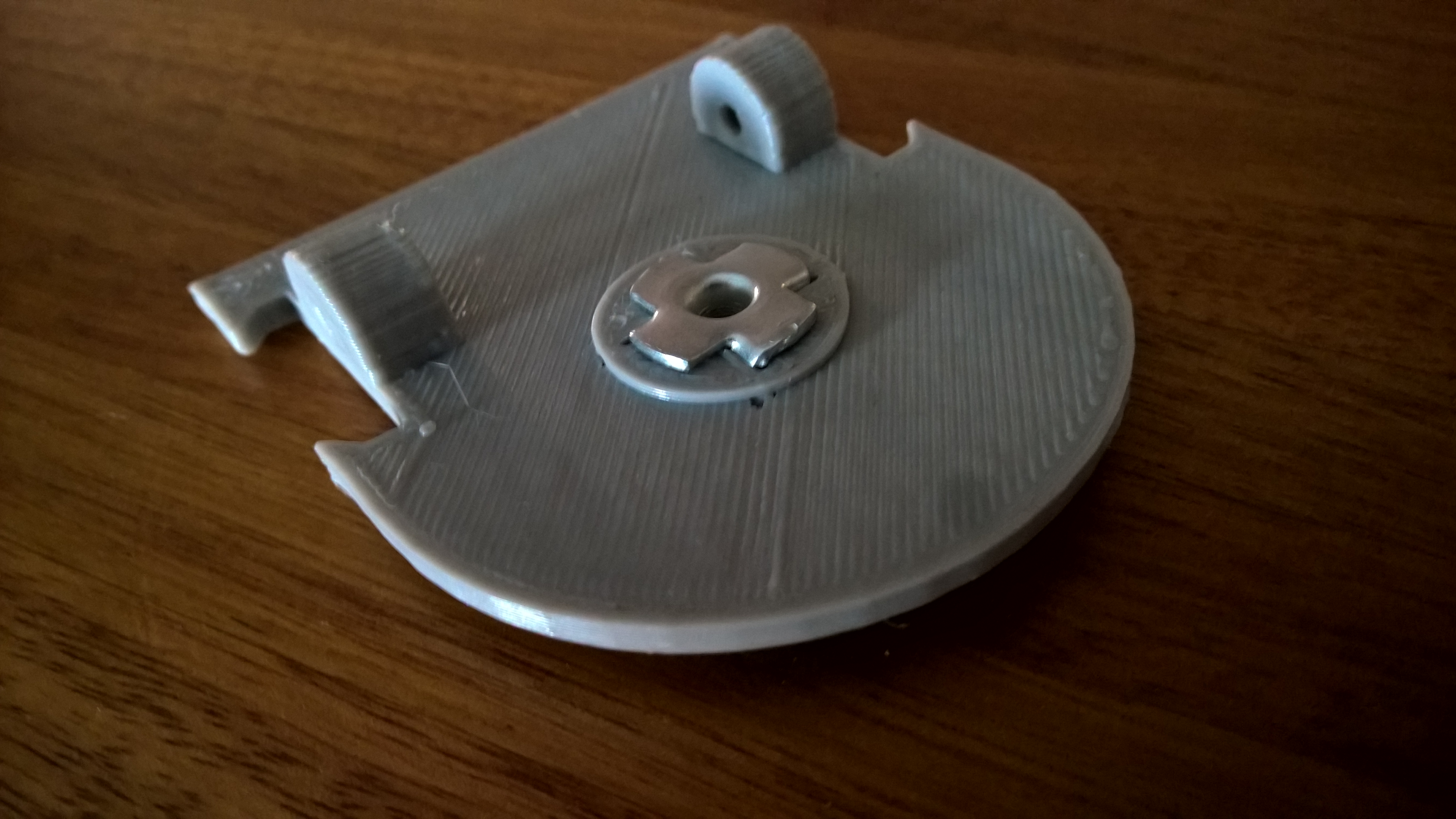

Hi, recently got a flsun kossel and apart from a couple issues it’s. Working perfectly. One of those issues is the top and bottom layers don’t seem to be joined together properly (spaces between the lines). The bottom layer is the main issues, but the top has issues as well. If anyone has some suggestions that would be great. If you need any details about settings let me know. Thanks

My guess is you need: More infill, and more top and bottom layers.
On the top, your infill is sagging downward, on the bottom, your bed is not perfectly level.

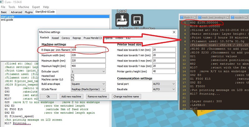

For proper calibration, I suggest to mark the filament before the extruder(50-100mm) . Heat up the nozzle and slowly extrude the filament, than measure the distance again between the extruder and you mark. Than calculate the new steps/mm value:
(Requested amount / measured amount) X current steps/mm value.
Example: You requested 100mm to extrude, you measured 96mm movement on the filament your current steps/mm value is 150 steps/mm.
The new value will be: 100/90 = 1.1111, 150 x 1.1111 = 166.667 steps/mm
Modify this value in your Firmware and re upload it, than test is again.
You can modify this value on the fly with “M92 E166.667” command so you don’t have to upload the FW after every measurement.
BR.,
Tamas
Thanks for that. Hopefully that should fix the issue. Though instead of setting it the firmware, is it possible to just set it in the software? Or is better to do it via firmware? Thanks again ![:slight_smile: :slight_smile:](/talk/images/emoji/twitter/slight_smile.png?v=5)
I would fix it in the firmware, than you can tweak it afterwards in the slicer program modifying the flow rate value.
Also you can put the M92 Exxxx -value into your slicers start gcode so it will use this value for every print, attached a picture from my cura setting and the gcode it makes
