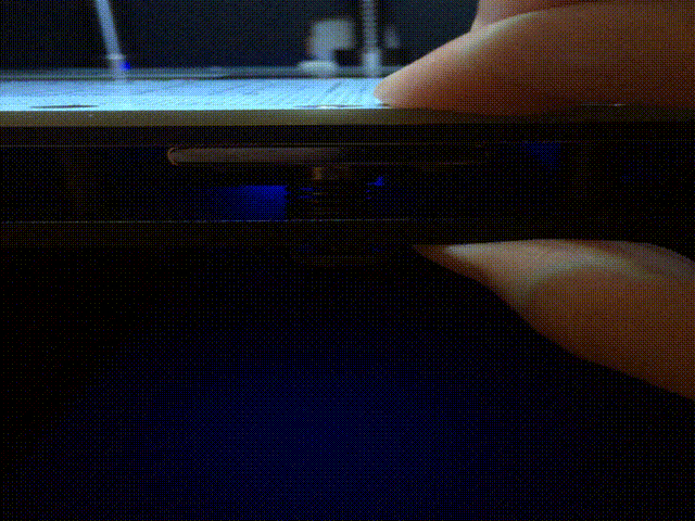

During auto-calibration, the Rear-Left and Rear-Right calibration wheels function correctly, and I can get them leveled perfectly, but the one in the front does not. I spent about 20 minutes turning it the direction the machine was asking me to turn and it and it hung on 0.23mm. I then tried loosening it and it again said it was 0.23mm. I then turned the machine off and tried calibrating it and the front plate did not move up or down.
I don’t think the front plate is functioning correctly. I would like to take the front calibration wheel apart, but there are no videos on the Zortrax Support for that.
From the screenshots you should be able to see a few mm in clearance. And, yes, I am using a business card to manually level the front plate. :slight_smile:
Not sure what to do, but I would like the front plate leveled.

What you are experiencing are the terrible thumb screws. You could either replace them but here’s a temporary fix. During calibration of the front screw, push down the plate gently while applying minimal pressure to turn the front thumb screw. You will notice once the plate is slightly depressed, the thumb screw can turn. Follow the instructions on the screen as to how much to turn. Like I said this is a temporary fix but I have been doing this for 9 months already :smiley: Procrastination at its finest

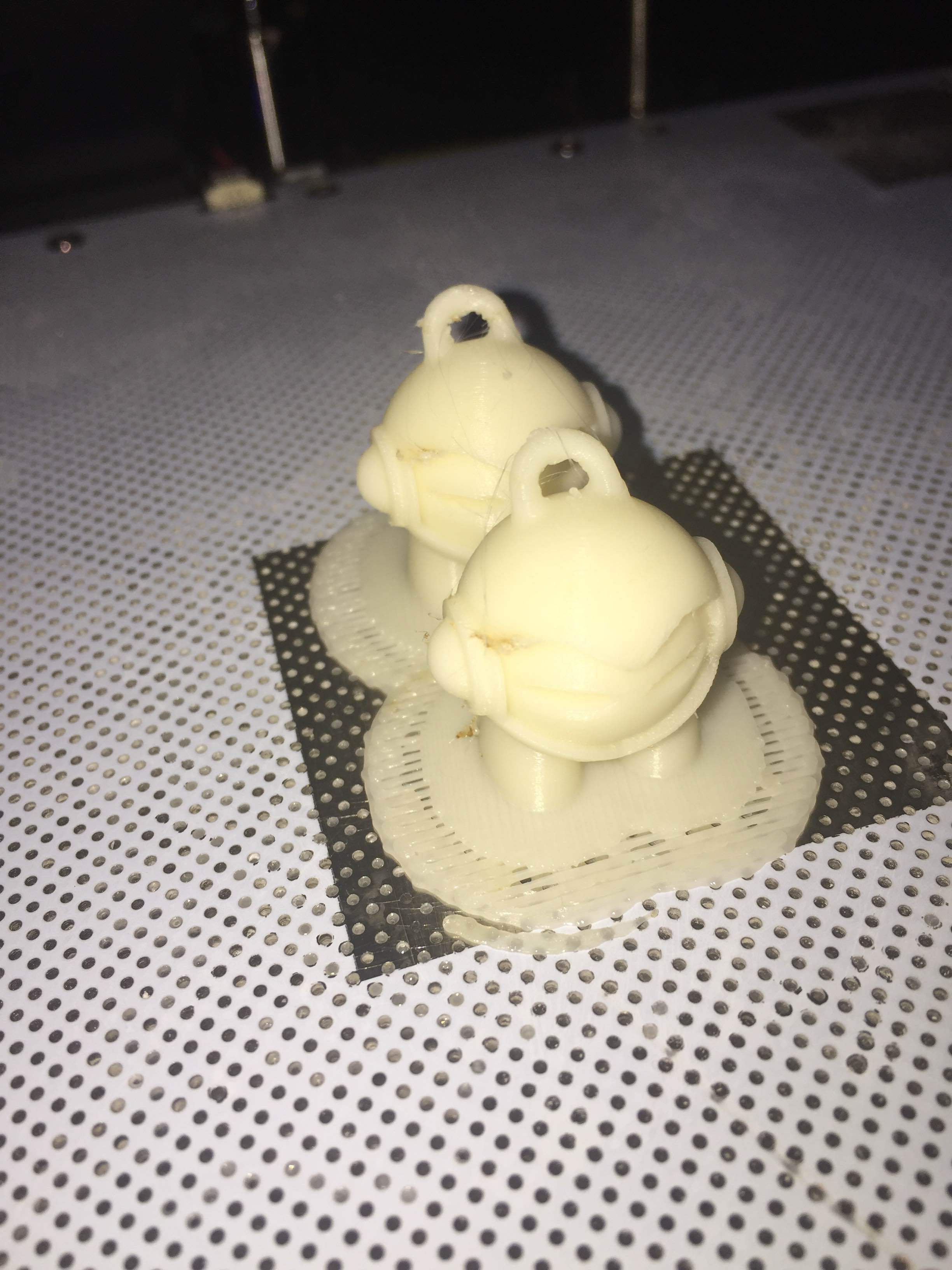

On a side note, do you know if the direction the parts are facing has an impact on how they will turn out? For instance, when I try to print the Marvin’s, if they face the front door of the Zortrax, there is a slight burning on the top left of the face. I printed one by itself and noticed a slight warp and then decided to print two together and the burn became more noticeable. I am thinking maybe because the fan isn’t able to reach this corner? I guess I read that printing two parts together can help with cooling.

@James,
I tried depressing plate while screwing and the screw just won’t budge. I think there’s something just not right with the thumb screw. The back two move just fine and when I manually calibrate with a business card, I can see the resistance increased or decreased when I tighten or loosen them, but the from screw doesn’t do anything either way.
Once the plate is off, I can see the front screw takes an allan wrench. I’m not sure what to expect when I take it apart. And even if I do take it apart, I’m not sure what will come of it.

Yes you are right, it is better to let them face right where the fan is. There are mods out there to give you a dual fan set up from both sides which can be helpful in some prints.

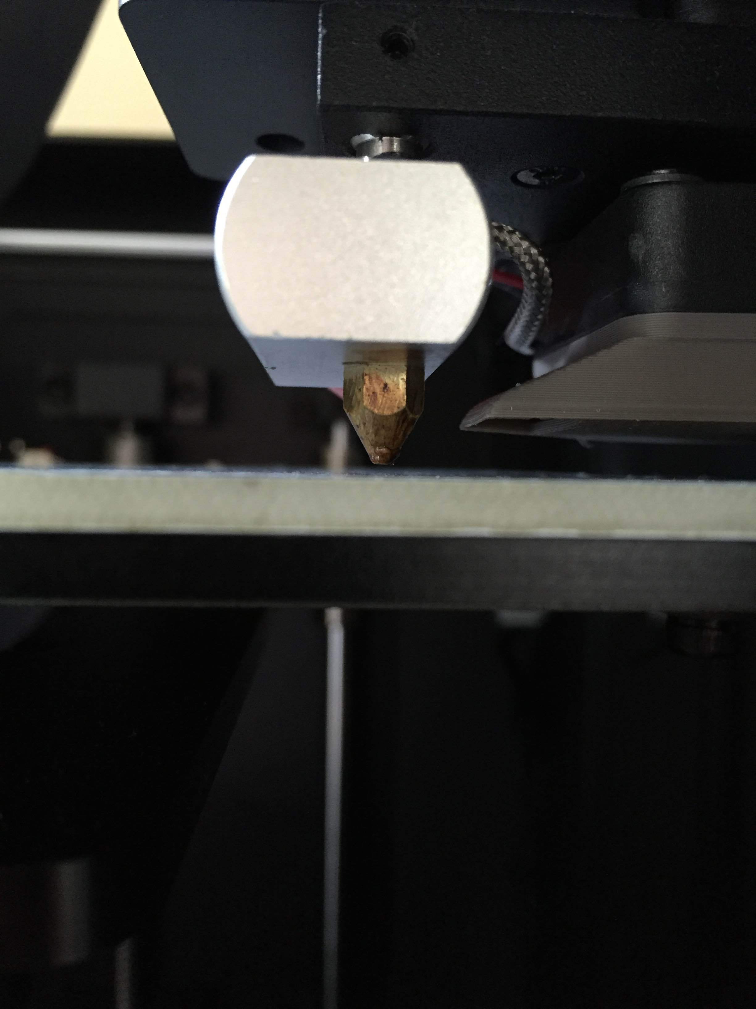

About burn marks… There are two types. One is the nozzle burning the print, another is accumulated gunk on the nozzle which turns brown and then get dragged onto your prints. In some cases it’s good to pause the print (hold down the knob for around 5 seconds) and clean the nozzle. During unpause the nozzle will purge once more, clean it with tweezers and click on the knob again.
Printing two pieces leaves some extra time to cool after each layer so bridging will sometimes have better results.

Hello Shannon,
Do you mean you can’t turn the front thumb screw because it’s stuck? Or you can turn it but the build plate doesn’t move up and down? This is an important distinction.
Don’t worry the 3D printer looks like a complicated machine when you’ve never taken it apart before. The M200 is quite well designed so you can put it back together easily. The screws and thumb screws can be replaced easily.
If you can’t even turn the thumb screw then you should definitely contact your reseller and get them to resolve it as it may be a manufacturing defect. If the build plate is not calibrated correctly, the prints will not be optimal as they should be. It is quite sensitive as you are talking about layer heights of a 10th of a millimetre.

Hi @James,
The front thumb screw can turn freely. However, when turning the front thumb screw, the plate does not move up or down.

Hello Shannon,
this blurry gif is what I meant by “depressing the plate”. More like pinching it together, this relieves the pressure on the thumb screw and you should be able to completely unscrew the thumb nut. If that’s possible it means you can use this way (temporarily) with gloves during the calibration to move the thumb screw up and down.
Worst case scenario is that you cannot pinch the plate down as the screw is fully compressed already.

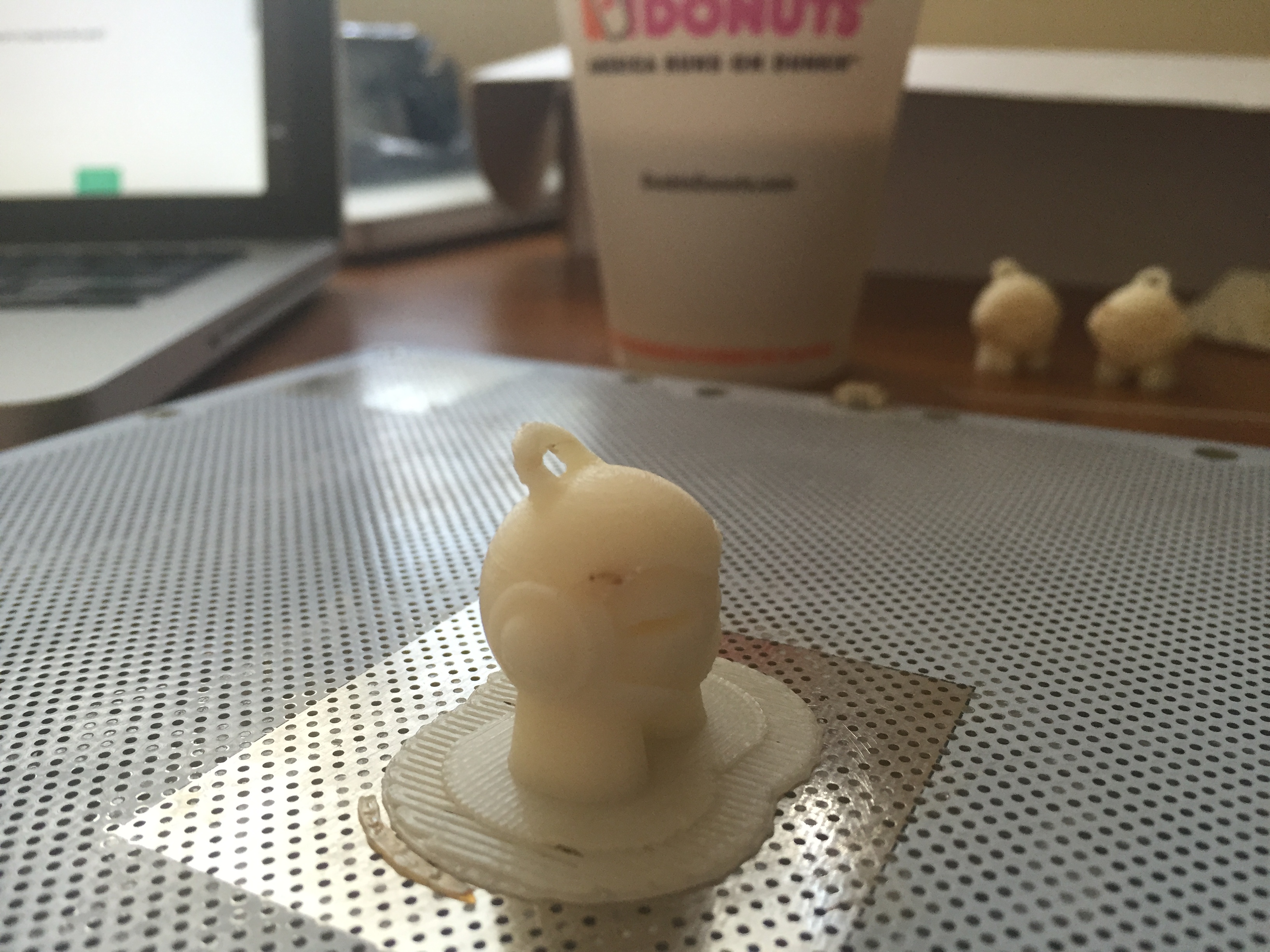

It is helpful to know there are two different types of burn marks. I turned the Marvin to face the fan and I still got the same burn mark in the top-left corner of Marvin’s face.
The Print Settings are:
0.09mm, Infill Max, Support 0%, Fan 100
The burn mark is more noticeable when the Infill is set to Maximum. Given that information, I am guessing it is the accumulated junk?
I guess I don’t really know how much of an effect the Infill has on the model’s integrity, just beyond the obvious. I set it to Max or High because I think the print will be the best quality. Would love to know your opinion. :slight_smile:

@James,
Depressing the front plate (pinching it) did the trick! Thank you!
I had to dissemble the front thumb screw to see how it works. Once I saw it was just a few pieces, I figured out how tightening and loosening would work if you depress the plate because it creates a gap for the thumb screw to travel more freely up and down.

I still havn’t solved the burn mark on my machine, I find it pretty annoying too especially on white. This is the area where we as users have little control of, I would be interested in seeing what the guys at support have to say about this. Usually I pause the print midway and wipe the nozzle using some folded aluminum foil or steel wool to keep the prints clean. Hope they can fix it either through Z-Suite, Firmware or filament.

Btw, increasing infill doesn’t affect the quality much if not at all. Unless it’s no infill then you might see a difference.
