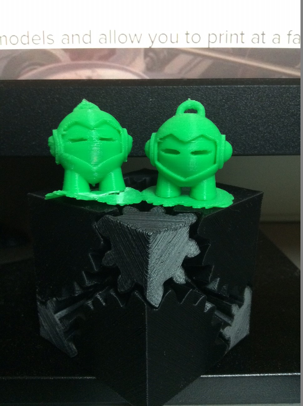

After numberous attempt of tweaking all kinds of settings (first layer height, thickness, shells, speed, heating, temperatures, etc) I decided to try ABS again last night. For some reason my ABS prints generally work better than PLA. I noticed severe warping and of course my print was ruined (like all of them at the moment).
One of the things I have read was using a custom fan, which supposedly would cool down the ABS fast enough for it to harden while not cooling the part too much. I’ve tried it with Marvin and the results were stunning, all my warping issues seemed to have disappeared and Marvin was looking awesome. All the layers stayed perfectly flat. Unfortunately half way through the print Marvin became unstuck and decorated my printer interior with festive ABS decorations EVERYWHERE :slight_smile:

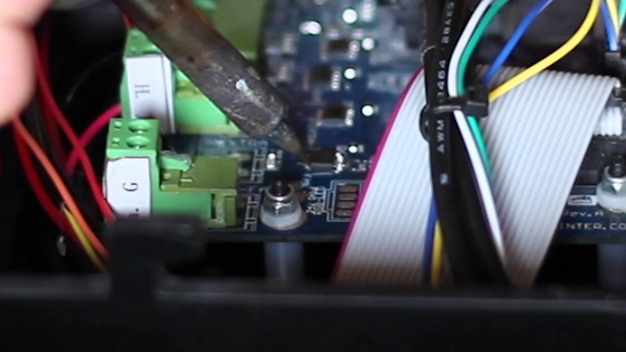

- If the cooling is optional, why didn’t they at least solder the MOSFET and Connector?
- How does one control the fan via the Mightyboard?

Hi Joe,
Thanks for the info. You say that for ABS the extruder fan should be off, but this is not my experience. I’ve printed out two Marvin’s using Makerware with medium settings (.2mm) and this was the result. The Marvin on the right has been cooled using an external fan (PC case fan). Also, I have tried the fan with PLA and that seems to induce warping (however I did not print a Marvin, but a single shelled hollow cube).

Adding the MOSFET isn’t too difficult but I agree that the printer should come with the cooling fan as standard.

You [Joe_Harper] say that for ABS the extruder fan should be off, but this is not my experience.
Your fan should be off for similar reasons that your heated bed should be on. You don’t want the ABS cooling down too much across the piece as it is prone to warping during the cooling process.

could it be that your print head temp is not right for the material you are using? that is one seriously droopy looking marvin on the left…

The first thing I did was install a fan. I really agree that it should be standard…if not the fan then at least the ability to connect on. I think Wanhao has corrected this but they were shipping motherboards to which a fan can not be connected without surface soldering. Stupid. If you just bought a printer and it does not have a connector for the fan, and a mosfet on the board, you should demand a new motherboard.

After reading all the responses I tried again. First time without fan, which showed significant warping. I’ve attached a picture where you can see the outer parts of Marvin’s body curl up.
The second time I used to fan again and while the was was on I could see the lines solidifying and stay straight. As soon as I turned it off Marvin started warping instantly. Grr …
The video about the MOSFET doens’t look to difficult, I do small soldering on Arduino projects and have a good iron. Still not keen on doing that though so I have mailed 3dprima to ask them if they know which motherboard revision I have and if it would require soldering. If that is the case I would simply use an external power supply.

Looks like too high a temp to me. Find the absolute lowest that you can extrude with reliably. Slow down, maybe print two marvins at one time. BTW, in my experience a directed fan can help with ABS details. It does for me.
Your printer, your filament, and sometimes the phase of the moon! I agree on the two Marvins above, btw, that print temperature on the left Marvin is too high. I had the same issue but even when I got the temperature down the fan still helped with some of the final detail. My fan off Marvin was 'def not so smushy!
Hi, I’ve been lowering temps and I am on 200c now. I’m afraid to go lower if that risks jamming/clogging the extruder and nozzle. Should I? Anyway I still get a lot of drooping. A new roll of ABS is on the way, so I’ll see how that works. Something else to mention, my Airco is broken and it is 25c in this room, could the ambient temperature affect the print?
