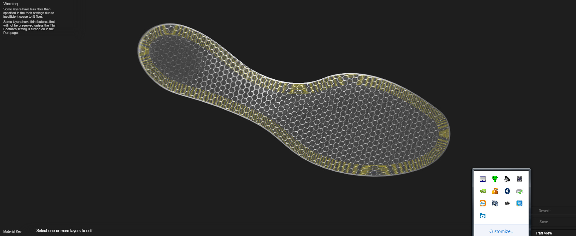

The Mark One uses one continuous strand of fiber to reinforce parts. If you look at the 2 pictures, #1 was where the software placed fiber (in yellow). Sliders at the bottom let you change the amount of fiber and which layers get reinforced. #2 is where I added more fiber to make a stronger part. I think the reason for the minimum sizes to add fiber is because the second extruder needs time to heat up, extrude fiber and stop. Small parts generally donât fit fiber easily but printing just nylon at 50% fill gets you pretty strong small parts.
