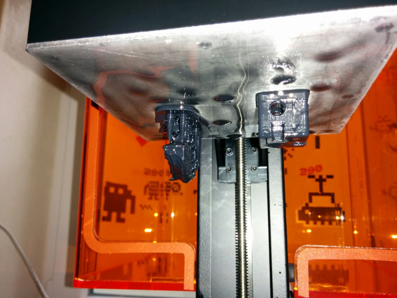

Florian, you need to rotate the part so that there are no big surfaces at the beginning of a print.
The principle how a Form 1 works is that the laser is curing the resin on the bottom surface of the tank.
The platform is peeling the layers away from that surface. So you can imagine that a bigger area at the beginning is more difficult to peel.
Just have a look to this tutorial http://formlabs.com/support/guide/prepare/model-orientation/

Your part orientation is all wrong and likely the only problem.
You cant print parallel to the build platform.
Angle everything!

Hey folks, tried different orrientations no luck at all…
Check:
-Scroll through the layers in preform, do they all look right? Sometimes bad STL’s can cause Preform to show the model, but it doesn’t slice it properly
-Check your tank bottom for clouding
-Do other models print fine?
-Upload your .form here and I have a look at it
The tank is new, first used with this model.
Other models are working fine.
I’ll check the STL as you said this evening/night. but Meshmixer didn’t found any issues.
I can’t upload it, since I don’t have the permission, sorry :frowning:
Well, the fact that the supports print so nice and you used a new tank and different resin at least tells you there is nothing wrong with the printer.
If you don’t find the problem and you can’t upload the model, post a screenshot of the cross section (layer) where the printing of the model starts failing.
PS: you shouldn’t place models on the build platform like that - even if they print, the strain on the mechanics and tank will be much higher than with supports.

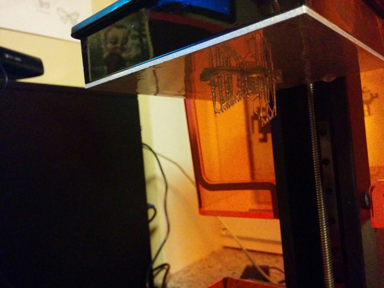

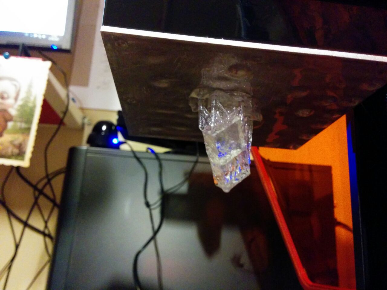

Hey guys, good news! Thanks to your feedback and support i managed to get the print rolling!
I have a question about what I see in the current images showing a completes print.
What is the Orange tape for? I’ve never used that before. If anything, my parts always seem very difficult to remov from the bare aluminum build platform.
Maybe its a bit confusing, sorry for that the second picture shows the print curing on a metal plate, which is a heated bed from a RepRap Mendel design of us and has nothing to do with the Form1 we just placed the part there. The orange tape is Kapton tape. It is used with FDM printers to get a better adhesion to the bed.
