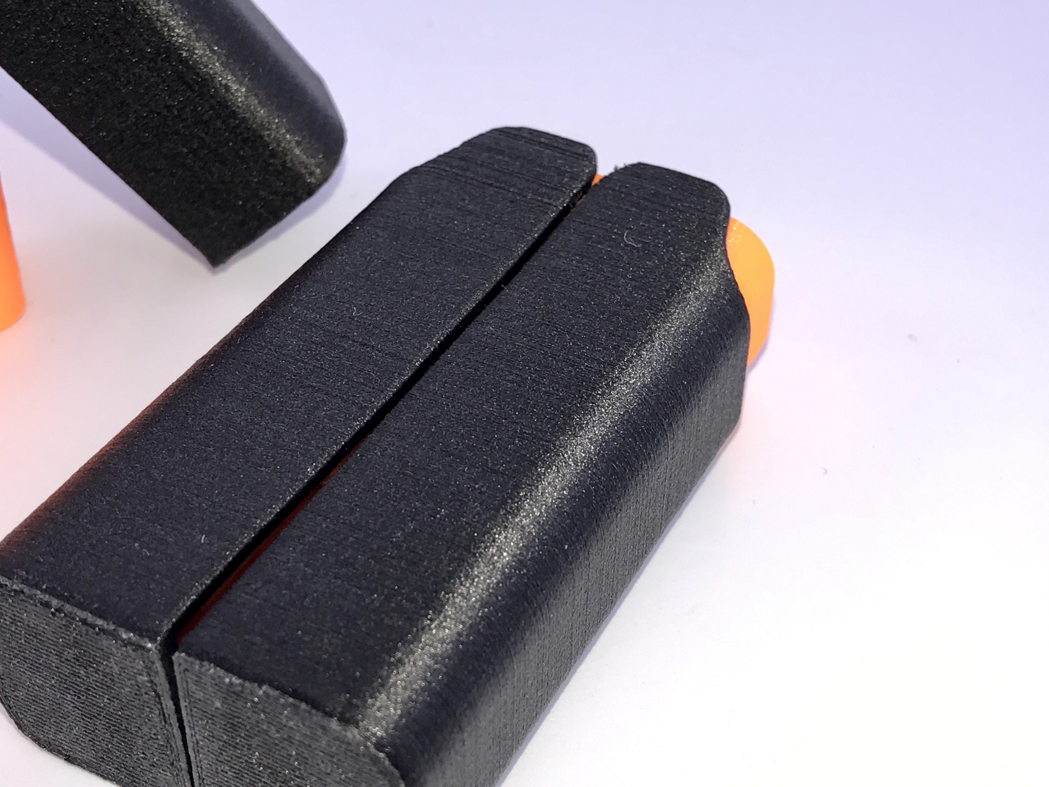

Attached are some headphone cases I printed in NylonX on the Markforged Mark One. The orange part is PLA and printed on a Makerbot. I have both Markforged Mark One’s and a Mark Two’s and use NylonX in both with zero issues. If by stringing you mean retraction strings, then yes some prints may leave more than others and there isn’t any adjustable retraction settings. I’ve printed rather large fins for my Oru Kayak as well, my largest issue for certain prints is bed adhesion. Hope this helps.

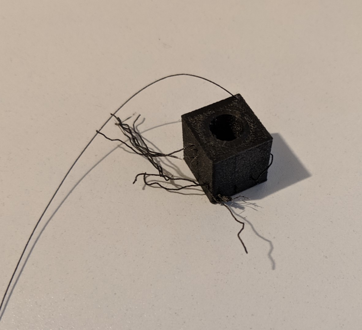

That’s some really nice outcomes. Here’s a picture of what I got when I tried to print a simple cube with NylonX on my Markforged Onyx One.
Obviously looks like garbage. I have a product that I can literally print off, but with the cost of Onyx Material it’s something I would like to drive down for sure. Not sure how I’m doing this different/wrong particularly when these printers don’t allow that much customization!
