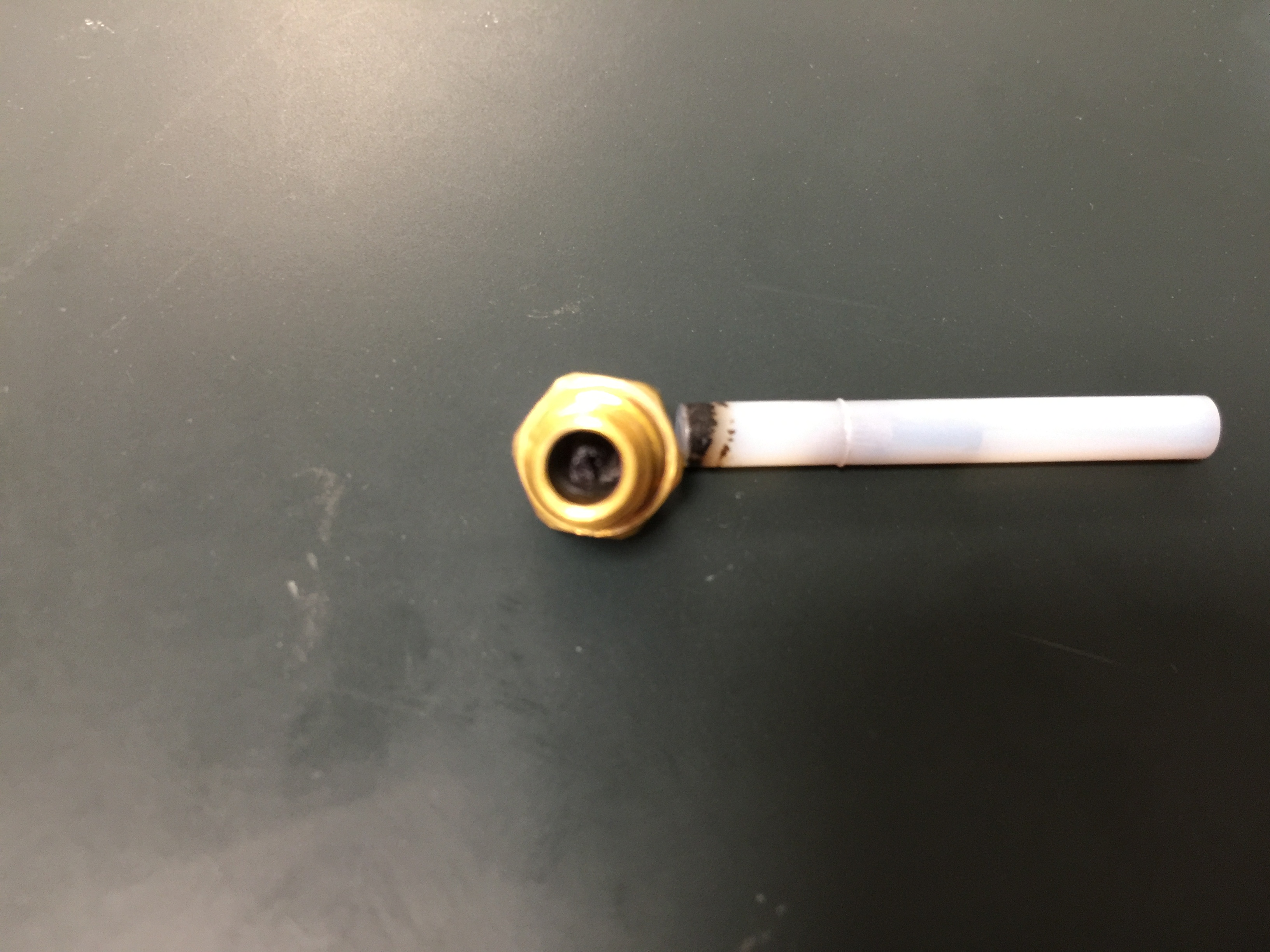

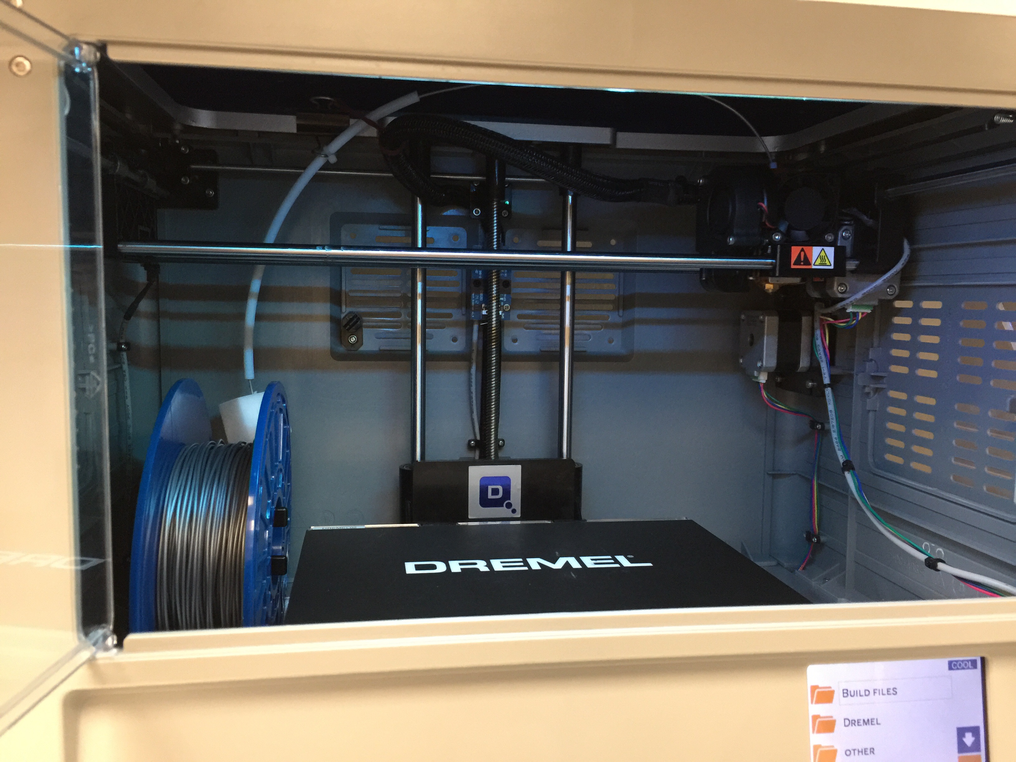

Try open the two screw at heatsink there and look inside extruded part maybe something blocking there. See picture. The second one maybe be ptfe tube meltdown in the nozzle. Just open the nozzle and check it out. Maybe it time to change new nozzle. Good Luck.

My extruder does not have that cool tube and mount. Did you make that?
The PTFE tube inside my extruder developed a hole at about 1000hrs of printing that started causing jams. Heat creeps up from the heater block and makes the filament soft before it should. You would have to disassemble the hotend almost completely to check this. I’d suggest a full metal hotend upgrade if you decide to take it apart. Another thing to check is the extruder gear teeth. Sometimes they chew up filament (especially when jamming) and fill in the teeth.

Yup. Simple design and upgrade. Save a lot of problem. Specially the dremel filament with rough that will grind the housing. I just cut the give ptfe tubing.

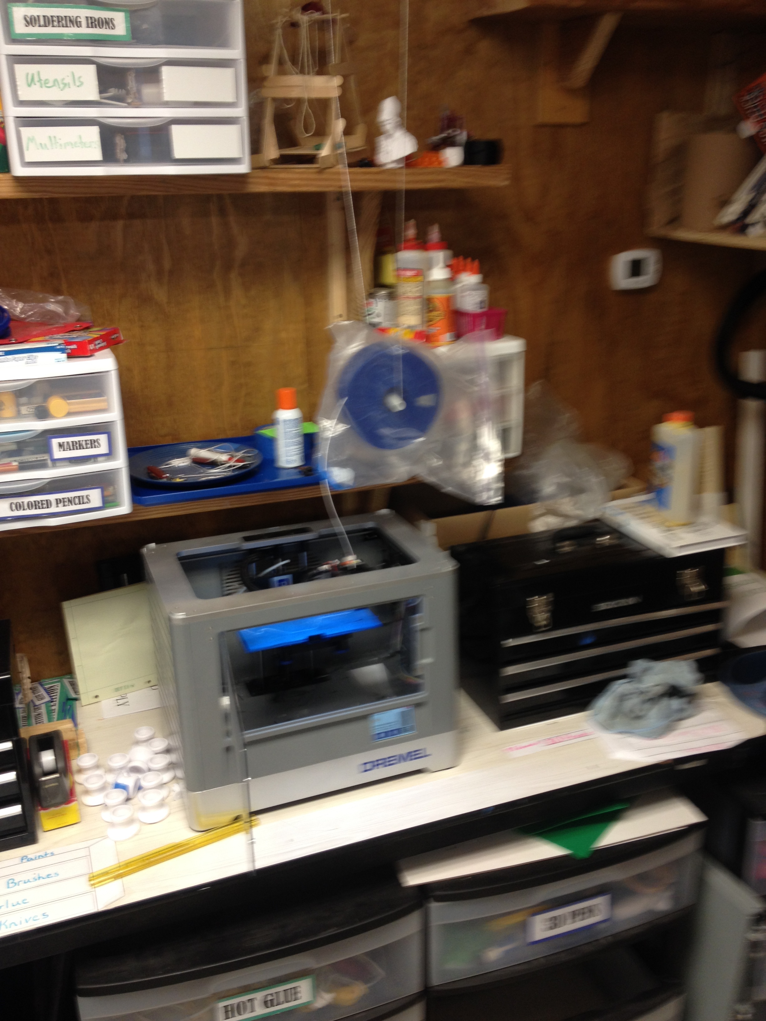

Cool! I may try that. I am also putting the filament out of te printer so that it doesn’t have to arc over and rub on everything. Going to hang the roll from the ceiling right over the machine.

My motto has become Looks Bad Works Good- this alone has given me some success, tomorrow I’ll get the sponge on there. I think I shall actually design and print a hanging box.
