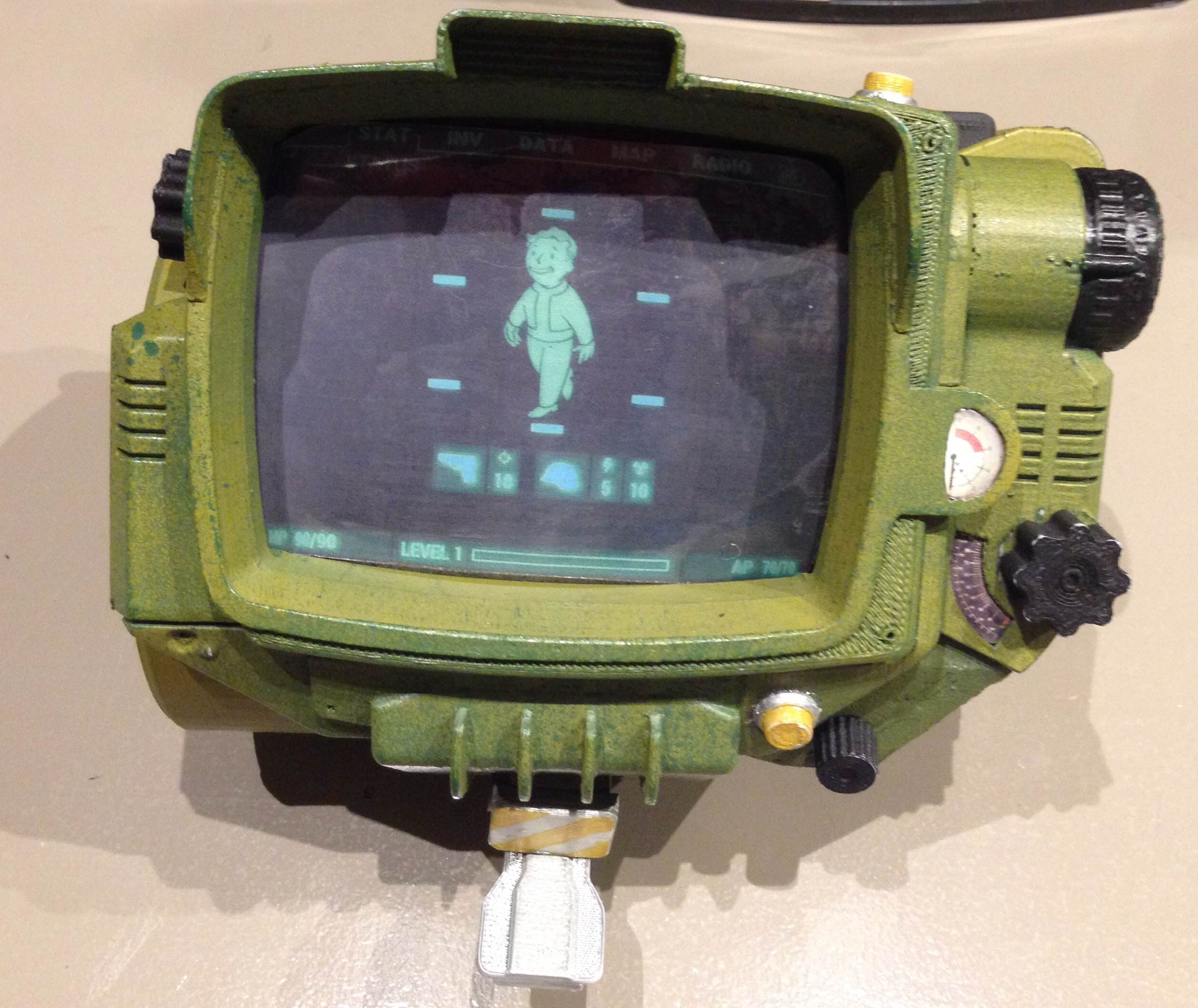

Having built one of these for a cosplay I put together for PAX Aus, I thought I would demonstrate how it turns out when its built following instructions instead of by the creator. It turned out quite well in time for the event, and a big thanks to Yven De Haas for how amazingly well these parts are designed (especially with limited reference)
Here are some pictures of it all assembled and painted, as well as a side by side of the pipboy edition for comparisons sake and the full cosplay. (as you can see it is slightly smaller than the official one) (The colour that Haas used was off the actual colour, so I went for a slightly different paint job. It’s still not exactly accurate, but it looks better IMO). Apologies for the bad lighting.
There are also some things I would note if you intend to make one of your own:
-Some of the screws are a pain in some of the smaller nooks and crannies (primary the latch mechanism and the cassete mechanism) - many of the parts will end up crooked.This isnt a huge deal though, as the latch functioned okay regardless.
-YOUR PHONE PROBABLY WILL NOT FIT PROPERLY - So don’t be surprised if it moves around a lot. I printed the 100% version on the basis my iphone 5 would fit, and it did, however it didn’t cover up the entire screen as it was a lot smaller than the space provided. In the end, I just printed out the screenshot and stuck some perspex on, which was easier and looked better.
-Keeping it on your wrist, if you intend to wear it, is very difficult. Because of its shape (the top end being a different width to the bottom), and depending on the size of your wrist, it will either be too tight, or slide around a lot, if not fall off. I had to put 2 layers of thick socks over my wrist to be able to fit it, even then had to constantly readjust it.
-You need the right screws, and don’t underestimate the difficulty of finding some of these smaller screws. I couldnt find any of these screws at my local hardware store and in the end had to go to a specialist screw store to find the right screws - and even then had to cut some down to size.
That said, if you intend it to be a display piece, then with the right paint job its quite the looker. Just don’t expect it to stay on your wrist all the time or to be a piece of cake to put together.
Despite all this I still think it turned out great and again big thanks for the parts.

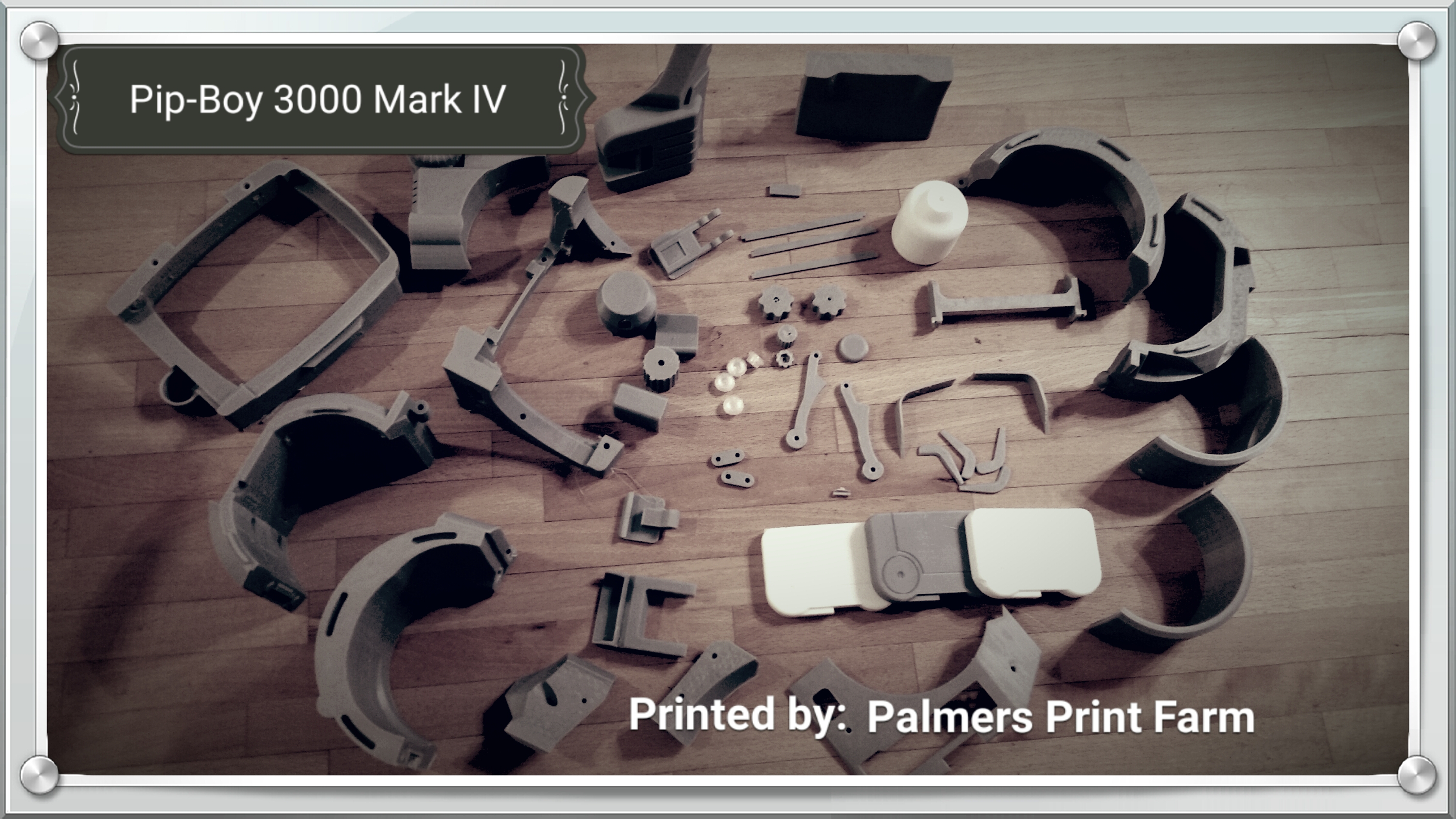

I was honored to print a complete set for a 3dhubs member. Here’s the completed pictures he sent me. Now my son wants one too. So, we’re working on round 2.
Yeah… That was fun to build.
Be careful when taking the order!!! This takes weeks to do right non-stop, and will tie up your printer the whole time with 8+ hr prints. While 1 or two orders is fine, think carefully about taking more if you plan to hub other orders. I just printed 3, it took 3 weeks to do that many parts. And yes, you will have misprints and need a lot of support material. 3Dhubs needs to account better for that, have a better pricing for taking this order ($100 +).

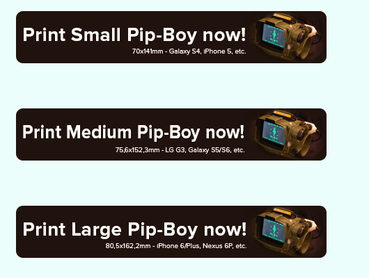

Does anybody know where I can get the files for the build? I have a hub on here and can print the parts myself
Hey @nt86, the files are attached in the thread above - see the Print Small, Medium and Large buttons above (I’ve attached the screen shot of them). Happy printing :wink:

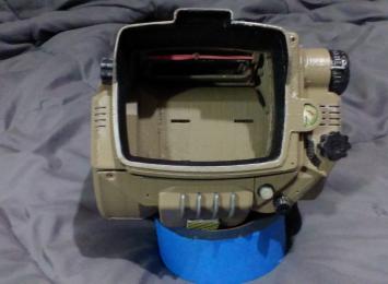

First build in progress, if it goes well I’ll consider selling it or making additional ones for sale
