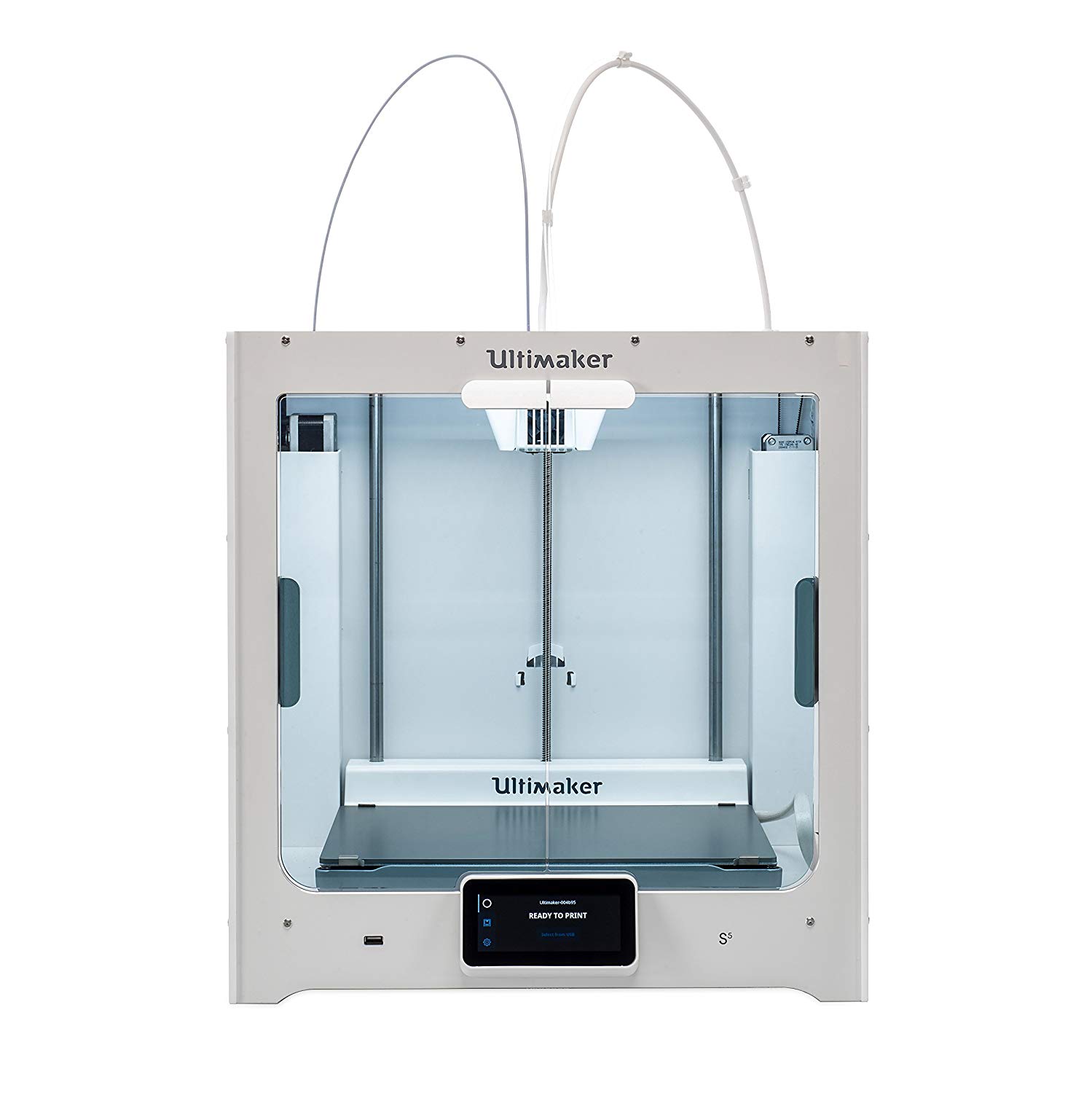

Ultimaker S5
The Ultimaker S5 is a desktop FFF/FDM 3D printer designed for the engineer who needs to be able to get his parts without getting his hands dirty. Its high price tag puts in the expensive side of the spectrum, but it is definitely justified. This printer is suitable for anyone who is looking for a machine that is efficient and intuitive and can produce reliably functional prototypes.
If you are looking for an elegantly designed office 3D printer for your business that can produce functional prototypes out of the box, the Ultimaker S5 is a great option. Its large build volume of 330 x 240 x 300 mm is perfect for large-scale prototypes or batch production of smaller parts. Its multi-material capabilities allow you to create parts with soluble supports and a surface finish comparable to an industrial system. Its active leveling technology compensates for any surface deviations leading to faster turnaround times.
As for materials, the Ultimaker offers a large variety of pre-tuned options suitable for most 3D applications, from prototyping to manufacturing functional parts. The S5 is also compatible with 3rd party materials, but users have reported that the quality achieved using non-Ultimaker materials was lower.
The Ultimaker S5 is controlled using a touch screen or through your laptop or phone using the open-source Cura software. The printer is connected to the internet through both a wired and wireless Ethernet interface. This allows multiple users to queue up prints and be notified when they are done.

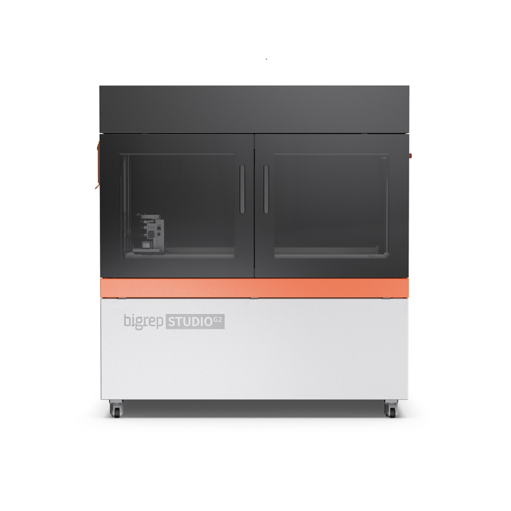

BigRep Studio G2
The Studio G2 is an industrial-grade FFF / FDM 3D printer with a massive build volume, finding applications in prototyping, tooling, casting, and large end-use parts. It is produced by the German manufacturer BigRep who specializes in large format 3D printing. The Studio G2 is the smallest system they offer, but it's compact design and emphasis on ergonomics make it ideal for use even in a non-industrial setting.
The build quality of the Studio G2 is what you'd expect from an industrial system. It comes equipped with two powerful extruder heads. By default, the extruders use a 0.6 mm nozzles design for high-resolution printing. These can be easily replaced with 1 mm or 2 mm nozzles to build large parts faster if required. The printer also has a fully enclosed print area and a print bed that can reach 100°C. These two features allow users to print large objects with both prototyping plastic (such as PLA or PETG) and engineering materials (such as nylon).
Speaking of materials, BigRep supplies 3D printing filaments that come in large spools of up to 8 kilograms in weight, which is convenient considering the amount of material this printer uses. The Studio G2 is also compatible with 3rd party filaments for those who want to experiment.
The Studio G2 comes equipped with the BigRep BLADE slicer, offering preset for all compatible materials. The platform is also compatible with 3rd party software, such as Simplify 3D.

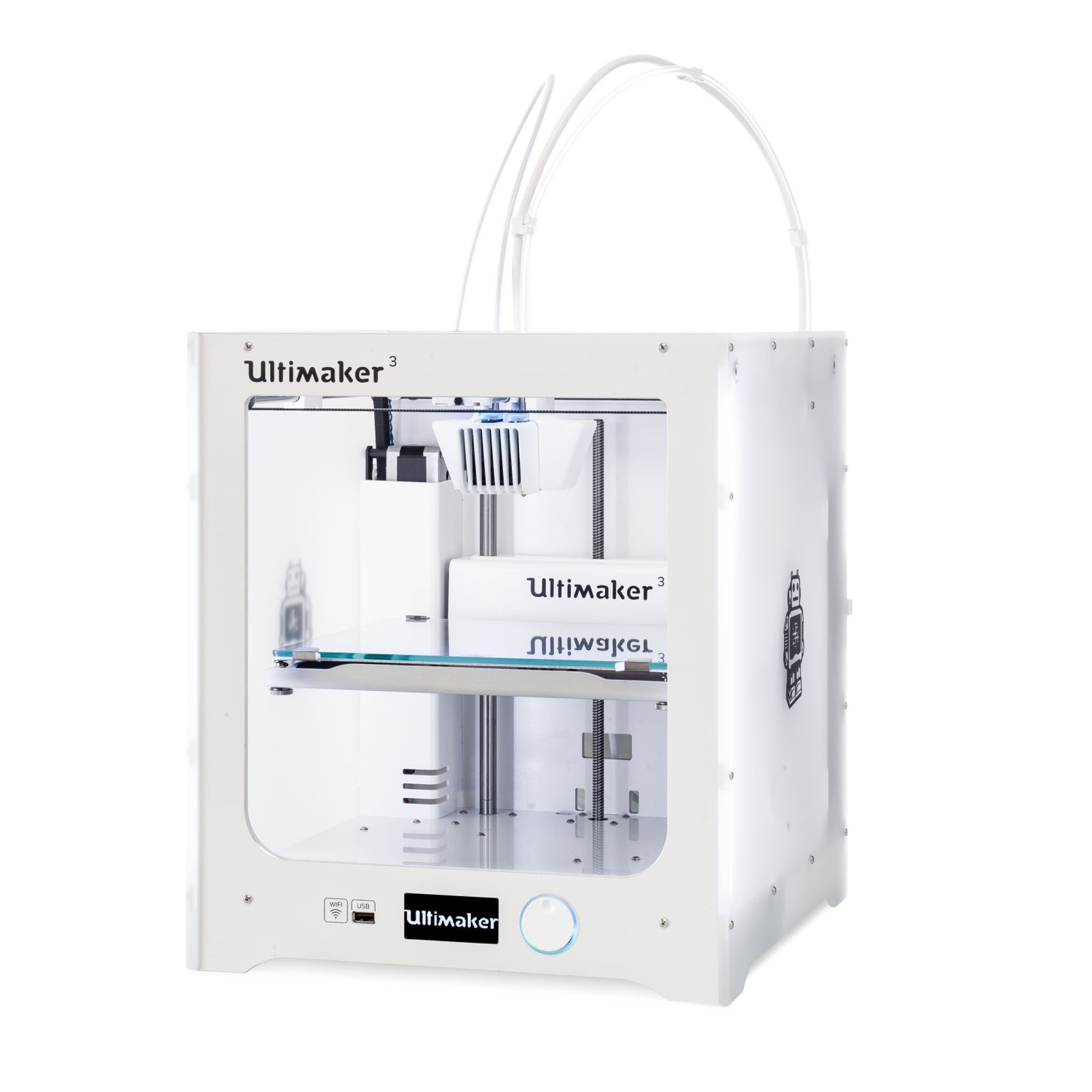

Ultimaker 3
The Ultimaker 3 is a desktop FFF / FDM 3D printer that is ideal for the classroom or anyone really who wants to design, click-and-print with ease. It produces high-quality prints time after time, and it comes equipped with Cura, an award-winning software platform that guides users through every step of the process. Ultimaker also offers a massive library of resources specially tailored for teachers and educators.
From a hardware perspective, the Ultimaker 3 uses swappable print cores optimized for build or soluble support materials. Dual-extrusion and soluble supports unlock the ability to print geometries that are not possible on a single extrusion system. Combine this with the auto-bed leveling, the Ultimaker 3 is a very reliable printer capable of running print after print with little to no maintenance. When maintenance is required, the Ultimaker guides and customer support, not to mention the vast Ultimaker community gets users printing again as soon as possible.
Using Ultimakers' free Cura software users can slice models using optimized material profiles. You can also send files to print wirelessly over WiF, which is very convenient for a crowded school or university workshop. Users can even watch their print live from the Cura software using the built-in camera.
Ultimaker 3 can print with a large variety of materials, provided either from Ultimaker and also 3rd parties. The open materials platform gives you (and your students) the freedom to experiment with different types of materials, from prototyping plastics to higher-strength engineering plastics. On the other hand, its open enclosure gives access to the printer during operation, which means that it might not be best suited for younger audiences.

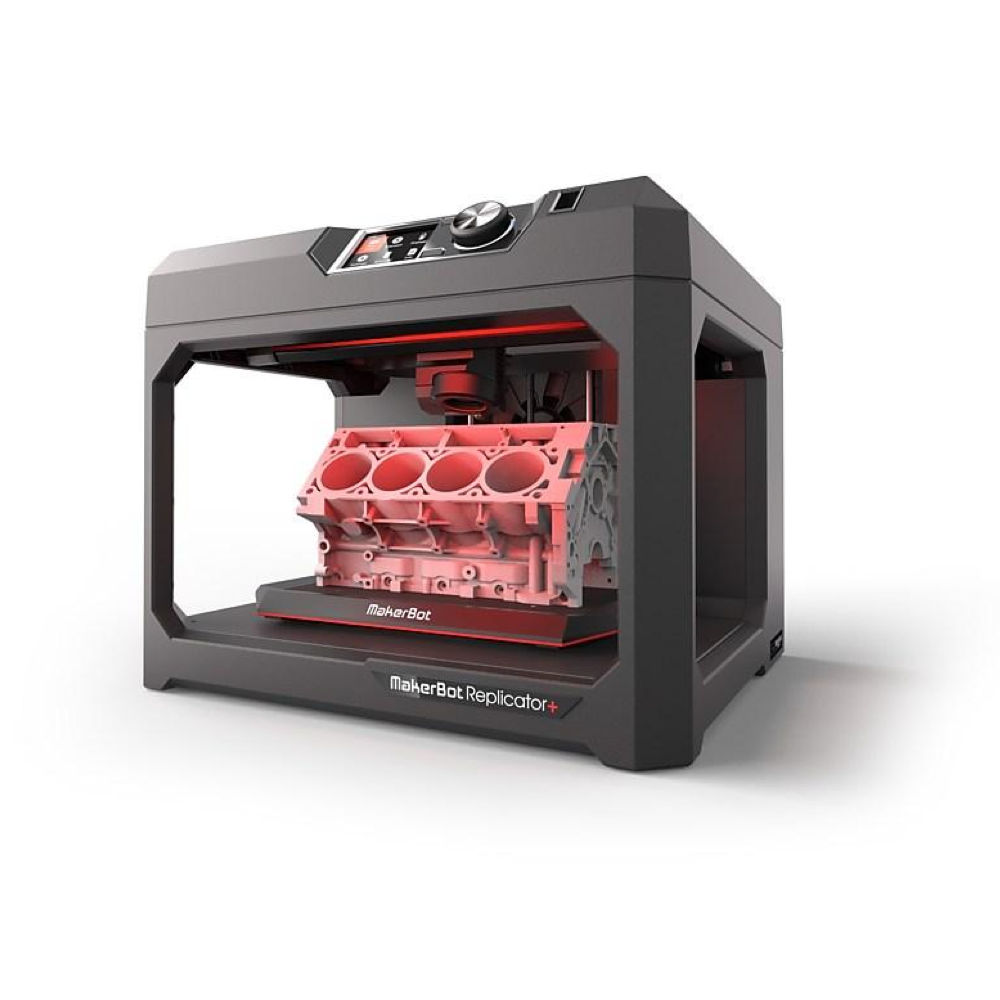

Makerbot Replicator Plus
The Makerbot Replicator+ is a desktop FFF/FDM 3D printing system that is designed with educators in mind. In fact, Makerbot offers special educational packages that include lesson plans and certification programs for teachers and students.
The build quality of the Replicator+ has received mixed reviews. The printer has a stiff frame with linear guides and a flexible platform and produces parts with quality that varies from good to excellent. It also includes an onboard camera and an LCD that allow you to monitor and control the printers with ease. Makerbot claims that their hardware is tested for 380,000+ hours of use, which is impressive.
However, Replicator+ does not have a heated bed, and it is not compatible with 3rd party materials. This means that you are essentially limited in printing with Makerbot PLA only. Moreover, the Makerbot Print Software is easy to use and intuitive, but it does not offer great flexibility in terms of print settings and customization. But this might be a feature in an educational environment where you want to focus on design, and you are looking for a machine that just prints with the press of a few buttons.
